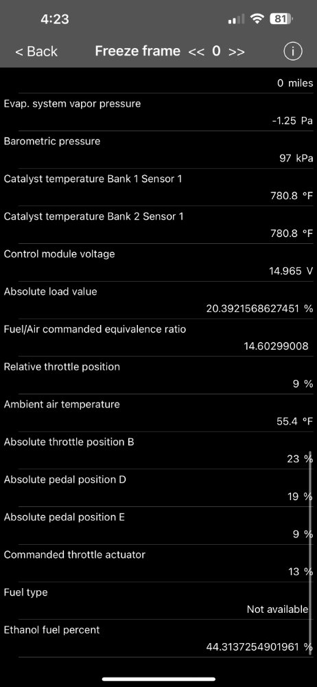

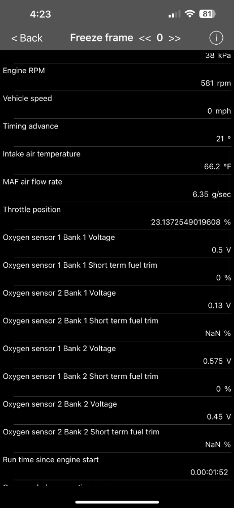

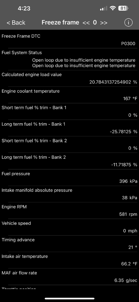

getting the following codes. Checked all voltages and all checked ok, no vacum found did water test, all injector read 13ohms, wiring looks ok, put in set of new ac delco 02sensors. Could i have bad injectors and or a bad ECM? also sometimes it will idle rough the abs light will come and the will idle fine ?? or give me an idea where to narrow down too ? also check wiring harness not issues there, i also checked ground and power no issues found. I also ohm out 02 sensor reading 06 to 12 ohms

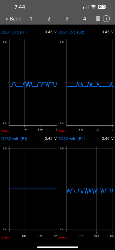

I also unplugged all 02 sensors and from watching scanner danner , I would say wiring down to o2 are good including ecm

So you unplugged the oxygen sensors. Is it safe to say that on scan data the oxygen sensor data went to 450mv? I assume that's the test you were doing?
If you clear the codes, what comes back first?
I was assuming the heater circuit codes since they weren't first on the list. If that is the case, then the heater circuit needs to be diagnosed first before any of the range or performance codes.

I apologize it has taken a moment to get back. I changed the 02 sensors all codes gone now with the exception of a 219A code

with o2 s that dirty would check s/ plugs , injectors , and fuel system, evap, and as Boswell 27 or 28 mentioned vacum leaks , Good luck
