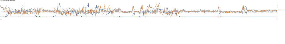

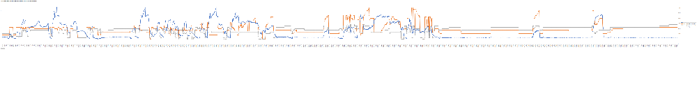

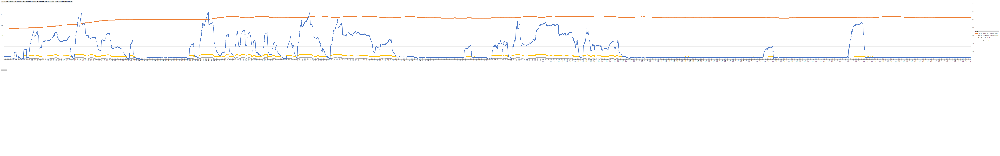

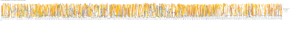

I have a 2002 GMC Savana 3500 15-passenger van with a 5.7L Vortec motor in it. The motor is a Jasper rebuild that was installed May 2023 with most components and hardware transferred from the dead motor (only the water pump, distributor cap and rotor, plugs, plug wires, and starter were replaced with new components). Van has about 145000 miles on it. Here are my problems:
As van warms up, engine starts to miss at higher RPM and the "SERVICE ENGINE SOON" light starts flashing the misfire warning.
After van is parked and motor is shut off for 10 minutes to about an hour, the van is very hard to start. I have to crank the van on-and-off for about 5 minutes before it starts, and then it runs rough for a few minutes after starting. During this hard start, the motor seems to try and fire, but it kicks and stalls the starter motor periodically while cranking the van.
What I've tested so far:
I have attached the CSV file of data trends and a few pictures. I have the file loaded in Excel as a Pivot table, so if anyone wants to look at anything I don't have posted as a picture I can get it graphed and posted.
- Collected OBD2 trend data from all available van sensors and some phone sensors from the Torque app

For some reason the PNG charts are really small in my post and can't be magnified, so here's a zip file with the full-size PNG charts, just minus the O2 chart since that's the biggest file.
