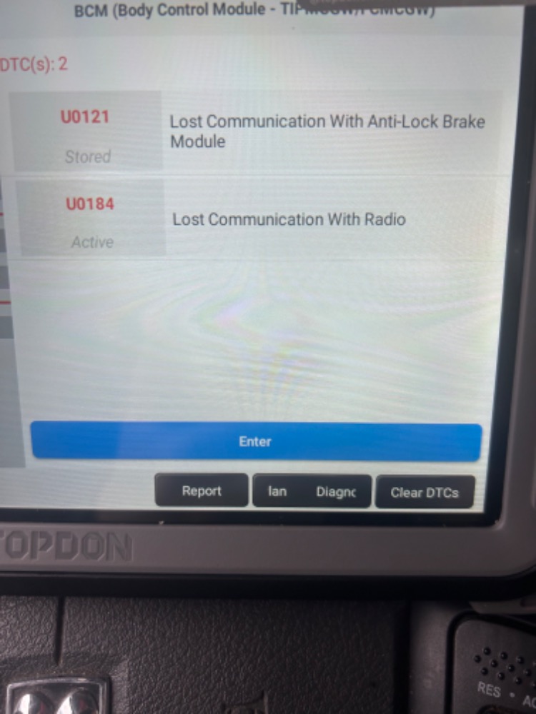

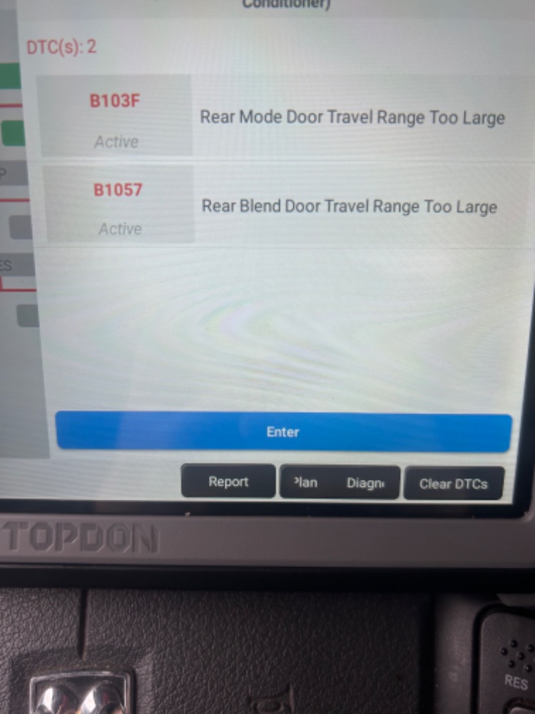

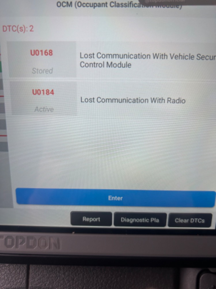

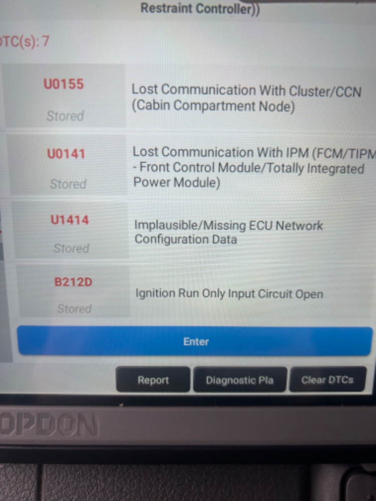

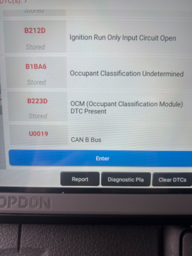

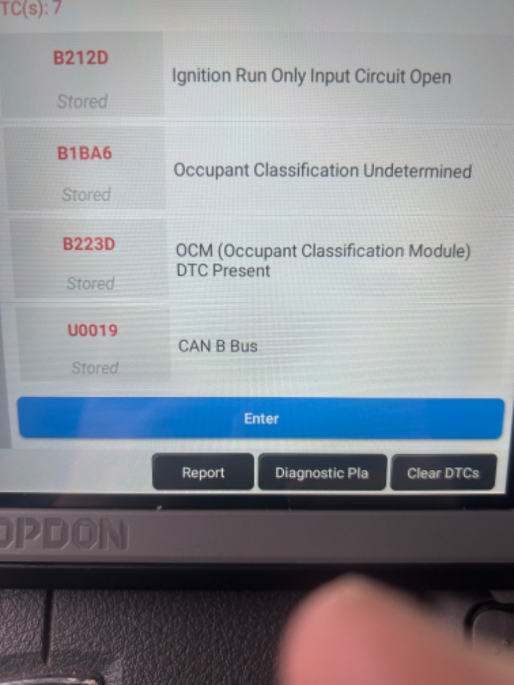

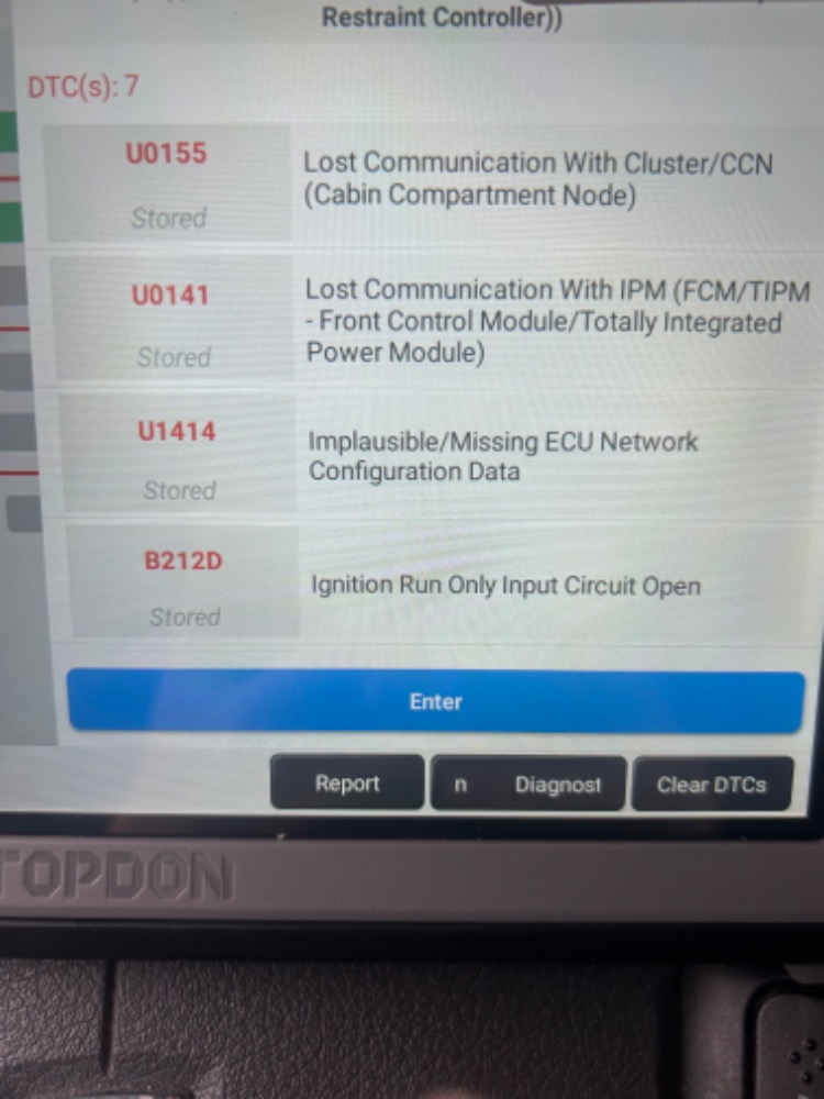

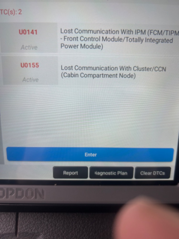

I have so so much wrong I don’t know where to start. 2004 dodge Durango. 4.7. I took a few screenshots. What should my next step be? Here’s a few snapshots. I had two more but the limit is 8.

Don't go nuts trying to chase all those codes unless they all come back immediately after clearing them, and have related, tangible symptoms.
It's not uncommon to have codes stored in modules that don't have any problems.
Clear all the codes and focus on the system that's giving you trouble. Don't get bogged down in the code swamp.
