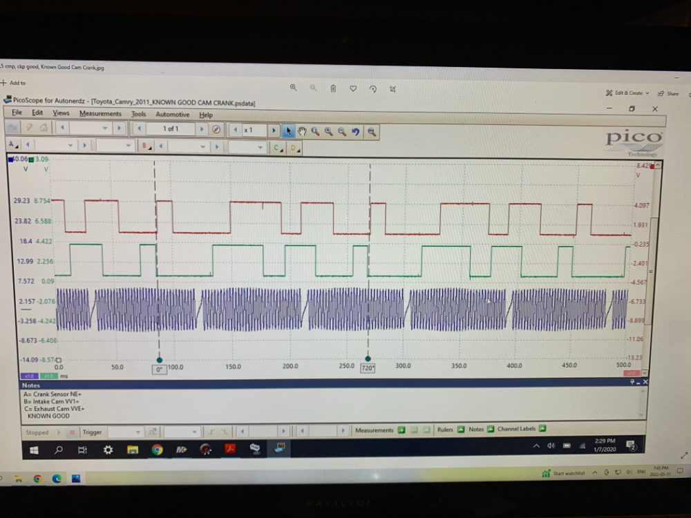

So a couple of things to go with the performance timing codes:
- VVTS faulty
-Oil Control Solenoids faulty
-Not enough Oil pressure at Oil Solenoids to operate VVT properly
-Timing chains is out of time
With proper tooling VVT can be checked against desired positions and actual positions
The Chain timing can be compared to a known good Correlation which I am providing.
Known Good;
Also, here is an excellent video from Ivan at Pine Hollow Auto Diagnostics showing what is necessary to prove problems like this out.

2 years 10 months ago #63595 by Stevie15
Replied by Stevie15 on topic Intermittent stalling
Thank you very much for your help , I will try to do what Ivan did to see if that will fix my issue. Happy thanksgiving may God bless you.
