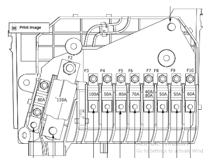

2 years 1 month ago - 2 years 1 month ago #63547 by Rachelre39
2015 Ford Transit Connect XLT Eco Boost 1.6 litre..
The battery died because seat warmer was left plugged in.
Used 48 volt scooter battery to charge the 12v. The area by the fuse box under the dash and/or radio puffed smoke and upon examination many fuses were blown.  Before the car stopped cranking and starting the driver side window went down by itself and it wont go up. I also blew up the battery so i bought a new one after i got paid along with fuses.  The drivers side window still wont go up the car will not start or crank power and lights work. It is not a relay or fuse that I can tell as I conducted continuity tests.  My dad said something about a fusable link...
i was hoping someone could poiny me in right direction need car to get to work..
the radio and drivers side window does not work the car wont crank wont start but the passenger drivers side window does work..
please advise

2 years 1 month ago #63550 by Tyler
Replied by Tyler on topic No start or crank mystery
Rachel, are you in the US, or overseas? Need to know for potential wiring differences between US market and others.
I see that you've already replaced some fuses, and tested others, but I'd still say a good first step is to start over at the battery and work your way down. Continuity is good, but what we really need is voltage testing. Start at the high current battery junction box and then move to the battery junction box:
We want to know which fuses have power on both sides (good), which fuses have power on one side (blown) and which fuses don't have power on either side (might be OK, might be a problem).

2 years 1 month ago #63556 by Rachelre39
Replied by Rachelre39 on topic No start or crank mystery
All the fuses and relays are good the ones that got cooked I replaced.
The radio and drivers side window does not work or power on, no crank, no start but the lights come on the passenger side window works. I think the computer may be the problem. Where is the computer on this car? It is a 1.6 liter ecoboost ford transit connect 2015.
How do i test the computer is the computer the same as the PCM.
What about the ECM?
Please advise i thought i would have figured it out by now and i need to get to work. I am so upset...

2 years 1 month ago #63619 by stevieturbo
Replied by stevieturbo on topic No start or crank mystery
They are not something you can easily DIY test.
If you have a scan tool, and you can get some information from the ecu, that would be considered a "test" though.
However as you say you have no ecu comms, and other modules reporting problems, that is a very bad sign
You need to test if the ecu has power....12v of course, absolutely not ever ever ever 48v.
If it has power and your scan tool still has no comms....it's very possible the ecu is dead, along with other modules in the car.
With key on, you could test at a few of the engine 3 wire sensors to see if you're getting a 5v ref supply at any of them. That would also give some indication if the ecu has any life in it at all.
