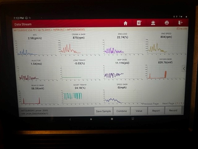

Short term fuel trim stays around 24% for the most part (see screenshot from the launch), Long term has been staying -0.03%, O2 sensor bank 1 reads around 0 a lot of the time and bank 2 reads 0 a lot of the time also, i can raise the O2 sensor by spraying starting fluid into the intake while the car is running.

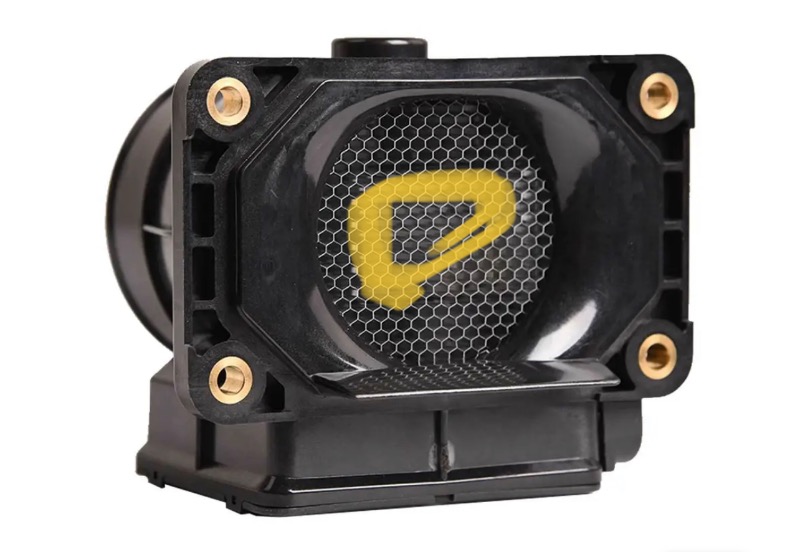

Cleaned MAF with the proper cleaner, sprayed carb cleaner it all around the intake and nothing made the car surge or raise the o2 readings (no air leak after the MAF I could find)
