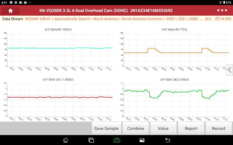

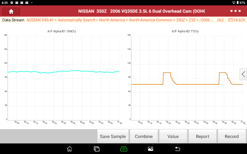

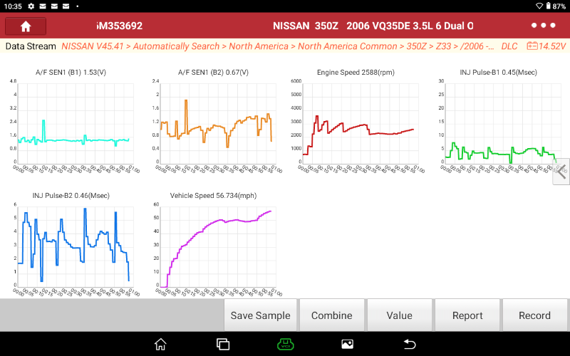

2 years 11 months ago #63285 by Kaleb
Replied by Kaleb on topic P0300 Code
  So with the help of a buddy we ran some tests with a really nice scanner. Was watching some of the maps (as shown in pics attached) and noticed that bank 2s readings were way different from bank one so figured we’d narrowed it down to a problem in bank 2. Ended up plugging a seperate scanner into it and the oddest thing happened. Was messing around with some menus and found out I could mess with fuel injection. As soon as I selected it the misfire stopped (mind you I had not messed with the fuel inject but had just started the test) went for a few drives and it drive smooth as ever. So I think we’ve ruled out everything exept for the tune. I ran this revision of my tune for about a month before the misfire started but I’ve heard of a tune “going bad” or the rom file “getting scrambled” let me know what you think. Will be talking to my tuner tomarrow to see what they think aswell as getting another revision. Also we pulled the plugs and non were wet and all looked to be perfectly fine. Attached are screenshots of some data captured. Some at idle and some under load. The ones under load have engine speed as one of the graphs. Thank again!
2 years 11 months ago #63289 by Tyler
Replied by Tyler on topic P0300 Code
It looks to me like the bank two air/fuel sensor is struggling. Bank one is spending most of its time around 1.5V like it should. Values less than 1.5V are rich, which causes the Alpha values to take fuel away.
The fact that the engine ran better during the functional test would suggest that it's actually a false rich condition. In other words, the ECM is taking fuel away from bank two when it shouldn't, causing a misfire.
I don't squat about Nissan tuning, but it's my suspicion that you're seeing a feedback problem and not a tune problem. Either the bank two upstream is lying, or the bank two downstream is stuck rich.
2 years 11 months ago #63295 by Kaleb
So I never mentioned but I have long tube headers on the car and I was told I only needed primary O2 sensors so I have no secondaries. Aswell as I didn’t know I need extended O2s so each side has two regular O2s spliced together. You are talking about the O2 sensors correct? Also uploaded a new tune last night and it didn’t help but running the actuation test still makes the car run fine. Thank you.
2 years 10 months ago - 2 years 10 months ago #63842 by Lvumlow
Replied by Lvumlow on topic P0300 Code
Well, We performed a few more tests and came to the same conclusion so we purchased a new Bank 1 upstream A/F sensor and that solved the problem (we replaced Bank 2 first but that did not change anything so we moved it over to Bank 1 and that did the trick).  My only guess relating to the behaviour of intiating the "Fuel Injection Actuator" test is that once you enter that mode the system must ignore the A/F sensor so you can make manual adjustments.  Anyway, I have seen a ton of web inquiries about a random mis-fires so this is one of those examples of an upstream sensor that is working enough to give you bad data.  I was not able to test the wiring becuase this sensor had the wires extended to reach the long tube headers but we could see a ton of black soot on it so it was obvious something was going on with that side.
Thanks again for the feedback and help.  I have looked through a multitude of videos relating to testing wide band sensors and I was unable to make an sense other than to induce an artificial rich/lean condition to see what the computer did with it so does can anyone link a good video on the best way to conclusively test a wideband A/F sensor?
At least the car is back to normal and I am sure he is thrilled considering he has been battling this for the last 3 months (I know the feeling; my Q60 RS was down with a problem nobody could fix for months as well and it sucks).  He was getting all types of feedback to change plugs, coil packs, injectors, etc...  I'm glad he has his car back.
