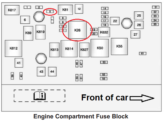

After searching on the internet, a common cause was bad grounds. So I spent the day finding all grounds in the engine compartment (using a downloaded PDF Service Manual as reference), removing and cleaning them and then reassembling. Didn't help.

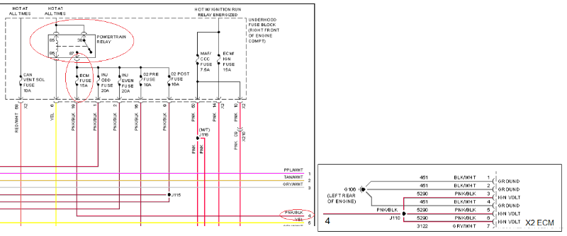

Then I moved to fuses. Sure enough, I found the #5 fuse, a 15A fuse for the ECM, was blown. When I replaced it, I noticed the check engine light was no longer flashing. And my fuel gauge was back! Turned the key to the Start position and it cranked! However, it would NOT start. Bummer. Checked the fuse. Blown again.

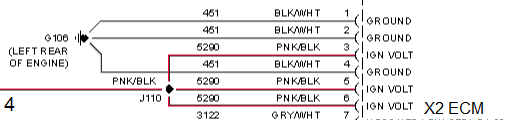

The wiring diagram for this fuse doesn't show much. Hot power goes from the POWERTRAIN RELAY, through the fuse and then splits into 3 (junction J110) and become Pins 3, 5 and 6 of the ECM (labeled IGN VOLT, page 340 of service manual) X2 connector (58 pin connector). Pins 1,2,4 are ground.
When I remove the X2 58-pin large connector of the ECM, the fuse does not blow. The X1 98-pin connector is still attached.
With everything back together and the fuse blown, whenever I open the driver door, I guess the car wakes up and I hear a 2-3 second series of 10-15 clicks from the fuse box in the engine compartment. However, when the fuse is new and good, I only get a single click. I think I found that the clicking was due to the POWERTRAIN RELAY, (K26). Whenever I remove it, no clicking.
  • With the #5 ECM Main fuse blown, relay K26 ticks quickly several times when door is opened (car "waking up"?).

If the diagram you posted is not omitting anything, then it appears as that fuse feeds the PCM with nonstops in between.
Because it branches intoultiple circuits, makes me think the circuit is not purely for powering on the computer, but is probably distributed by the PCM for outputs (just my initial thought, I've been wrong before), so disconnectimg the PCM doesn't necessarily eliminate an output in my eyes just yet.

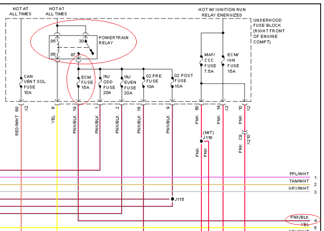

3 years 3 hours ago #63236 by Gunn
Spent an hour or two tonight and have a little more info to eliminate some areas, but still have not found the problem.
So I concentrated on the diagram attached and the Powertrain Relay, the 15A ECM fuse that keeps blowing, and the wiring to the ECM. The PNK/BLK wire eventually splits into 3 PNK/BLK wires and go into Pins 3, 5, 6 of the X2 Connector on the ECM.
I wanted to test if the wiring from the fuse box to the ECM connector had the short or not. I kinda was hoping it di as it's pretty short and right in the area of the fusebox in the engine compartment. But I couldn't energize the Powertrain relay without the fuse blowing.
I removed the X2 connector from the ECM. And I removed the relay and verified I had 12V battery power on 30 and 85 of the relay connectors in the fuse box. I then put in a jumper wire from 30 to 87. When I did this, the "left" leg (towards rear of car as looking from passenger fender) of the ECM fuse had 12V power. Cool, now I could check that harness to the ECM pins.
I checked for a short in that harness using an ohmmeter but didn't detect anything (as I learned how to do from ScannerDanner Youtube videos!). So then I put in a new 15A fuse and crossed my fingers (actually hoping it would blow!). It didn't. It was fine. I then measured 12V power on pins 3, 5, 6 of the ECM x2 connector. I also checked for ground on pins 1,2 and 4 which did have a good ground. So those first 6 pins are all fine.
So that means the harness pertaining to that ECM fuse from battery, through fuse box, to the ECM is just fine.

2 years 11 months ago - 2 years 11 months ago #63240 by 70monte
In order to power up the relay that controls that fuse and to cause it to blow, pin 86 of the relay has to be grounded. The relay is powered all of the time through pins 30 and 85. Your wiring diagram doesn't show what is grounding the relay on pin 86. I'm assuming it's probably going to be the ECM.
If your diagram is accurate and nothing else is on that circuit, there has to be a short to ground on the wiring from the battery to the relay, from the relay to the ECM, or an internal short in the ECM itself.
It doesn't really make sense that opening the door would ground pin 86 of the relay and give that entire circuit power so that the short occurs.  I would think that opening the door would wake up the BCM instead of the ECM.  I guess waking up the BCM could also wake up the ECM and if the ECM is shorted internally, it could then provide the ground to pin 86 of the relay and power up that circuit and then short it out.  I guess it's hard to tell unless you know how that whole system works.

Yes, you are right. Pin 85 and Pin 30 of the relay do show a good battery voltage, so all is good upstream to the battery at that point.
Ping 85 (yellow wire out of fuse box) goes to pin 58 of the ECM, the last pin on the X2 connector.

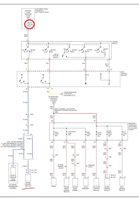

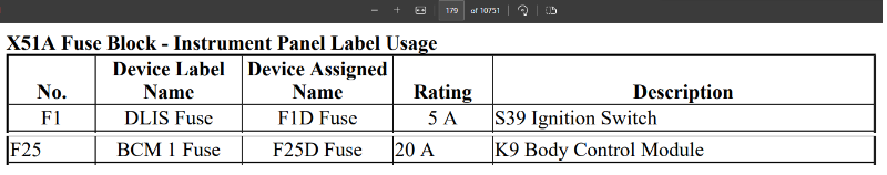

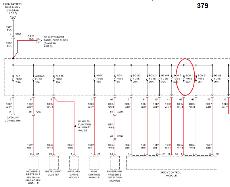

When I got to the very last one, F1 DLIS fuse ("Discrete Logic Ignition Switch"), a 5A fuse, boom! It blew again. I removed ALL of the fuses again, replaced the ECM fuse that blew in the engine compartment and then just added F1. Boom, it blew.
Bottom line, if ALL fuses are out and I add EITHER F1 DLIS or F25 BCM1, the ECM fuse blows.
I came back in, poured over the wiring diagrams but really couldn't find any real link. Obviously, either of these two fuses is triggering the ECM to ground out pin 86 on the powertrain relay (yellow wire, pin 58 of the ECM X2 connector) on the trigger side, which then tries to energize the load side containing the ECM fuse, which is then shorting out to ground. So I don't know how much help this is, since my issue must still be in that load side, of which the wiring diagrams show the wires ending up in the ECM (and I've proven the harness from fuse box to ECM is good for these wires in my previous post).
Attached are some wiring diagrams I found of these two fuses. I can't see anything helpful. I hope someone else can!

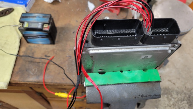

2 years 11 months ago - 2 years 11 months ago #63344 by Gunn
FINALLY, Progress!!
As I mentioned previously I removed the ECM and took it to the workbench. I created a small power wiring harness with three wires to apply +12V power to the power pins (3, 5, 6) and three wires to apply ground to the ground pins (1, 2, 4) in the X2 ECM connector. Small crimp spade terminals that I had to pry open just a bit worked perfectly on the ECM terminals.
I added an inline fuse holder and a 15A fuse. Sure enough the second I touched the positive wire to the red terminal of the 12V battery, I heard a faint click in the ECM and then the fuse promptly blew! I tried it again for good measure; same result.
So now I have definitively proven the ECM is responsible for the short-to-ground within it. I had already proven the wiring harness for these 3 positive PNK/BLK wires from the load side of the fuse to the ECM pins was good with no shorts.
I have the ECM boxed up and ready to ship today to Module Experts. They'll do a lifetime warranty repair with a three business day turnaround. With my shipping cost to them included, it's just a bit under $200 total.
I'm sure I'll still be anxiety-ridden when I plug it back into the car, but I feel pretty confident I've found the problem...one of the lucky (unlucky?) ones with an actual ECM problem! Trust the wiring diagram. It showed me the complete circuit I was dealing with.
Thanks for the tips, help and suggestions, I'll update as soon as I get the ECM back and see what happens.
