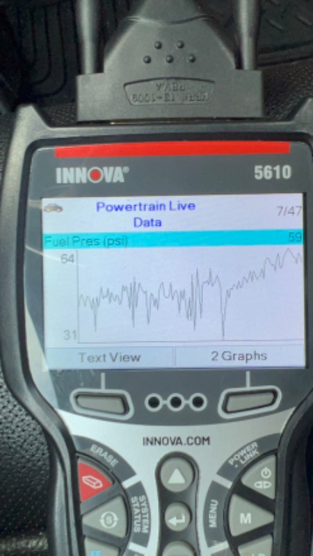

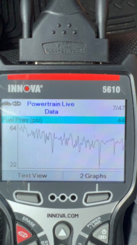

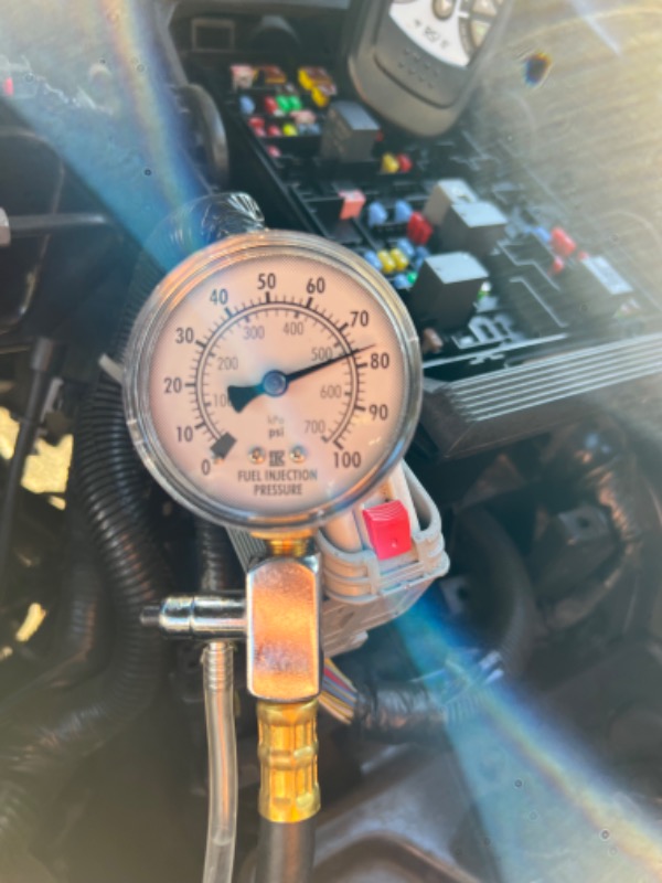

Can anyone tell me what’s wrong with my fuel pressure? 2018 5.3 65k with high and low fuel pressure pump. I have rough idle and poor gas mileage. After I shut the engine off the pressure rises up to 80psi. Thanks

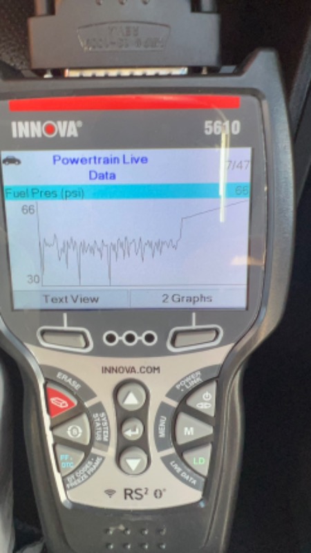

No codes but I found intermittent random misfire on all cylinders . I hookup a fuel pressure gauge to the fuel line and the needle is erratic bouncing around. Same with my live data.

Large fluctuations in the low side can be common on GDI systems, as the low side is part of the return system for the high side. Unless you're seeing fuel pressure performance codes, I don't know that I'd sweat it.
For your rough idle, I'd be more interested in the specific misfire counts in Mode $06.

Pressure in the hp rail going up after shutting down the engine is a normal condition. It happens because the fuel getting "heat choked" and the resulting thermal expansion.
Indeed this serves as test for leaks within the hp system: if the pressure does not rise an injector or the hp pump itself may be leaking.
