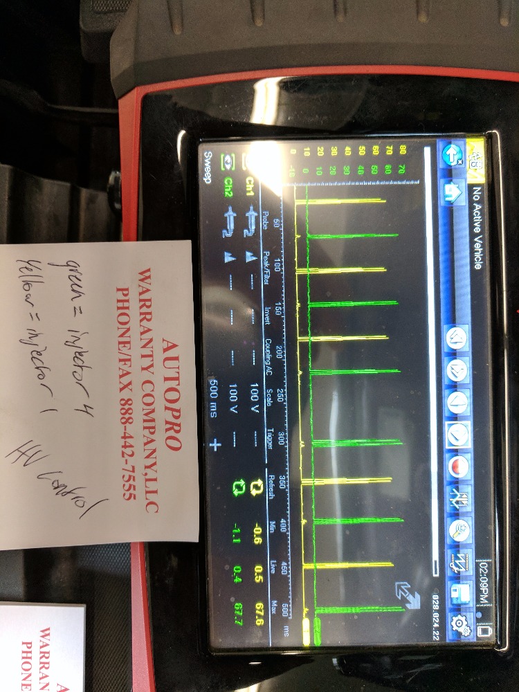

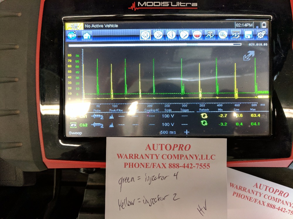

I may have found something to point us in a direction. The following pictures (sorry my modis didnt wanna upload..) are graphs of the injectors. When the symptom occurs I have noticed that injector 1 seems to be missing.
The picture with the note HV,
Green is circuit 4904 Direct Fuel Injector High Voltage Cylinder 4
Yellow is circuit 4901 Direct Fuel Injector High Voltage Cylinder 1
Note labeled HV Control is backprobed at the same connector
Green is circuit 4804 Direct Fuel Injector Control Cylinder 4
Yellow is circuit 4801 Direct Fuel Injector Control Cylinder 1

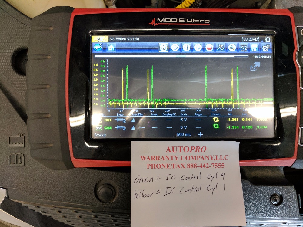

9 years 4 months ago - 9 years 4 months ago #10556 by RCPro
Replied by RCPro on topic 2009 GMC Acadia 3.6; Engine stall
Finally the coil trigger backprobed at the ECM
Green is circuit 2124 IC Control Cylinder 4
Yellow is circuit 2121 IC Control Cylinder 1

Nice captures. B) In that last capture, it appears that #4 got skipped once, and #1 got skipped twice? It's like the PCM just gave up control momentarily...

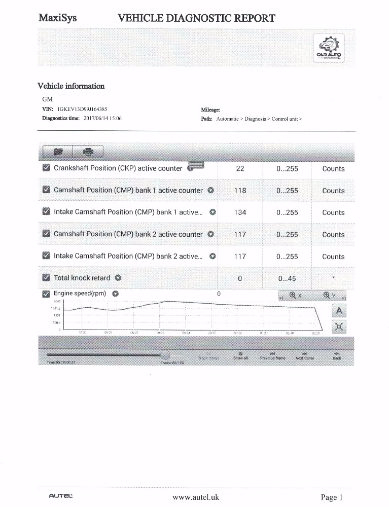

I did all the guided test on my Modis with all four cam position sensors and cam actuators just for something to do I guess.
