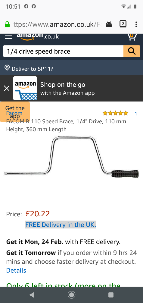

When taking bolts out an impact is less likely to shear a bolt than a lot of force on a short bar. When tightening I always run bolts in by hand, then a small battery impact or power ratchet the tighten using the appropriate hand tool. For spark plus depending on access tend to enter them by hand using a socket extension as a hand driver or a speed brace then hand torque. With spark plugs use a magnetic socket never the type with a rubber insert.
If assembling an engine the speed brace is again my tool of choice before torquing, especially for fitting cam carriers and covers and oil pans .

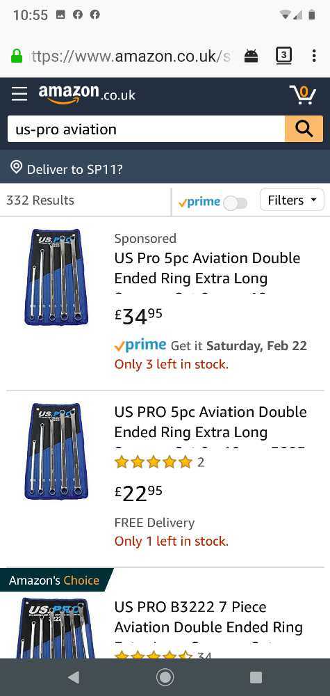

Yup spanners are made the correct length to suit the required tighten torque for. The bolt size.
But must confess I now have a set of US-Pro extra long aviation wrenches that now have become my tool of choice for a lot of jobs.
