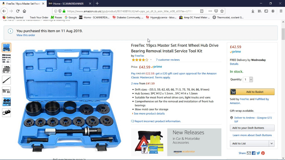

Reviews of Hammer & Spanner Tools was created by Andy.MacFadyen
Bit narked this month as my diagnostic tools budget got blown on mechanical tools but one of the tools I bought was bang on --- good value and better quality than expected. This generic Chinese bearing extractor is better than it looks pulled the front bearing out a 20 year old Freelander in seconds with zero problems. The forcing screw is bigger dia than it looks in the picture but the bearing cup dia only goes up to 91mm so really just a passenger car tool

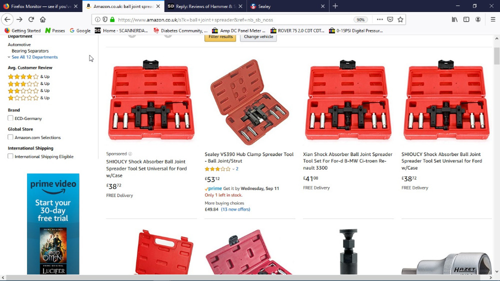

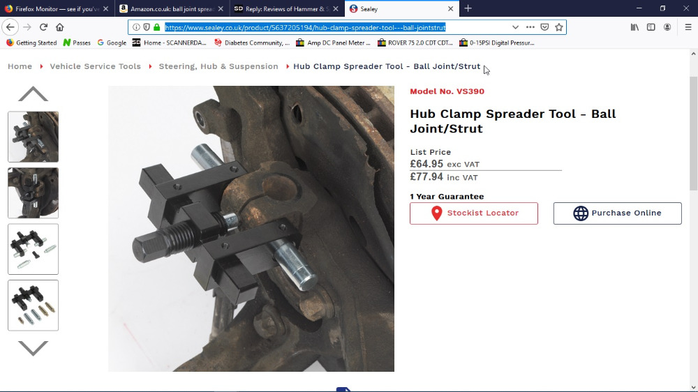

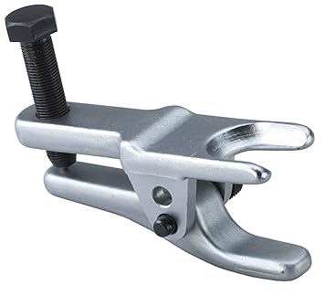

Ball Joint Clamp Spreader I bought an unbranded one of these a few years back having broken more than a few screw drivers wedging clamp type ball joints open, although a bit of fiddle to set up it is a very effective tool, recommended.
Link to Instruction Sheet on Sealey Website
Link Instructions on Sealey Website
6 years 11 months ago #33467 by Noah
Replied by Noah on topic Reviews of Hammer & Spanner Tools
Andy.MacFadyen wrote: Ball Joint Clamp Spreader I bought an unbranded one of these a few years back having broken more than a few screw drivers wedging clamp type ball joints open, although a bit of fiddle to set up it is a very effective tool, recommended.
I have never seen one of those.
It's like the marriage of a puller and a nut splitter.

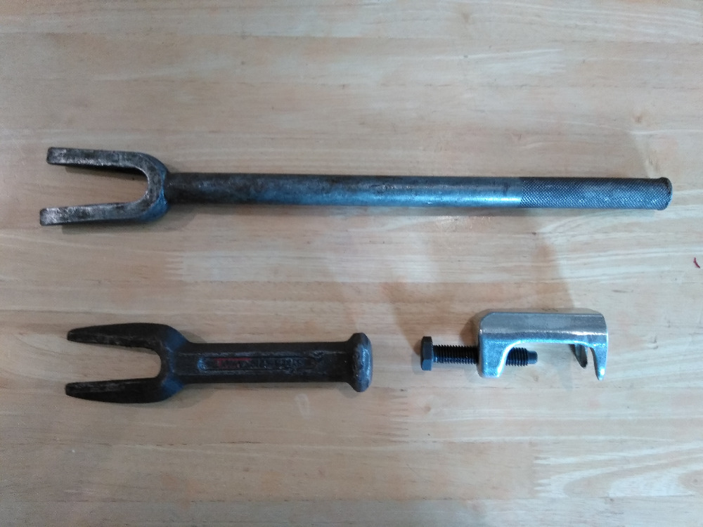

Speaking of suspension tools, this one has been fan-freakin-tastic:
www.tooltopia.com/otc-tools-6297.aspx
I used to laugh at these tools. I mean, this is what BFH's are for, right? :silly: But it's just too easy and fast to not have one.

Yes I use an almost identical one "Silverline" brand. It got a lot of use on Honda and Rover bottom.arms
I had to buy a new track rod end extractor press last week, couldn't find the one I have used for decades really narked because it was a Sykes-Pickavant and you can't get them any more, new one needed quite a lot of attention from the grinder to slim it down before I could use it.
Like everybody of course I use the Pickle Fork most time where the joint is getting replaced anyway For anybody buying one for the first time always go for one with a long handle , easier to use and saves hammer rash but very handy to lever the ball pin out of the socket.

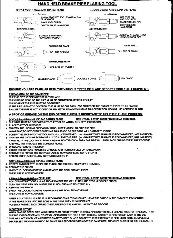

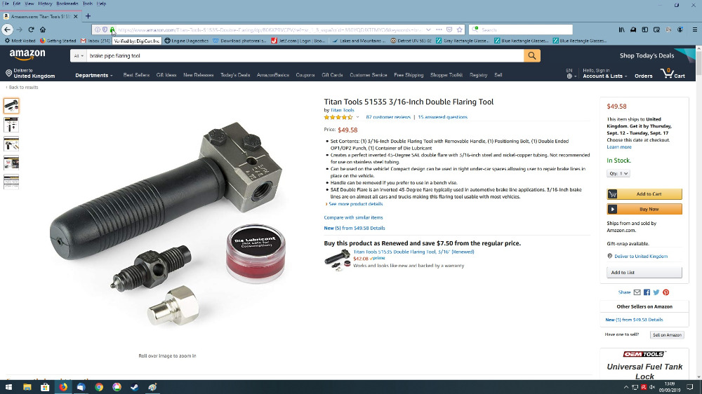

On Car Brake Pipe Flairing Tools
For years I used a puka Sykes-Picavant bench tool for making brake pipes it produced beautiful results but more an more engine bays offering poorer access I found I was having to splice in new sections of brake pipe working on car. This was the answer it produces very nice flares on both steel Bundy and Kunifer pipe and is easy and quick to use in confined spaces. Mine was UK made and branded "Power Hand" but it is available under different brands on eBay and Amazon DIN and SAE are separate tools other versions are also sold for other larger pipe sizes.

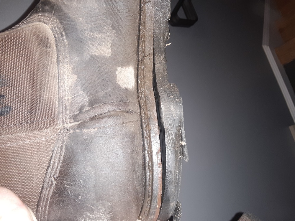

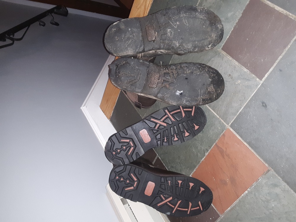

So I absolutely destroy boots. It's a junk yard thing. Not uncommon to go through 3 pairs a year. And for me, wet feet are a deal breaker. So I've been buying a Wellington style boot for years now and I'm retiring my current pair after 3 years.
With burn holes, separating soles and blown out seams I can still walk through 6 inches of water without getting my socks wet!
They're not terribly fashionable, but after destroying every boot on the market, I highly recommend this style boot for anyone who works outside or spends any amount of time in the mud, snow or rain.
I wear them year round.
I'm including before and after pictures since my wife just got me a new pair for my birthday tomorrow :)

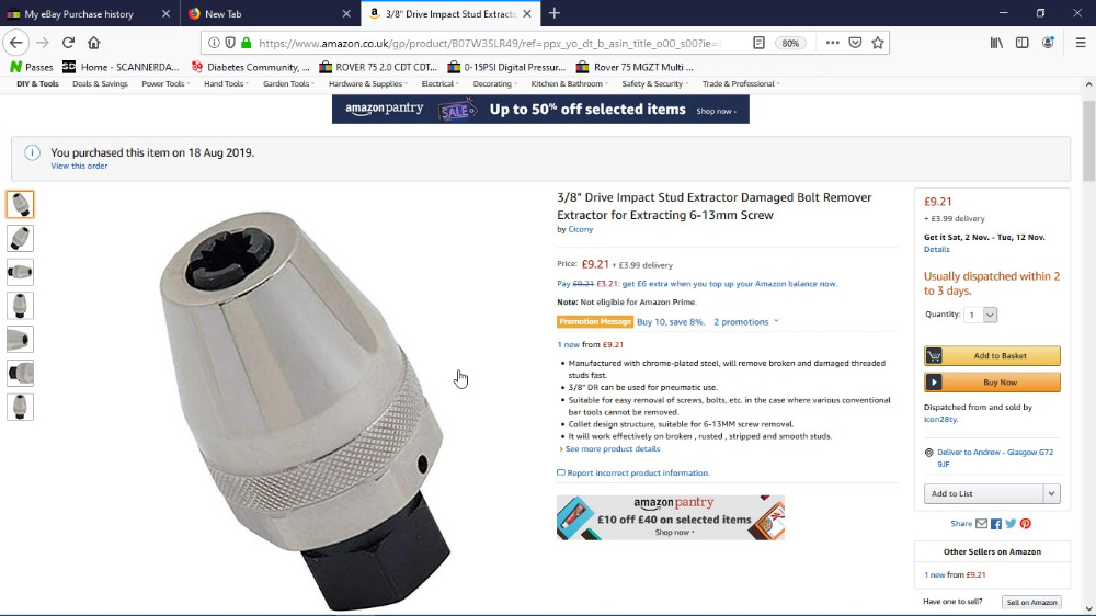

Small Damaged Bolt Extractor :-) :-) :-) :-) :-)
I bought this generic unbranded tool specifically to deal with small m6 or smaller flange head bolts on vehicle front panels.
Flange head bolts are a pita on older cars the hex corrodes under size and the hex isn't deep enough to use vise grips on and are generally too small for damaged bolt sockets. If you can get enough access room to fit the nose of the chuck in it works first time everytime it works first time eveytime either using an impact gun or a wrench
Amazon UK Link www.amazon.co.uk/gp/product/B07W3SLR49/r...00_s00?ie=UTF8&psc=1

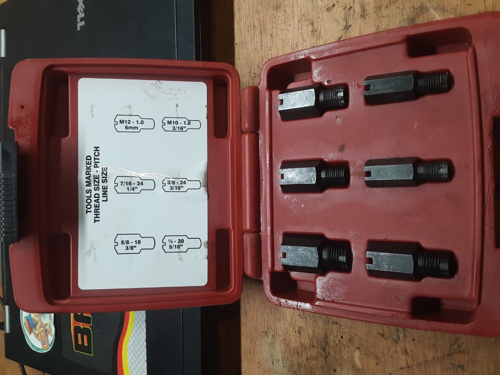

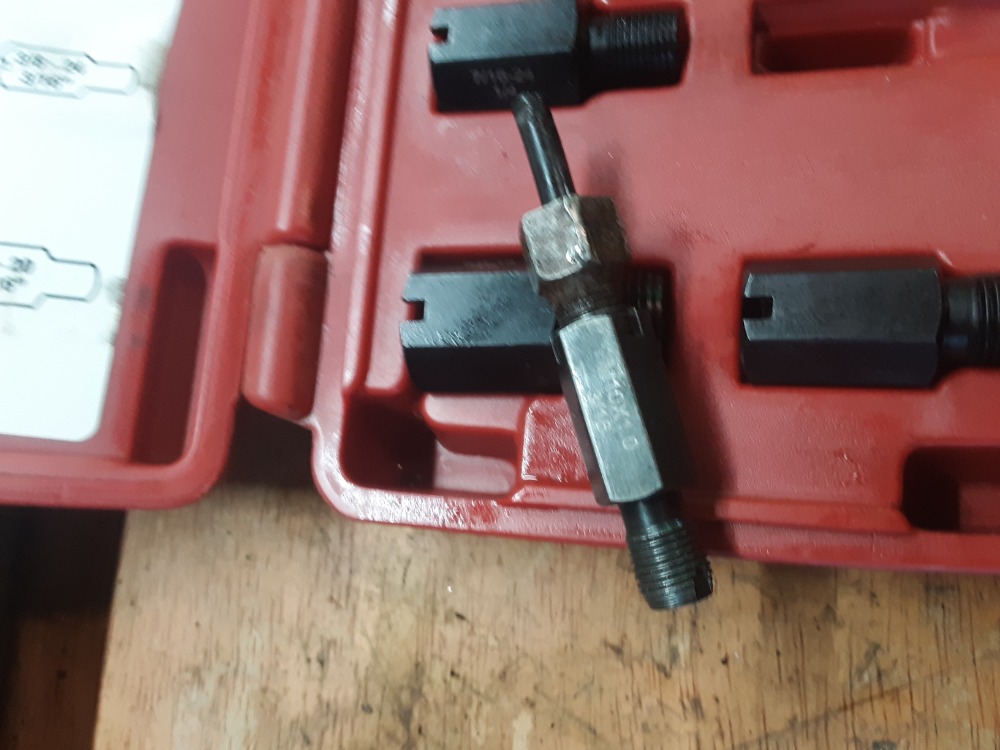

Brake line fitting thread repair kit. Not mine, but I borrowed it and it saved my bacon. Now I need one of my own.
Each tool will work on the male or female side of things.
Especially helpful when that first thread is just a little mucked up and you just can't get the line started.

Oh I want one of those thread repair kits, must be really useful for SAE fittings which can be a pita, DIN tend to be easier

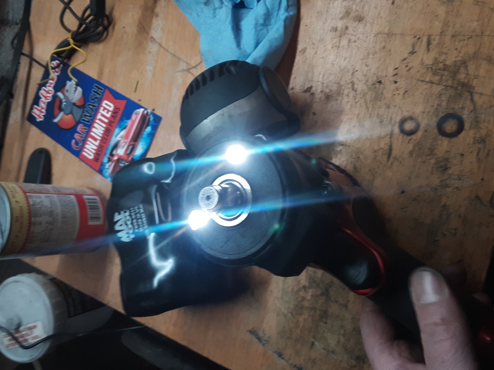

Just scored a great deal on the big boy Mac tools impact gun :)
HIGH PERFORMANCE 1/2” DRIVE AIR IMPACT WRENCH
MPF990501
Two guys at my shop each bought one from the Mac man for over $500 (with tax and such) within the last year.
www.mactools.com/en-us/Power-Tools/Air-D...ve-Air-Impact-Wrench
My Snap-On rep shows up today and asks if I have any interest in the same Mac gun,(he took on trade for a cordless rig), for $100!
I said yes right away, then asked if he had any interest in taking my Snap-On gun in trade. Been collecting dust for over 2 years now anyway.
He gave me $50 for my old Snappy and I walked off the truck with a $500+ impact gun for $50.
