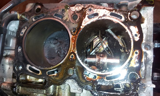

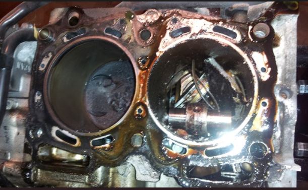

7 years 6 months ago #28784 by Matts Auto
Replied by Matts Auto on topic Learning to Post Photos
Pole, that looks like a suby engine converted to boat anchor
  • tmcquinn
  • tmcquinn's Avatar Topic Author
7 years 6 months ago #28785 by tmcquinn
Replied by tmcquinn on topic Learning to Post Photos
Matts Auto wrote: Pole, that looks like a suby engine converted to boat anchor
Well, after blowing the first engine, the guy bought a 2.5 liter salvage yard short block and told his techs to bolt on the tubo, intake, exhaust, etc. People make these 'hybrids' all the time (it had a 2.0) but it only works if you use low compression pistons, which he did not. Next the paperwork shows that he went to his tuner and got himself a big ole performance tune. Shortly after that it somehow stopped running...
"I'll never know it all but I'm willing to settle for knowing where to find the answer!"
7 years 6 months ago #28804 by Noah
Replied by Noah on topic Learning to Post Photos
It clearly wasn't boosted enough. You can tell because the other piston wasn't erased from existence...
