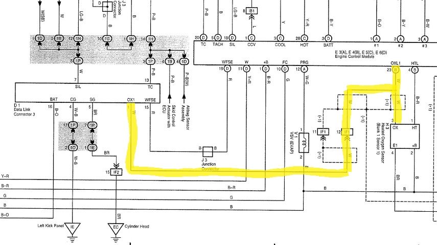

Then I notice that the test light bulb is dimly lighting when connected to the O2 signal circuit... Not bright, but lit. Bingo, here's our problem :woohoo: There's some kind of resistive short pulling the O2 signal down, and it's carrying enough current to light the bulb. I pull the wiring diagram before ripping the PCM out of the dash. I've highlighted the O2 signal circuit.
Now that's NOT what I was expecting - the signal runs to the DLC, on Pin 1. I'm trying to imagine why anyone would do that when it all goes *CLICK* in my head. The problem is the scanner itself :blink: Somehow, some way, it's pulling the O2 signal to ground. It explains the new symptoms, the Grand Caravan, and the test light. To prove it, I grab the shops Autel and hook up. Perfect O2 switching, fuel trims are countering each other, and the O2 voltage goes to 0V when unplugged.
