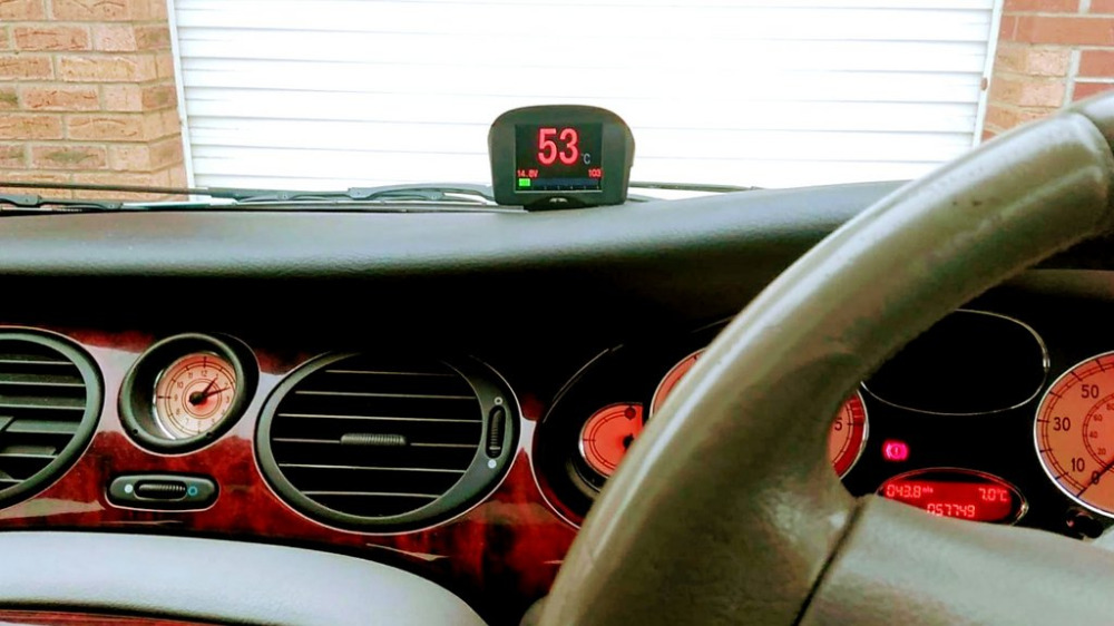

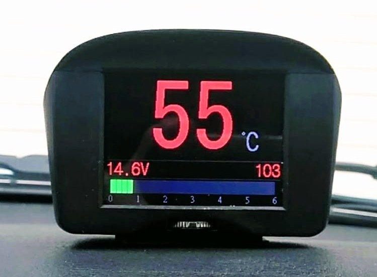

7 years 10 months ago - 7 years 10 months ago #25946 by Andy.MacFadyen
Replied by Andy.MacFadyen on topic ATF dipsticks & engine temp missing ?
Sometimes for peace of mind you have to take action --- not pretty but less than £30/40$ from Amazon made by Autool works off OBD2 socket
7 years 10 months ago #25965 by Noah
Replied by Noah on topic ATF dipsticks & engine temp missing ?
Andy.MacFadyen wrote: Sometimes for peace of mind you have to take action --- not pretty but less than £30/40$ from Amazon made by Autool works off OBD2 socket
Nice :)
