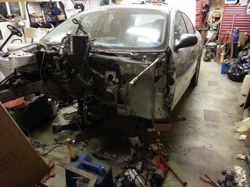

Here is a series I took of a car that I fixed for my neighbor. I sold the car to her son after replacing the engine and some other mechanicals. He proceeded to try moving a cement barrier 3 weeks later, totaling the car. His mother was still paying for the loan and had just lost her husband, so I didn't have the heart to sent it for scrap. It took me the better part of 8 months to get up the nerve to do this as I am not a body man. Almost 2 years trouble free since done.
After removal of the carnage
donor chassis
Floor pan pulled back out
test fitment
Panel tests
Finished product

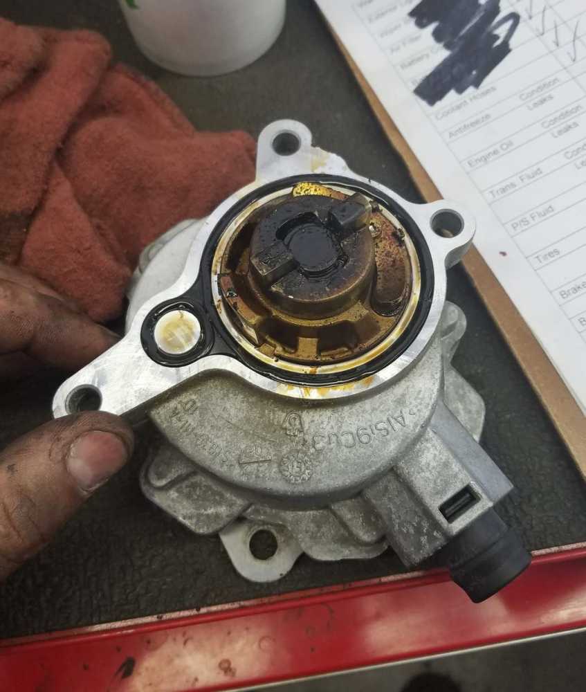

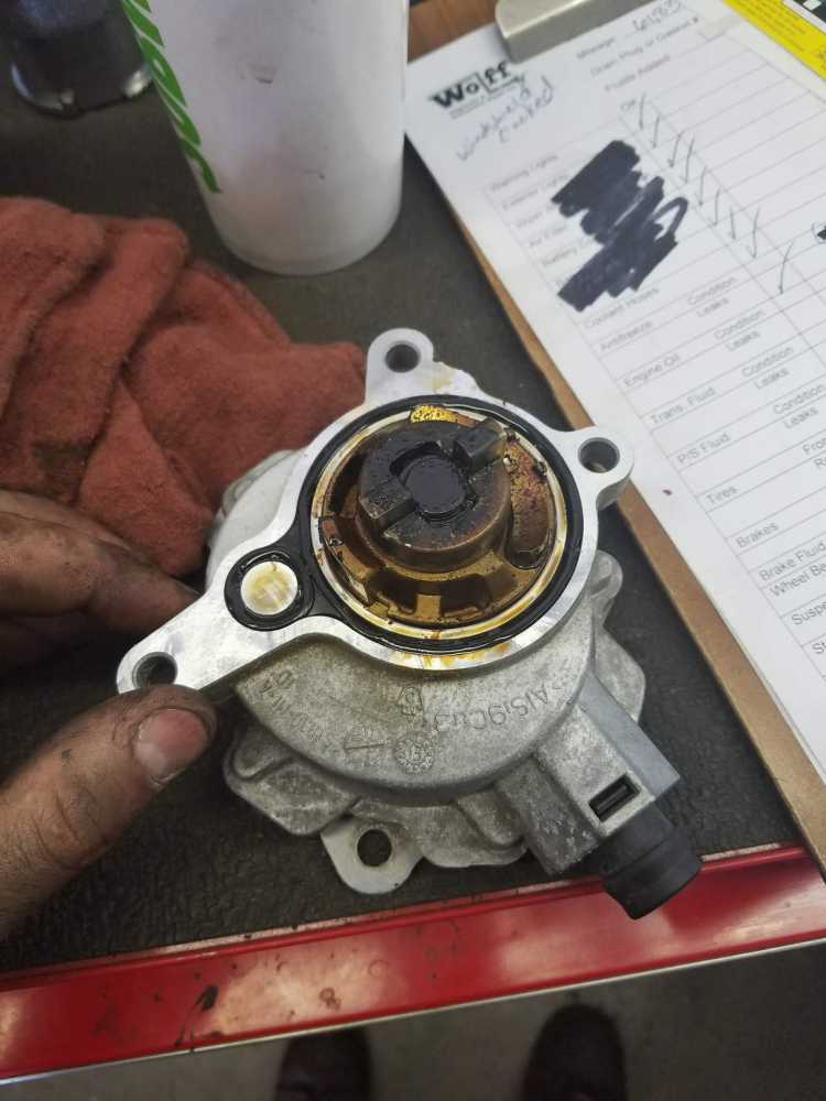

2015 Land Rover comes in with no power brake assist. It uses a normal vacuum booster, with a vacuum pump on the intake camshaft. Tech finds no vacuum at the pump, no other controls present, sells a pump. Here's a shot of the engine bay:
And the back of the pump itself:
Gets the pump off, and his exact words were, "Houston, we have a problem." :lol:
Oops! The drive plate for the pump snapped off in the intake cam when the vacuum pump seized up. Just curious, can any of the Euro guys tell me if this is a common failure?

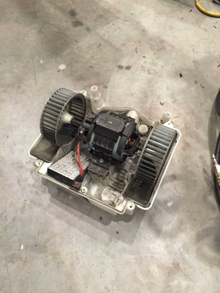

Replacing a blower motor on this ugly rust bucket.... the part alone was 400 at the dealer.
