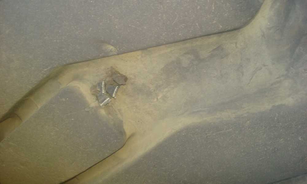

I was plugging a tire the other day on my front end loader in the junkyard, and thought some people may be interested to see how I do it.
After twelve years or so of running over about everything you can imagine, I've developed a pretty good method of plugging large punctures.
These are old take offs from other machines, new tires isn't an option and would be a waste of money for this use.
I also SERIOUSLY don't recommend trying this on a vehicle you intend to drive on the street!
These are 17.5 x 25 Loader/Grader tires. So, not very big by equipment standards.

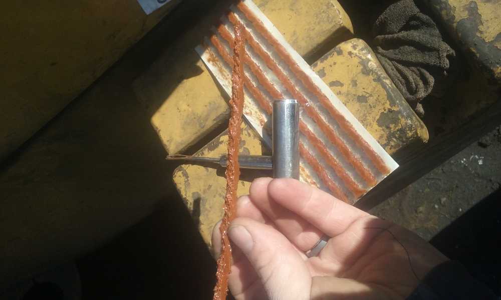

First off, I like these long brown plugs for this. The skinny black ones are fine for smaller stuff, but this is a real large puncture. (Any civilized industry would throw away this tire...WAIT, THEY DID! That's how I got it, LOL :silly: )

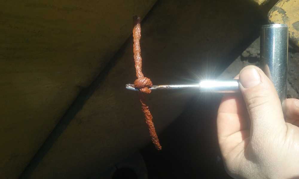

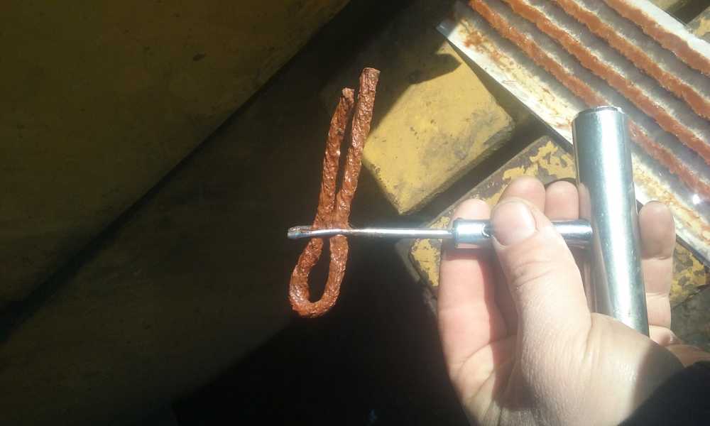

So start by threading one end of the plug through the eye of the repair tool
Then, thread the other end through the same side of the tool so that you have a loop

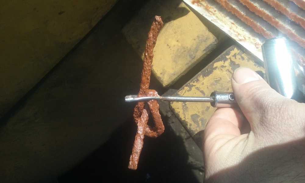

Then, take one loose end and thread it through that loop so you have a knot

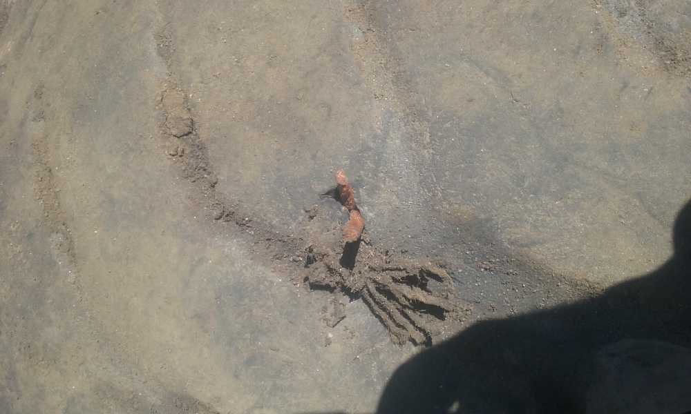

Cinch the knot and stuff it in the puncture wound in the same direction as whatever you pulled out of the tire.
Repeat as many times as necessary :whistle:
And we'll run this one at 30 psi instead of 40 since it's a rear tire from now on.
Will it last forever? No way baby! But can I get on with my day and be productive and make money? Bet your britches I can, and will!
