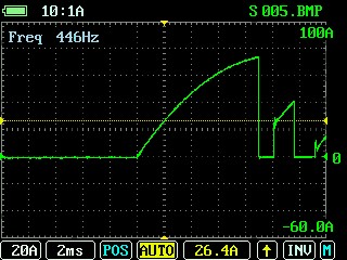

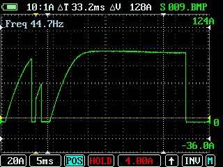

2 months 3 days ago #93245 by DGB

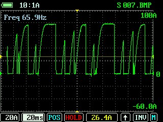

Good afternoon all. New Premium member, also new to the lab scope. I took some readings on a 93 Wrangler 2.5L M/T (amp clamp on primary negative) 2 wire coil and am trying to identify what I am seeing here. Looks like nothing I have seen while doing my research. Any input would be greatly appreciated. If I did this correct there should be 3 screen shots attached here. Looking at these wave forms I am leaning twords the ignition driver in the SBEC is not switching correctly. The vehicle has a hard constant miss, feels like it is only firing on 2 cylinders. Good Cam and crank signal happy to post those if needed.
2 months 3 days ago #93246 by Tyler
Replied by Tyler on topic Primary ignition waveform questions
Your screenshots are wild, DGB! Is your amp scale correct? 'Cause it looks like the coil is drawing 80-ish amps at times. I don't have a known good dwell time for a coil on a 4.0L, but 30+ ms is an eternity. I'm surprised the coil hasn't overheated, or popped the fuse. Or smoked the coil driver.
I don't blame you at all for suspecting the PCM, but I'd want to have another look at the cam/crank before pulling the trigger on a replacement. Would you mind posting the waveforms?
2 months 3 days ago #93248 by DGB
Replied by DGB on topic Primary ignition waveform questions

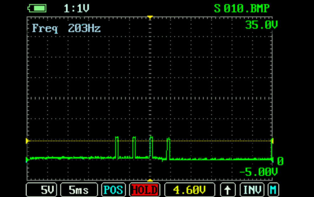

2 months 3 days ago #93249 by DGB

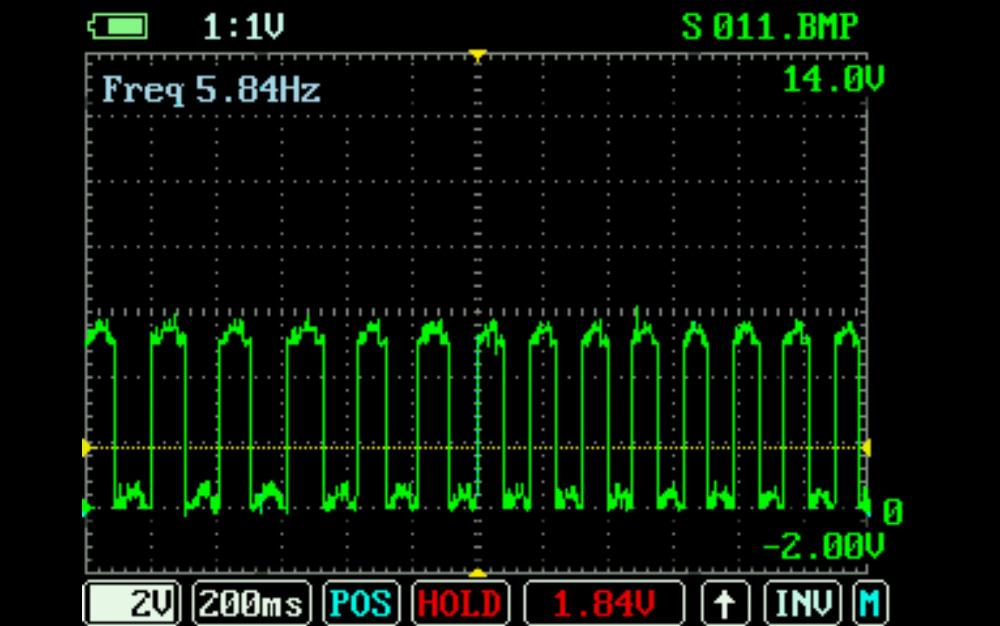

Here are cam and crank

2 months 2 days ago - 2 months 2 days ago #93252 by Chad
Replied by Chad on topic Primary ignition waveform questions
Scope at 10:1 ignition preset
This is why your reading such high amperage. The scope is multiplying the signal by 10x.  You do not need this setting with an amp clamp.
This setting is for when you are using an attenuator to reduce voltage input to the scope, like you would when capturing a Coil Primary Voltage waveform.

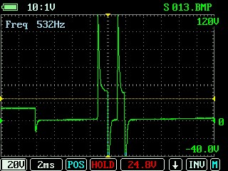

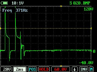

2 months 1 day ago #93258 by DGB

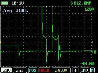

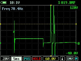

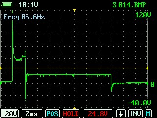

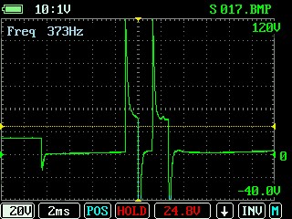

Here are the screen shots from the new test. Primary coil control back probed. Engine at idle. The shots showing 2 wave forms back to back, is that something I am doing wrong with the scope? none the less these don't look good
Base on those Primary Voltage waveforms, I would pull the spark plugs to make sure they are not fouled.
But, the thing that concerns me the most is the back-to-back firing events. It will be impossible to do with a single channel scope, but I would like to see a waveform of Cam, Crank, Coil control, and #1 injector control, all at once.

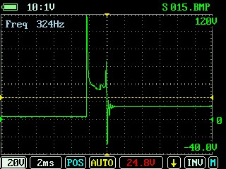

I unfortunately do not have access to a 4 channel scope. What caught my eye is on some of these snap shots the voltage is not coming back up to 14V after coil discharge like the very last screen shot (S015.bmp) which looks like it should.
2 months 7 hours ago #93264 by Chad
Replied by Chad on topic .256mV Alternator A/C ripple
Good eye! If you had a 2-channel scope, I bet the current waveform would show these areas as some crazy-long dwell times. I think that I would disconnect the coil control wire from the Coil and PCM. A continuity to ground check with an Ohm meter should display OL. Give the wiring harness a good wiggle and watch the Ohm meter for any continuity to ground. If no faults are found with the control wire, I would begin to suspect a faulty PCM. However, I would still want to see Cam/Crank and coil and injector controls, all together.

BTW you are correct about the crazy dwell times. Lol Don't need to put them side by side to notice. Scroll up to the beginning of the thread.

1 month 4 weeks ago #93273 by Tyler
Replied by Tyler on topic .256mV Alternator A/C ripple
I didn't think of it before. Voltage drop on that coil control wire, no telling how long it has been that way. Could have stressed the driver?
Excessive voltage drop generally won't cause driver damage, as voltage drop will cause less current flow, not more. Less current flow, less heat.
I agree with Chad, we really need to see the cam and crank together. It also kinda looks like the CMP signal voltage is changing when it shouldn't be. The 5V and ground sections both have regular 'peaks'. Those might get misinterpreted by the PCM as a signal transition.
