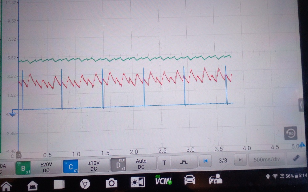

Hi guys hi every body
Gmc accadia 2008 with 3.6l engine
Check engine light on with code p0019 crank/exhaust cam correlation
is this image enough to make sure that the cause of the code p0019 is timming chain jumped issue?
thanks in advance for all of you guys

Replied by Chad on topic Cam/crank issue
That image, definitely, shows a bant-to-bank compression imbalance. The most likely cause would, certainly, be a jumped chain.

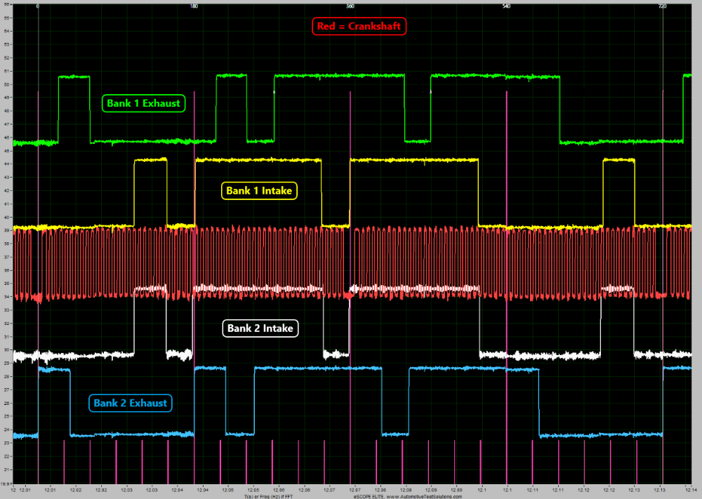

Capture a cam/crank waveform and compare it to this known good, if you you have any doubt.

1 year 4 months ago - 1 year 4 months ago #91981
by Shbouka
Replied by Shbouka on topic Cam/crank issue
Thank you so much Chad
awesome capture
awesome capture
