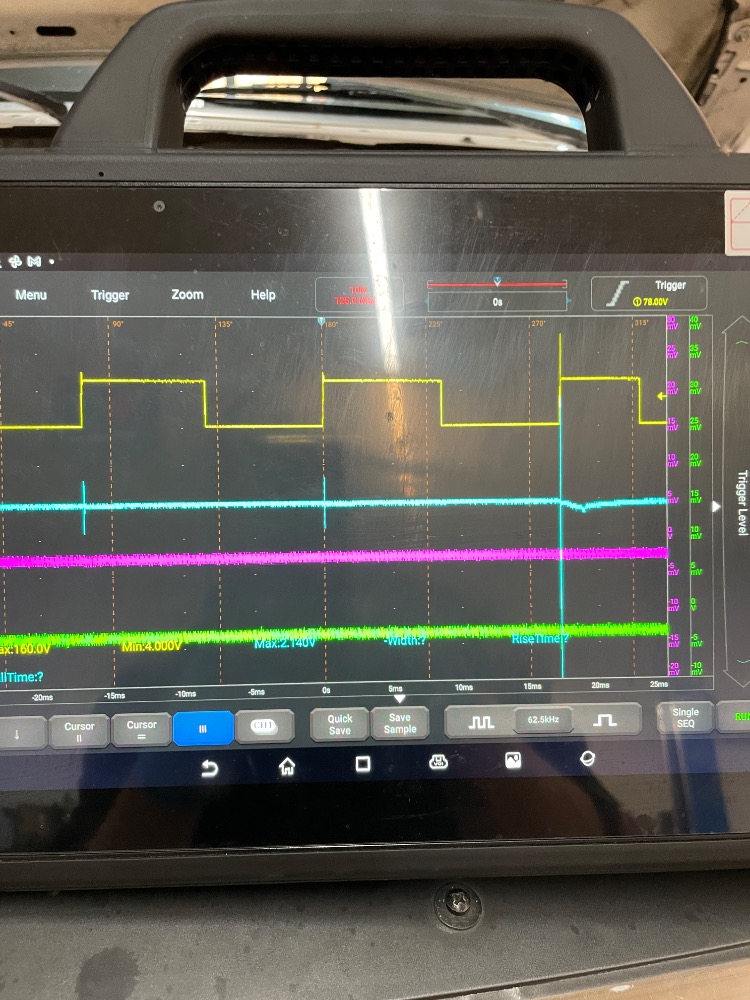

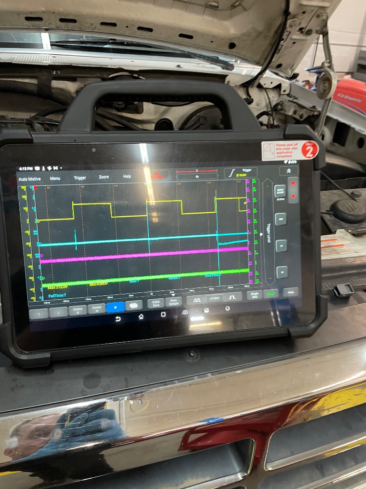

Tyler… I recently had some questions regarding my truck and I bought my launch scan tool,.. which is amazing. The x431 pad 7 elite and would be AWESOME AND PERFECTLY USEFUL if I lived in Europe lol of course I live in Indiana. However the scope is decent. But I’m also new to the digital scopes and I simply just haven’t used them. Now I own a shop and it’s NECESSARY! If you want to be 100% about a diagnosis I must be confident in what I’m selling my customers to fix the issue. So I’m turning to my fellow techs for some assistance.,. Am I not slowing my time line down far enough? It keeps telling me I’m at my limit… channel two the blue is cylinder number 1. Channel 1 yellow is my pip wire. Maybe I’m completely wrong I. All this, this is on my 1995 ford f150. I appreciate it thank you!

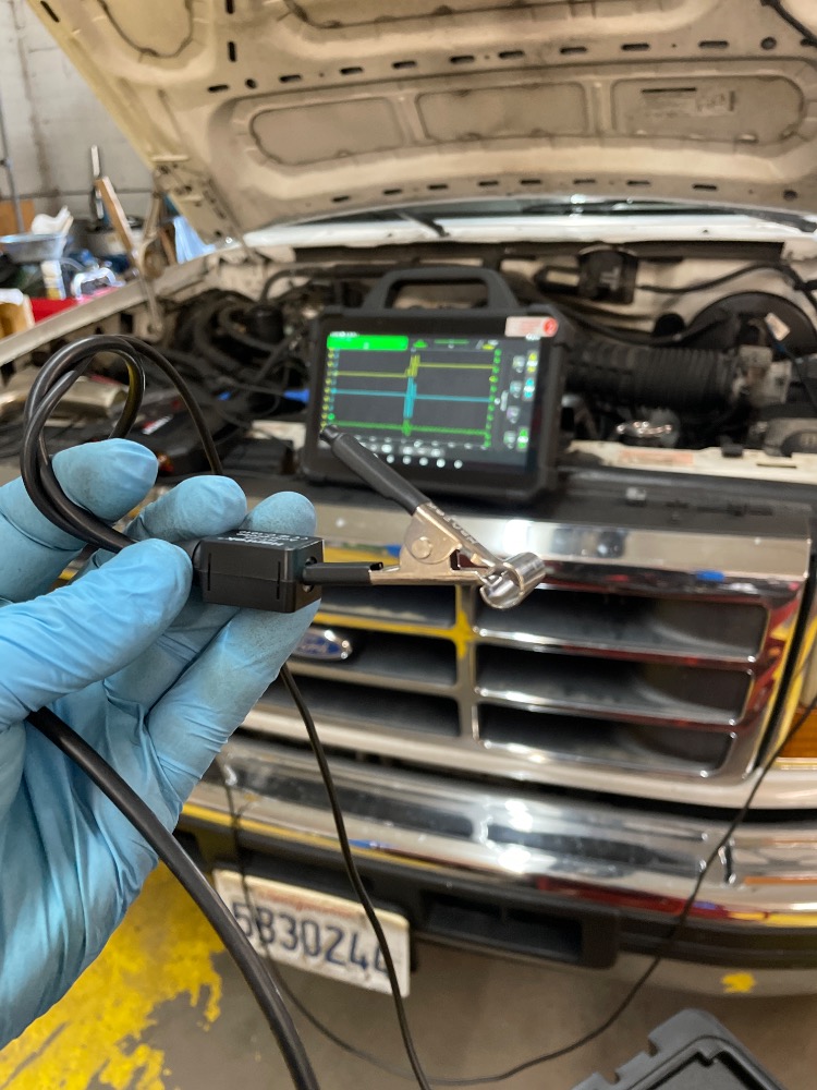

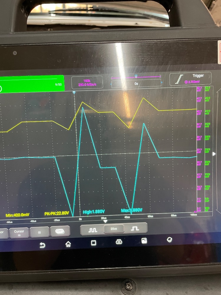

I definitely meant to attach photos to my post I apologize: so I think it’s like anything else here. Trial and error. But this o2-2 oscilloscope cost me 700… and then the scan tool was 3300 and it’s great but not on domestic vehicles. But to the point… - I’m going to post the picture of what my post above describes- wave form of my 1995 ford f150 5.8 channel 1 yellow- pip wire and the blue is number 1 cylinder. I want to establish that I’m using my tool correctly so I can use this to help my customers with their issues and of course save myself time and frustration. Thanks in advance. Please let me know if I’m testing the wrong circuit or if I’m using this incorrectly… and this secondary pickup seems like it has an attentunator built in so I didn’t use an extra one at the scope. Correct? And I can go straight to the wire or do I need an extension of some kind?
