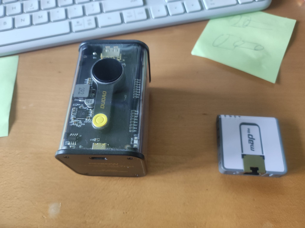

I had own a
CarScope PLUS
and it's a very good scope, you cannot compare with a 2204(that is for kids to play) as well is in different class compared with Hantek, Autel or Launch(i had own all of them and are rubbish).
The resolution is a little bit low but you can play with the sampling rate, for the input you will not need to use any attenuator until around 200V only for the ignition or CR diesel injectors.
I recommend to use 10:1 instead 20:1 and use from them not hantek 20:1 or you can use pico as well but they are very expensive(i have two from Pico and 8 from Ditex).

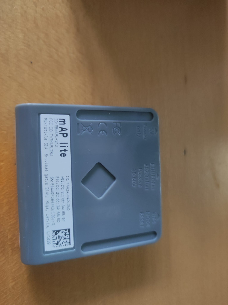

I had made a few adjustment for the scope adding a power bank(usb C 5-12V output) and wifi access point(there was no delay).
The same power bank (12V) i'm using for KTS 570.
Now i own a few scopes but mostly i'm using pico 4425a, 4824A and Bosch KTS 570.
