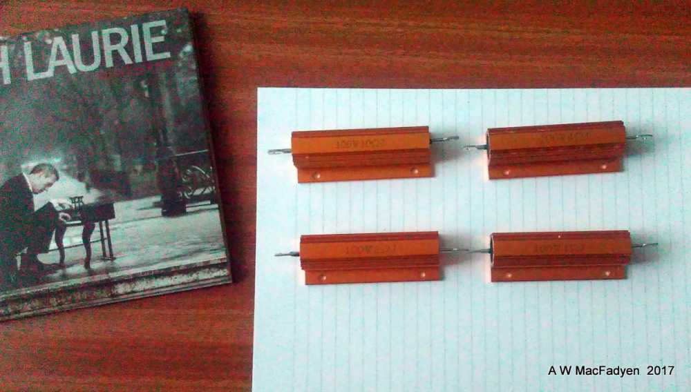

9 years 6 months ago #8392
Replied by Andy.MacFadyen on topic Using a headlight to load a circuit
I bought some high wattage metal cased resistors last month with the idea of making a puka dummy load up, I haen't had time to figure out the best way to use them yet it depends what I find in my junk box.
