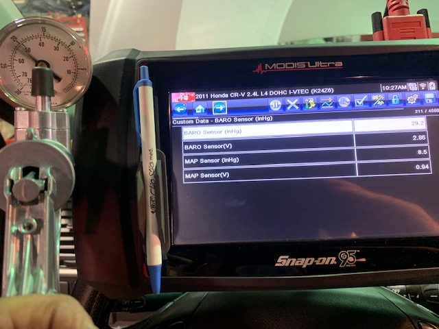

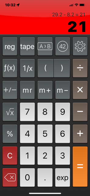

So... I was de-carbing an engine the other day and (I always monitor a scan tool while do this) it occurred to me, hey I should test Paul's subtract Map from Baro tip! S0...
and do the math
look at the vacuum gauge next to the modis! 21 inches!!! (I always run a long vacuum line from the manifold into the cabin so I can nail the key to off if I have to, never have had to but lets be safe)
Holy crap!!! it works!!! all this time like 25 yrs plus using a scan tool and I never realized that the .84 -.90 volt map sensor reading I always look for is realy 21 inches of vacuum!!!

Actually the 0.9 volts DO NOT reflect 21 inches of vacuum.
As per name - Manifold Absolute Pressure -; this is what it really means. The (low) pressure created in the intake manifold at idle will translate into a voltage reading on the scanner. This pressure and the corresponding voltage would not change with different altitudes but the engine vacuum/gauge pressure would!.
Since the age of the Tech 2 the GM diagnostic software offers 3 pics: one being the baro, the second map and third the difference between those two, you may have a look at this concept.
In my opinion the map reading is of more value than the engine vacuum just because it eliminates variables not related to an engine itself. An engine in mechanical sound condition should produce the same amount of intake pressure independently from altitude.
