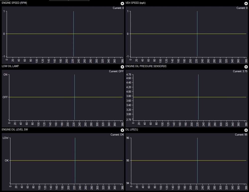

Paul is always asking, "What's the next easiest step?" What's your next move that'll tell you the most information in the least amount of time. Up for some armchair diagnostics? :cheer: I'll give you a vehicle, a complaint, and some data, and you tell me what the next easiest step is. No right or wrong answers, of course, just putting this up for discussion.

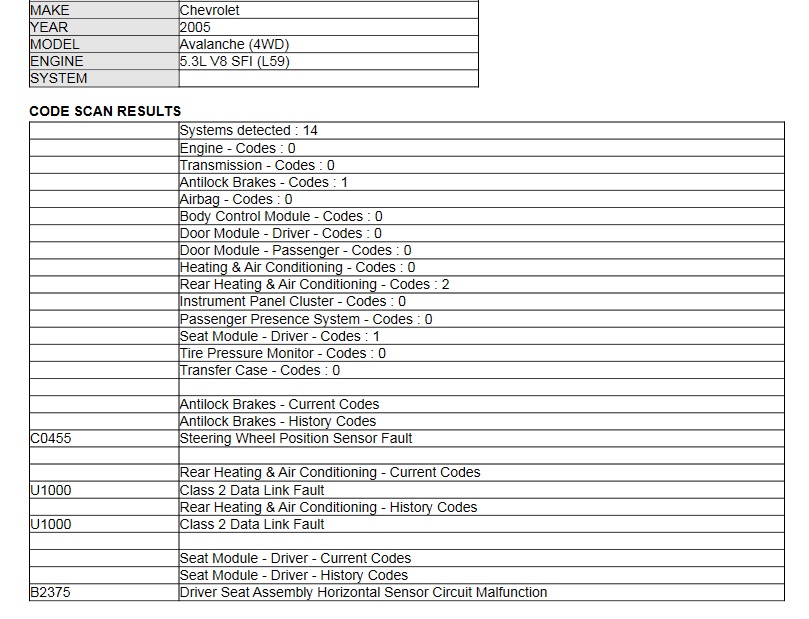

2005 Chevrolet Avalanche comes in with a complaint of the oil pressure gauge stuck high. Key on engine off.... Yep! Running is the same way. I start with a quick code scan:
Not much help there. :unsure: For those unfamiliar with this truck/engine, it uses a genuine pressure transducer for the engine oil pressure. No idiot light/gauge, the gauge (usually) reflects actual oil pressure. Here's the circuit, for reference:

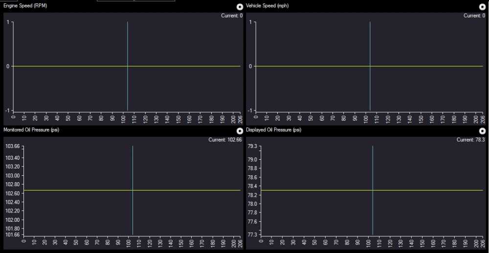

I start at the Instrument Cluster, wondering about a possible gauge problem. This is the data I found, KOEO:

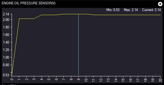

These are converted values, transmitted from the ECM to the Cluster. To find the real sensor voltage, you have to ask the ECM. Still KOEO:
So, you've got the data, what's your next easiest step and why? Again, no right or wrong answers, just interested to see how everyone would chase this one.

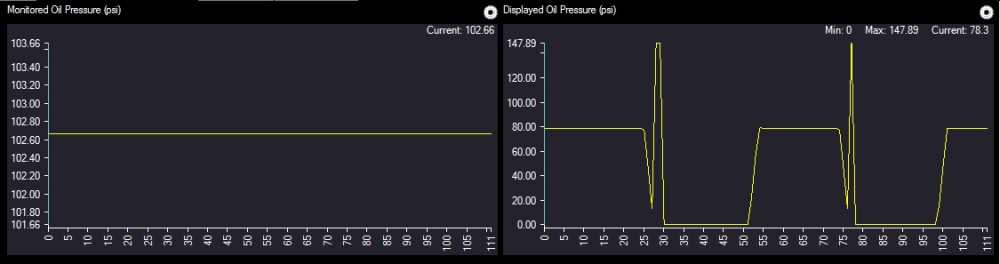

I check to see if there is a gauge sweep test and see if the needle moves in the full range.

The Verus is already hooked up and I don't want to open the hood yet, or start taking the dash apart. So my next step is a bidirectional gauge sweep.
Ro-longo wrote: I check to see if there is a gauge sweep test and see if the needle moves in the full range.
Great minds! I did the same, this is the scan data while sweeping back and forth:

But did the gauge move?

I knew the professionals on this forum would have this one beat quickly. :lol: So I ended up following the same line of thought as everyone that replied. First the gauge sweep, 'cause I'm already hooked up to the IPC. The gauge DOES sweep, so no problem there.
The 100+ PSI pressure reading with the engine off screams skewed sensor to me, so I go for the quick unplug-it test.
Yup! I like what I'm seeing. One new oil pressure sensor later, and things are back to normal.
