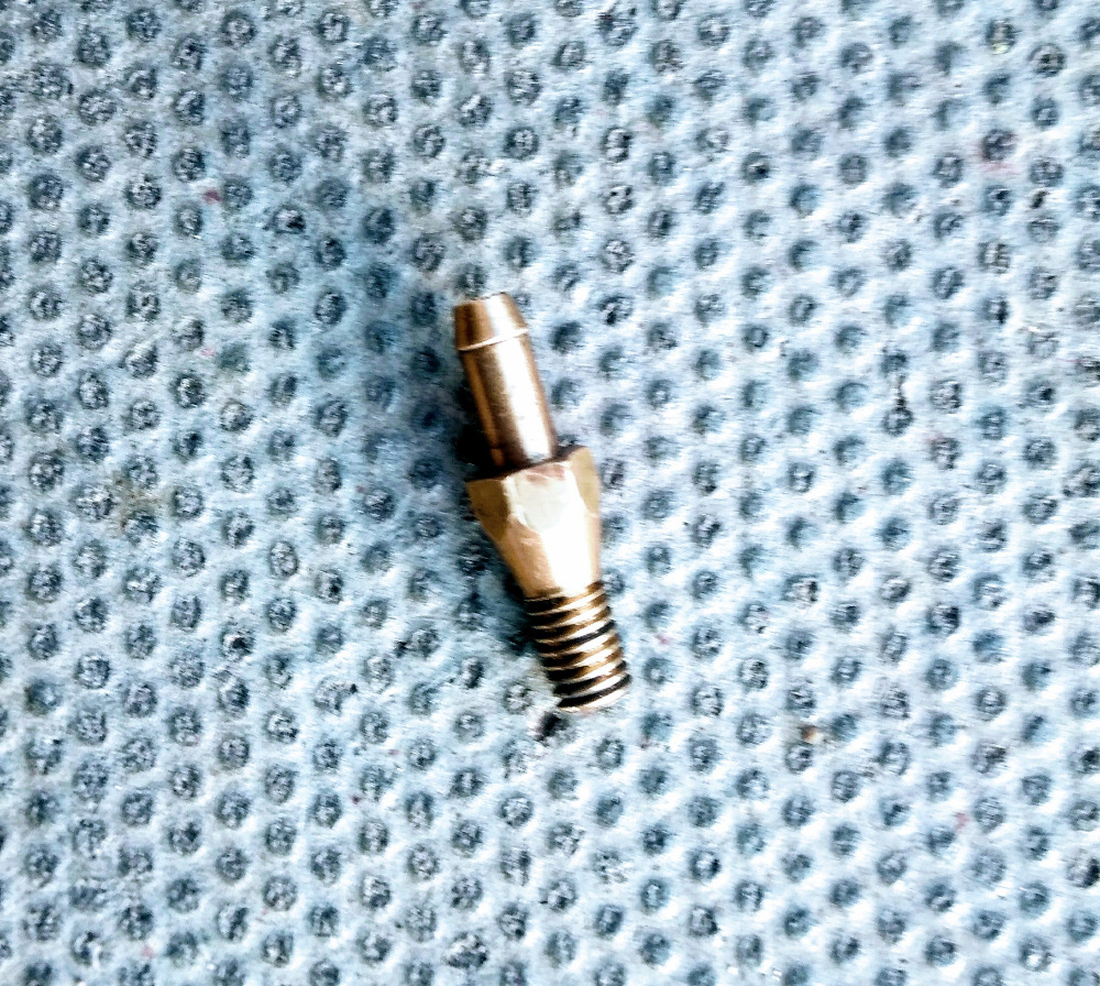

If I get problems removing an O2 sensor I usuall drill and tap a convient place on the down pipe for an M6 dia brass hose connector and plug it with an M6 set screw when I am finished.

6 years 11 months ago #34391 by Andy.MacFadyen
Replied by Andy.MacFadyen on topic Exhaust back pressure test
M6 hose connector
