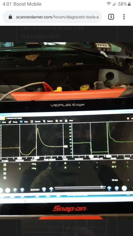

Thanks to Tyler for giving me the idea to build a secondary probe from an old Honda distributer pick up. B)
While playing around with it, I started to figure that it should be able to detect more than just coil firing. So how cool would it be to walk over to a car with a misfire and touch the coil to verify spark, and then use the same tool to touch the injector and verify operation?
At a 2v scale, 20ms time base I seem to get the cleanest captures. Now to compare to the methods we already have to try and dissect the waveform.
I'm trying to determine if mechanical movement can be inferred from the pattern. I think so, but I'm not there yet.
Let me know what you think.
Is it a viable test?
Am I just being stupid?

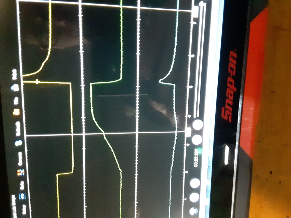

6 years 8 months ago - 6 years 8 months ago #34195 by Noah
Replied by Noah on topic Injector Testing With Secondary Probe

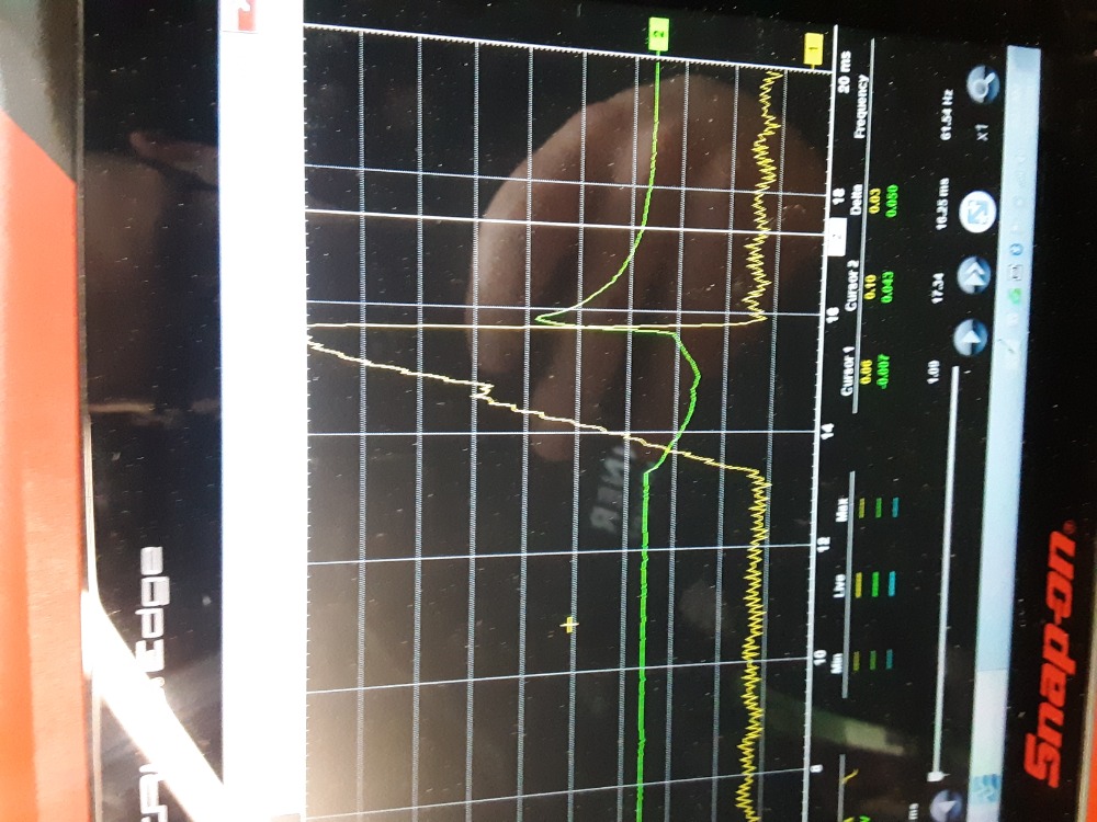

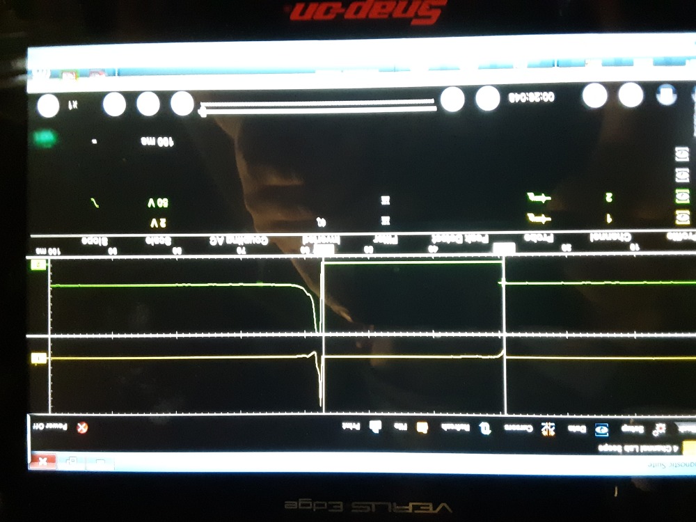

Here's a capture touching the purge solenoid on my Honda with a voltage trace on the control wire for comparison.
Sorry the forum uploads my pictures sideways and upside-down :(

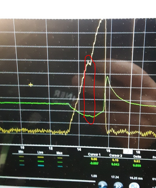

6 years 8 months ago - 6 years 8 months ago #34197 by Chad
Replied by Chad on topic Injector Testing With Secondary Probe
I believe I can see pintle opening.
Last edit: 6 years 8 months ago by Chad.
6 years 8 months ago #34198 by Noah
That's where I was looking also. Guess I need to find a car with a stuck injector now

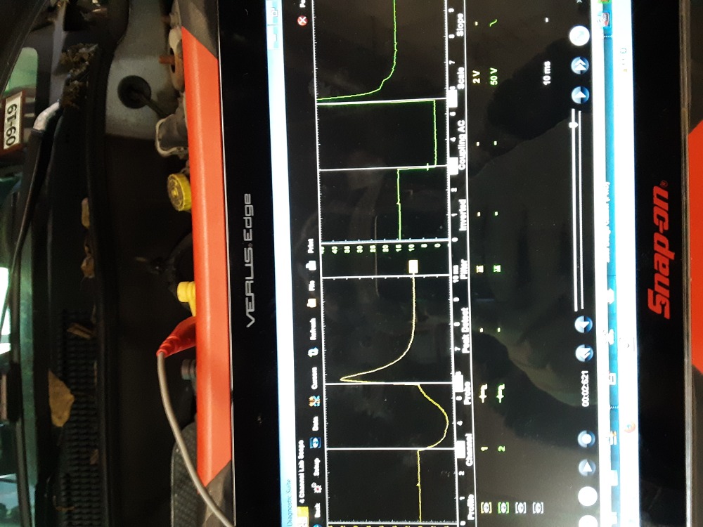

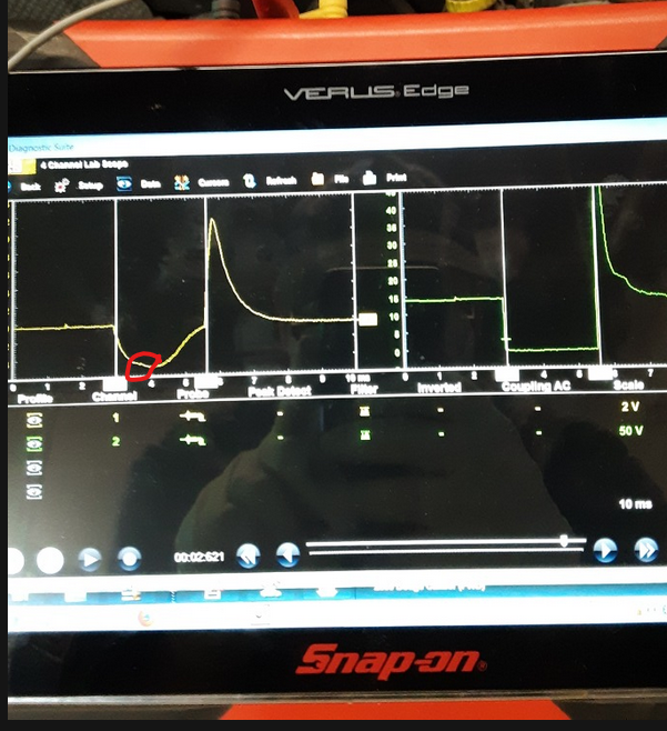

6 years 8 months ago #34348 by Noah

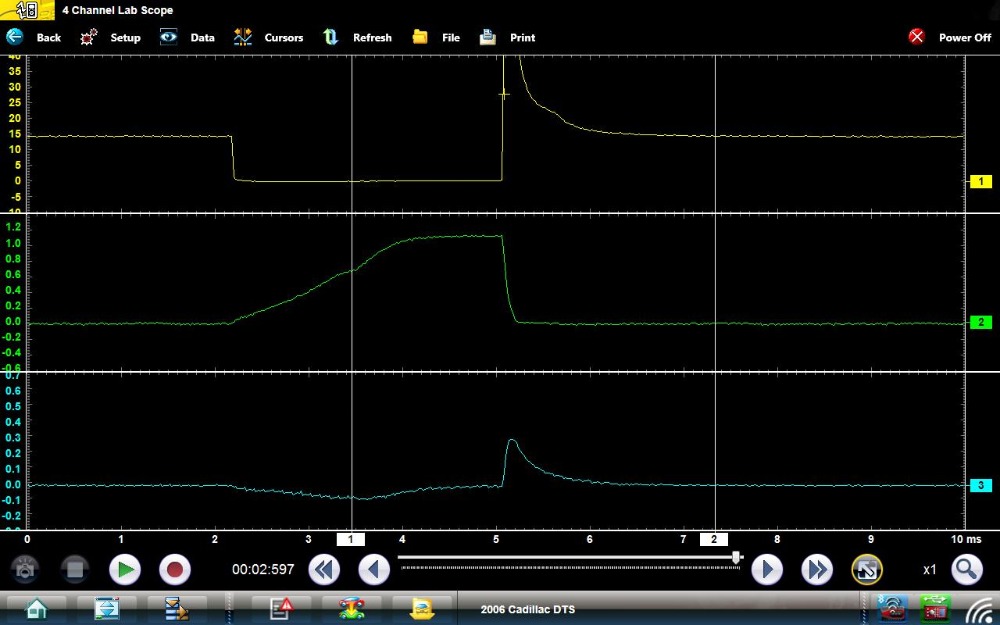

Here's another one I had a chance to hook up to today.
2006 Cadillac CTS 4.6l
It looks like when the downward slope of the blue trace begins to climb is when the pintle hump is visible in the current ramp.
6 years 8 months ago #34349 by Noah

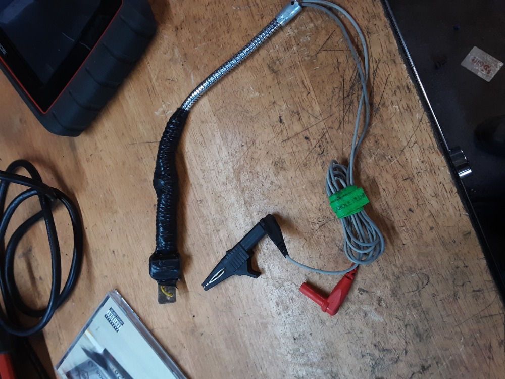

6 years 4 weeks ago - 6 years 4 weeks ago #40315 by Noah

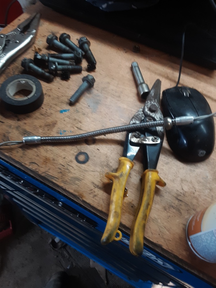

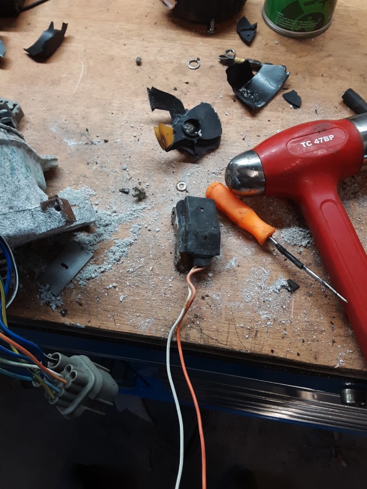

This is the build for Andrew.
It's seriously not fancy, so don't be too disappointed.
I deftly extracted, well, more truthfully brutalized an old Civic distributer to get the pick up out of it.
That's the little tid bit in the middle.
It's much larger than that to start. After I harvested it I ground much plastic off it (per Tyler's instruction) to get it down to that little giblet.
For the handle i used the flexible neck from my Astro rechargable light, which was also brutalized in an unrelated event.
I fed an old set of meter leads through the handle and connected them to the leads of the pick up. It was a total shot in the dark as far as determining polarity. I figured if it sucked it could always return to the trash from whence it came.
I wrapped the whole deal in mastic tape which gives it a nice rubberized-ish handle and a not-so-piece-of-crap look.
One lead goes to chassis ground, the other goes to the scope.
Then it's just a matter of fiddling with the scope to get the best pattern.

Is that what that roundness is on the yellow trace ( 2pics up)? I assume the green trace is a backprobe reading? If this is true, then genius! Next level, another quick test to take a peak at injectors. And if we can learn wave forms under different circumstances, then that's another step up in testing, and it's so basic.
5 years 11 months ago #41146 by Noah
That one?
Yes, that's a home made secondary ignition probe touching a fuel injector in yellow with the control voltage displayed in green.
Thank you for your interest :)
