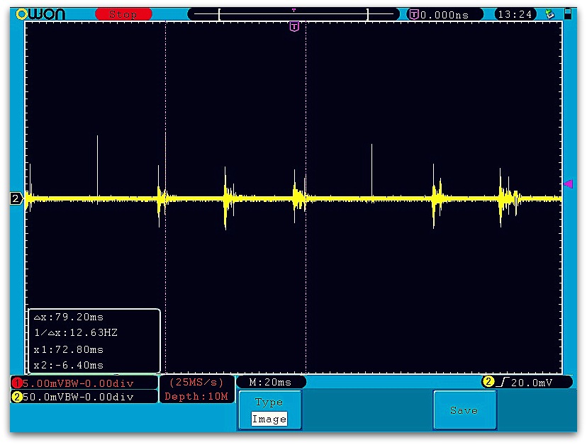

9 years 10 months ago #4608 by Andy.MacFadyen
Replied by Andy.MacFadyen on topic Testing fuel injectors with a knock sensor
Clearly shows non-firing injector -- but no way to identify cylinder without another channel to give synch to firing order.
I would preffer this test over a FirstLook sensor on the fuel rail pulse damper..

Andy.MacFadyen wrote: would preffer this test over a FirstLook sensor on the fuel rail pulse damper..
Totally agree here. I find this method to be much easier to interpret, with less work required. But, like you said, we then get into noise and background interference :unsure:

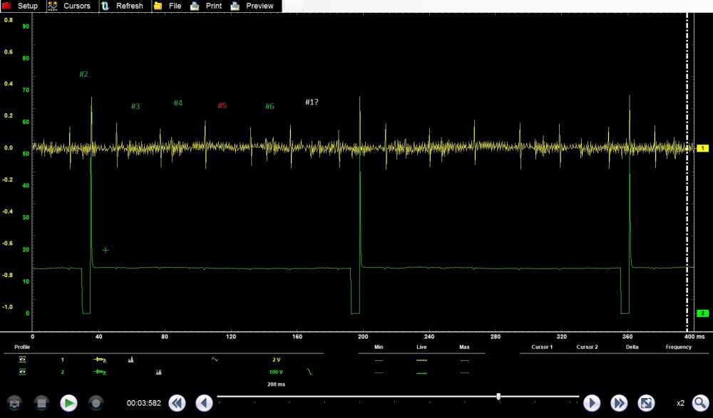

9 years 9 months ago - 9 years 9 months ago #4726 by Tyler
Replied by Tyler on topic Testing fuel injectors with a knock sensor
Anyone sick of this yet? 'Cause I'm not! :cheer:

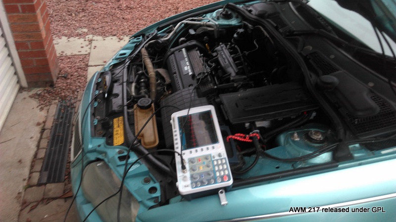

Got the chance to play with this on a Chrysler Sebring, 2.7L. Customer complaining of a misfire, and it actually had a #5 injector code stored. Really, the diagnosis was pretty straightforward, but I wanted to have a look anyway.
The trick here is that this engine uses plastic fuel rails (one for each bank), with a metal tube connecting between them. This ended up changing the quality of the waveform quite a bit.
Here's what I ended up with during the misfire. The knock sensor is up against the metal pipe in this capture, triggered off #2, firing order 1-2-3-4-5-6.
Admittedly, this one is very tough to call useable. :( After having looked at these a few times, I can say that #5 is definitely not opening, but what's up with #1? I can barely distinguish it from #5. If I didn't have the injector code to guide me, I might be tempted to say there's a problem with #1, too.
So, it doesn't work perfectly in every scenario. Variables, always variables. :lol:

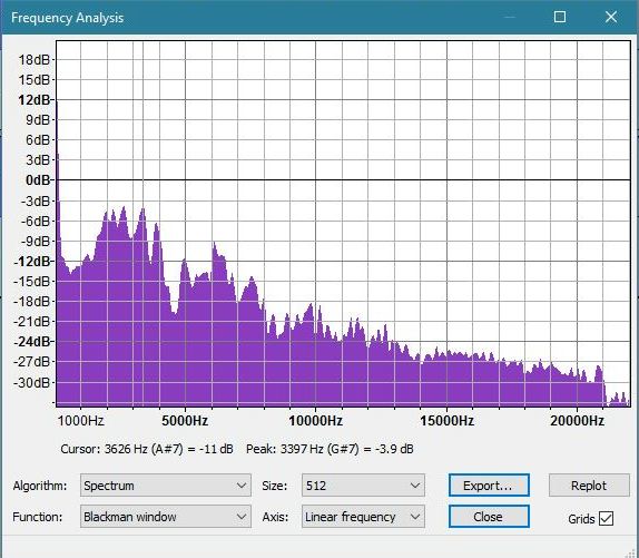

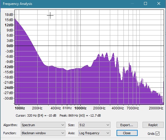

The new USB Soundcard and cables arrived yesterday the soundcard cost a whole £1.50 including postage :-) I did a quick test using the soundcard oscilloscope program and the electronic stethoscope, The program let me save as a wav audio file. I then analyzed the frequencies using the Audacity sound program.
Most of the sound lies between 1500 and 8000hz which probably explains why most of the knock sensors wouldn't work for Tyler as from info on the web it seems most older style knock sensors are tuned to narow frequency band around 10,000 to 11,000 hz.

Andy.MacFadyen wrote: Most of the sound lies between 1500 and 8000hz which probably explains why most of the knock sensors wouldn't work for Tyler as from info on the web it seems most older style knock sensors are tuned to narow frequency band around 10,000 to 11,000 hz.
Nice! :ohmy: I just figured they were failed knock sensors, but this explanation makes much more sense. :lol:
Would the frequency of the knock sensor required vary based on the engine application? Wondering if the knock sensor I'm using is from a smaller Honda I4, and thus tuned differently than the others that likely came off Nissan and Ford V6's.

I'm glad you said that, 'cause I've had the same issues with getting a good parade pattern. I've found that, on my Modis, the trick is to use a fast timebase (50ms-ish) then zoom out for a good picture. I think the 200ms timebase I had on that Chrysler capture was too slow, and I lost detail because of it. :(

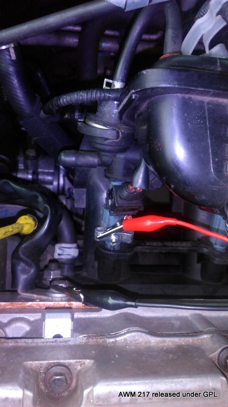

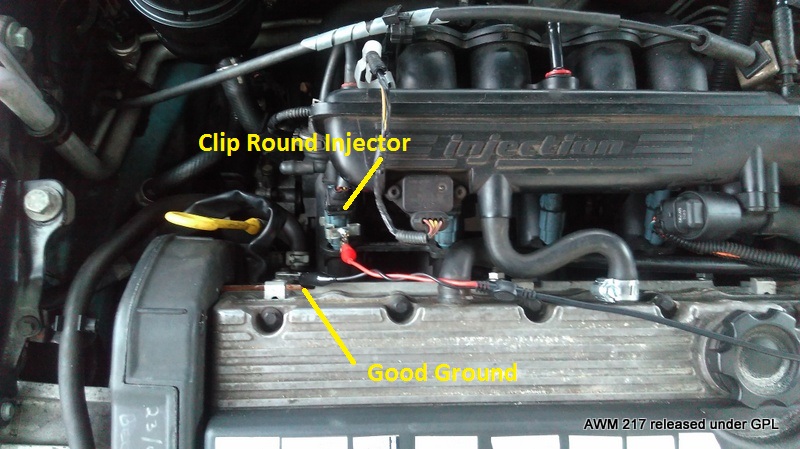

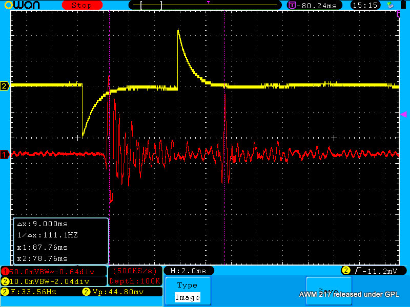

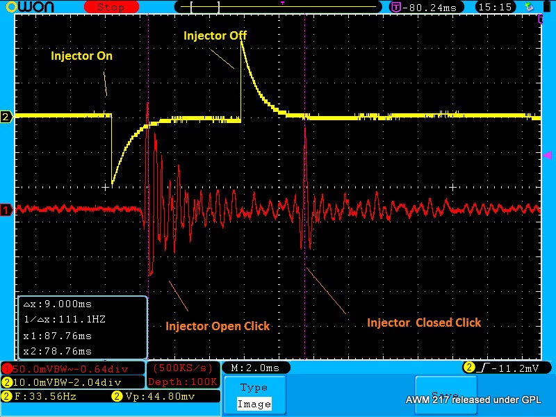

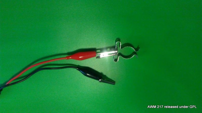

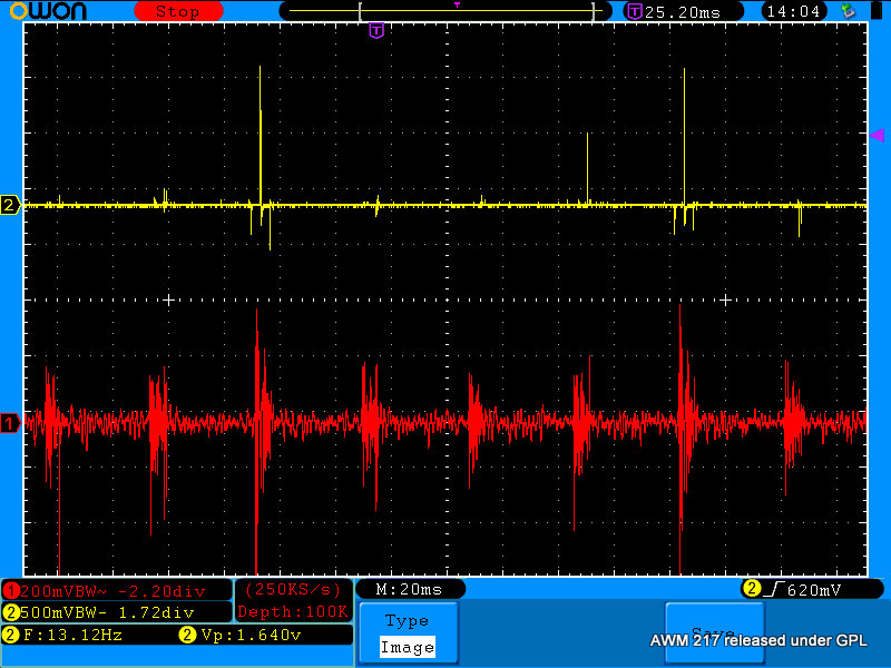

9 years 9 months ago - 9 years 9 months ago #4923 by Andy.MacFadyen
I had an hour or so spare yesterday to continue playing around with this on a bench test, using the £20 electronic stethoscope.
The yellow channel is by capacitive coupling a simple using metal clip round the plastic body of the injector.
Looking at the two signals together is interesting and makes the trace from the electronic stethoscope easier to understand.
Last edit: 9 years 9 months ago by Andy.MacFadyen.
  • Tyler's Avatar Topic Author
9 years 9 months ago #4929 by Tyler
That's beautiful, Andy! :woohoo: It's interesting how this capture seems to show more noise from the injector opening, than from the injector closing. Wondering if injector design plays into this?
Also noticed that the commanded injector on time is around 8ms in this capture, but between the cursors on the stethoscope seems to be closer to 10ms. Great example of how the commanded on time you'll see on the scanner doesn't directly translate to injector open time.
We've been able to see pintle humps in current and voltage waveforms, but this method really illustrates what the pintle is doing when the injector is commanded to open.

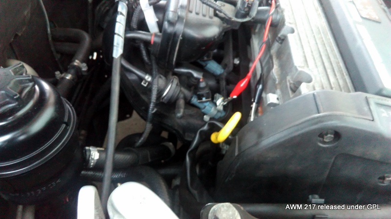

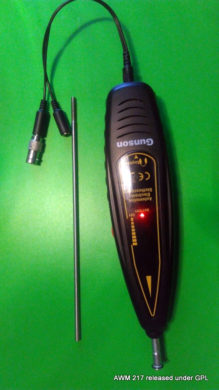

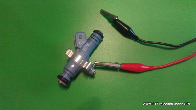

9 years 9 months ago - 9 years 9 months ago #4993 by Andy.MacFadyen
I think I have more or less gone as far as I need to go with this method for anything I am likely to have to deal with.
The scope set up that seems to work is;
Horizontal Time base 20mS/div -- screen time = 0.3 seconds.
Channel 1 (red) Connected to the Gunson Electronic Stethoscope 200mV/divsion
Channel 2 (Yellow) 200mV/div connected indirectly to injector by a capacitive clip this works well with plastic bodied Bosch pencil injector
Trigger from Channel 2 set at 600mV rising.
The Gunson Electronic Stethoscope
Simple t
Tool clip used for capacitive coupling to injector for trigger

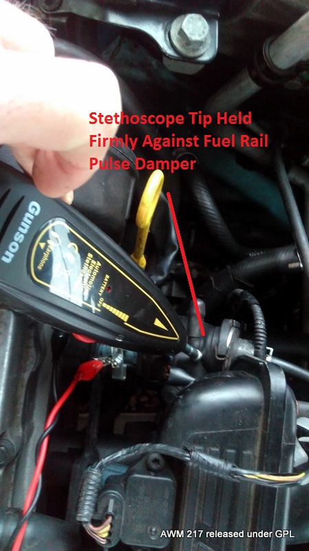

9 years 9 months ago - 9 years 9 months ago #4994 by Andy.MacFadyen
Electronic Stethoscope Held Firmly Against Fuel Rail Pressure Pulse Damper
