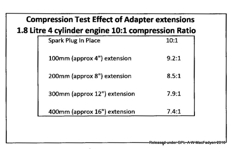

A general issue on measuring compression pressure is that the design of the adaptor between the gauge/sensor and the cylinder can make a big difference. Any volume of air in the pipe between the cylinder and the sensor and the cylinder reduces the effective compression ratio, the stiffness/lack of stiffness of the tube also has a similar effect.
With a cranked compression test with an ordinary compression gauge the position of the Schrader valve in the adaptor is important the closer to the cylinder the Schrader valve is the more accurate the result.

9 years 11 months ago - 9 years 11 months ago #3397 by Andy.MacFadyen
Replied by Andy.MacFadyen on topic Pico scope and scaling
matt.white wrote: Ah ok, so a solid brass push in adaptor might show 175 where as a wps500 on a rubber hose may show 10psi less. Hadn't considered that.
Yes --- especially with modern high compression engines it didn't matter much with Flathead engines which were about 7:1 compression ratio , my own car is a 10.5 and GDI's are going over 11:1
I crunched some numbers on MS Excel for a 1.8 4 cylinder engine 450cc per cylinder with a 10:1 compression ratio.
I will do a calculation in PSI & Bar but I will need to revise the maths first. :silly:
