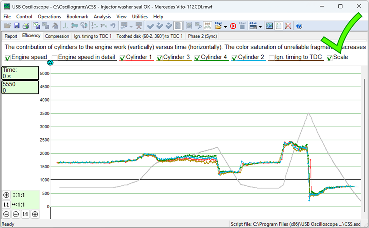

2. CSS script - Cylinder power balance test
This test is simple and fast, without disassembling the engine and its systems, it identifies cylinders that are misfiring and indicates the area of origin of the malfunction.
The express diagnostics time does not exceed 3-5 minutes.

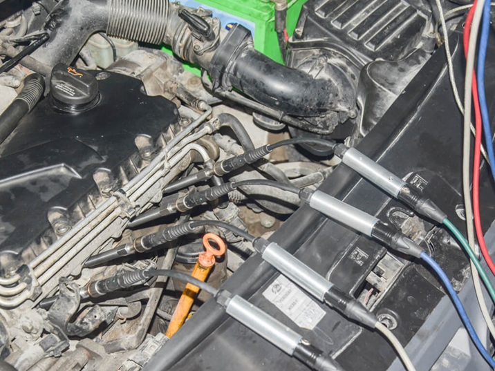

To test the CSS of modern cars, signals from the crankshaft position sensor and the injector control pulse are required.
There are two types of crankshaft position sensor: Hall sensor and inductive.
The injector control pulse can be measured using the CTi-50 current clamps. In a short time, you can check:
Figure 5. On this car, a wrong sealing washer was installed under the injector after repair. The first cylinder was misfiring.
Figure 6. On this car, the connecting rod of the third cylinder was bent due to a hydraulic shock. The contribution of this cylinder in some modes was very low
Figure 7. Diesel engine operation after high-quality repair. Cylinder contribution/balance at different engine speeds is almost the same.

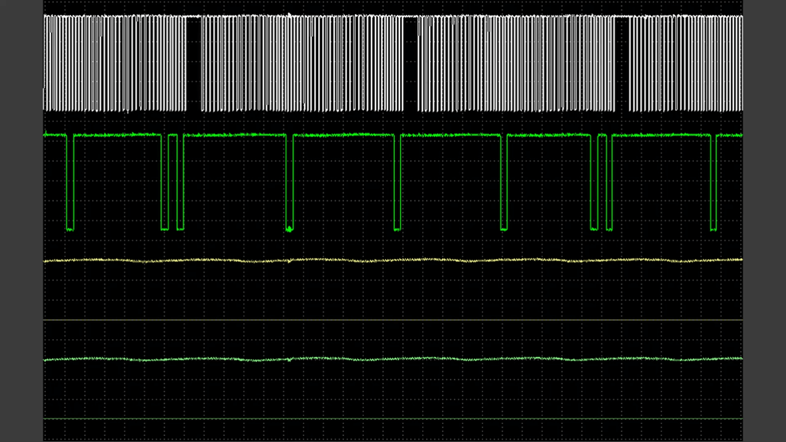

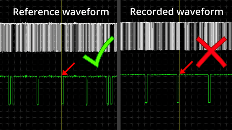

3. Testing the engine synchronization between Camshaft and Crankshaft sensors and diagnosing engine valve timingThese measurements are necessary if the engine cannot be started. These are the main signals for the control unit of a modern car.
The presence of these signals and their correct synchronization are the main ones for the ECU in controlling the fuel injection pulse. Video
In many manuals, manufacturers provide reference signals for each specific engine. Some of this information is on the website:

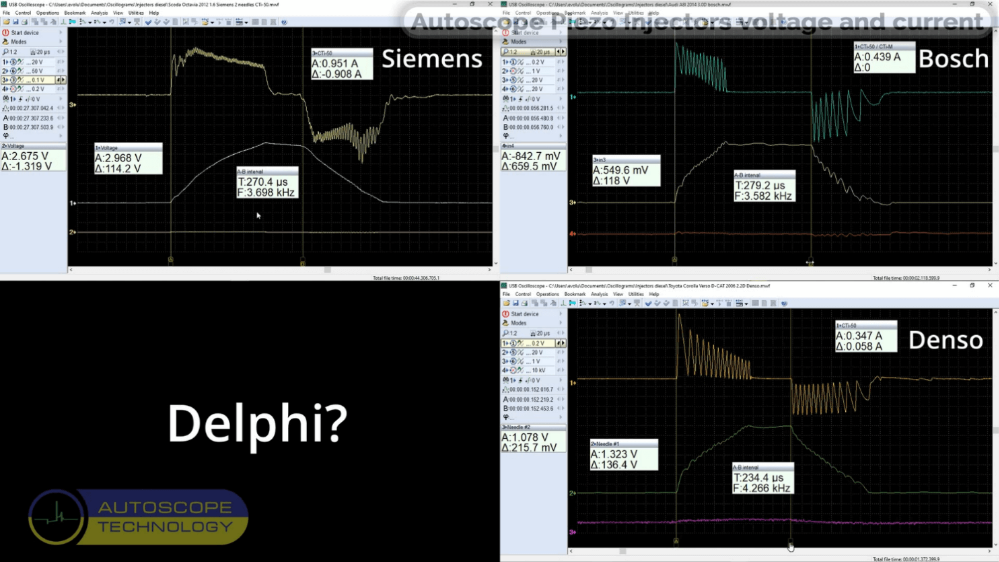

The duration of the injection pulse can be used for estimation the injection corrections in the control unit.
Here are shown the control signals of faulty injectors.
It is clear that there is a correction for fuel injection (different pulse durations). Control signal after replacement with new injectors. Minimal signal correction.

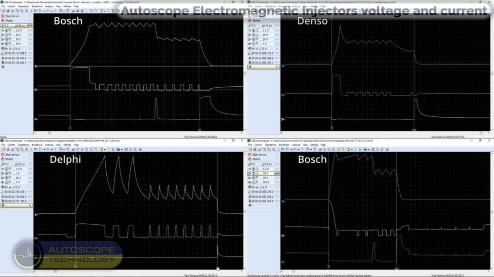

Control pulses of injector manufacturers Bosch, Denso, Delphi:
Figure 14. Example of the waveform of electromagnetic injectors
Video
Figure 15. Example of the waveform of piezo injectors
Video
Figure 8. Crankshaft sensor & Camshaft sensor signals
Both Crankshaft sensor and Camshaft sensor signals are present. There is no control of the fuel injectors.The presence of these signals and their correct synchronization are the main ones for the ECU in controlling the fuel injection pulse. Video

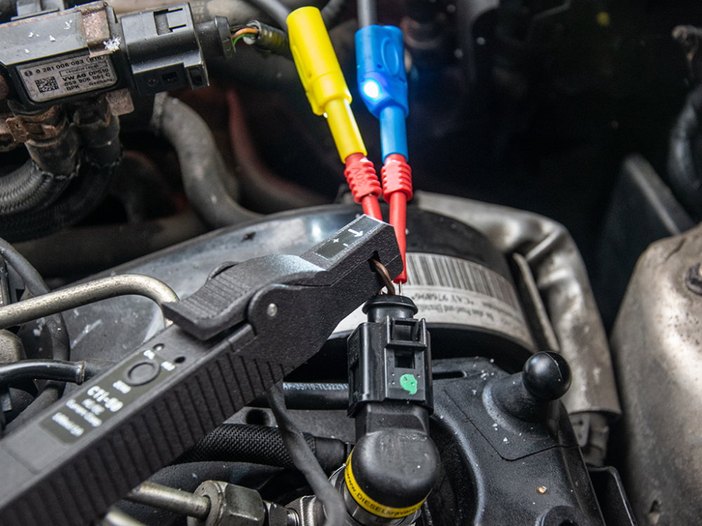

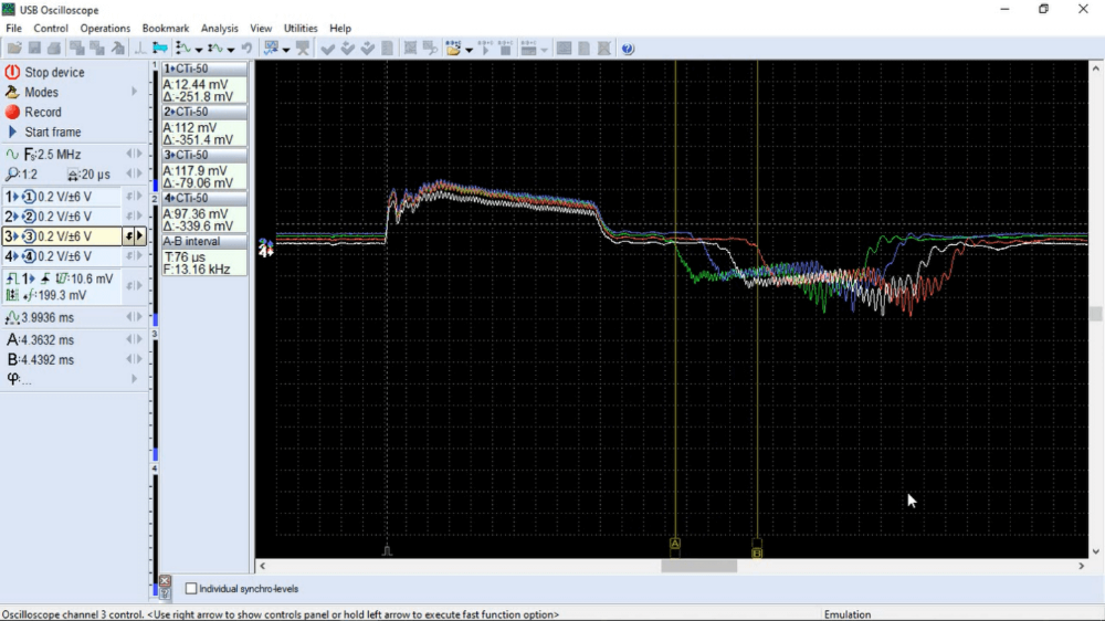

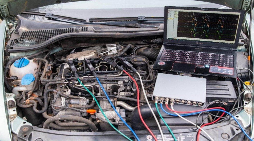

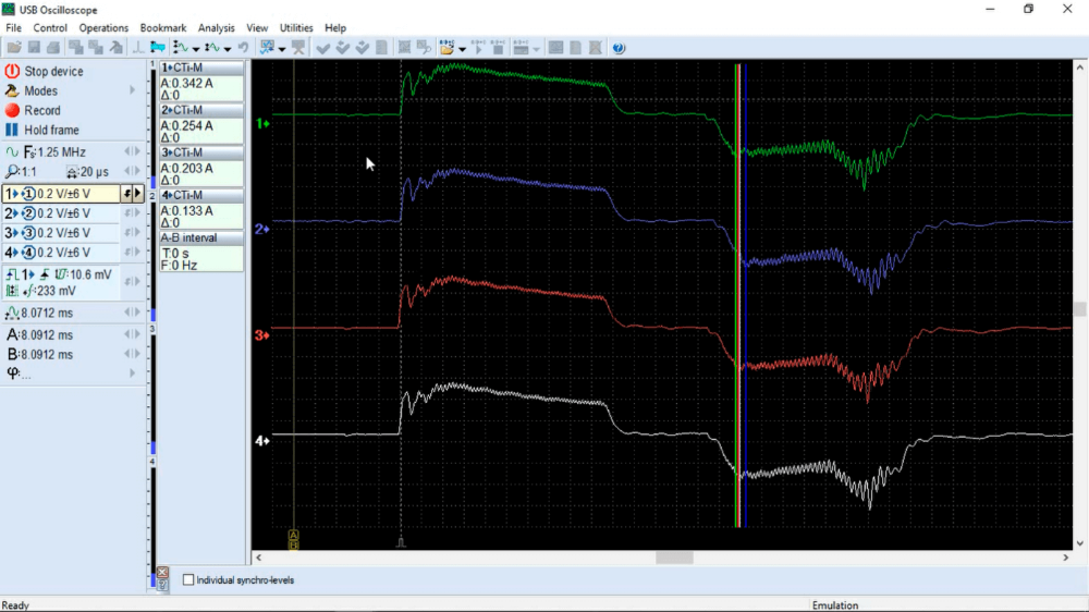

4. Diagnostics of electromagnetic injectors (piezo injectors) using the CTi-50 current clamp
This information is useful in case of replacement (or repair) of diesel injectors and their reprogramming. To do this, it is necessary to attach
to the control pulse wire on the injector connector.
It should be noted that the design of the measuring part of the CTi-50 current transducer is specially made for such measurements.
Video
Video
Video

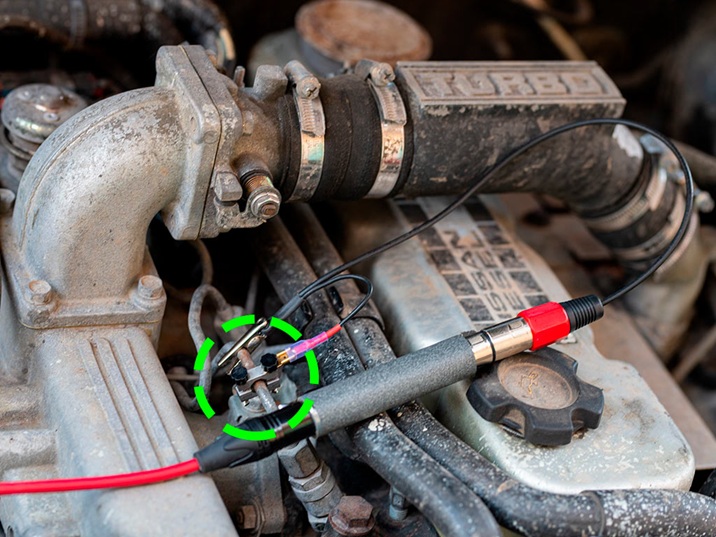

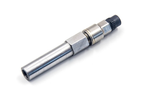

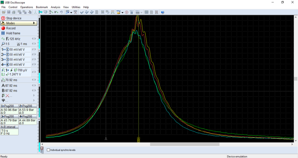

5. Engine diagnostics based on the cylinder pressure graph using the PSG200 diesel pressure sensor
The pressure graph in the cylinders of a running diesel engine was, until recently, impossible for service center technicians. Standard pressure sensors are not designed for such measurements. A solution to this problem was proposed by BERU. They developed new glow plugs with built-in PSG pressure sensors.
Figure 16. PSG200 diesel pressure sensor
PSG200 pressure sensor
waveforms provide valuable data for identifying complex faults in diesel engines. In addition, they help technicians gain a deeper understanding of the processes occurring in the engine cylinder, which allows for faster and more accurate diagnostics. Using four diesel engine pressure sensors allows estimating the contribution / balance of all cylinders simultaneously. The resulting pressure graphs contain information about the combustion process of the fuel mixture, which depends on:
- Engine temperature
- Compression ratio
- Compression
- Fuel atomization quality
- Correct positioning of the injector nozzle in the combustion chamber
Figure 17. Connecting pressure sensors instead of glow plugs
Each sensor must have its own amplifier.
Article
about the examples of diesel pressure transducer use.As a result, technician has the opportunity to see and compare pressure graphs in the cylinders of a running engine.
Figure 18. Graph of pressure in the cylinders of a running engine

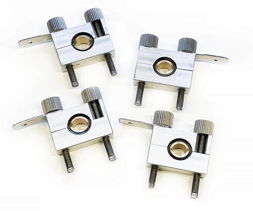

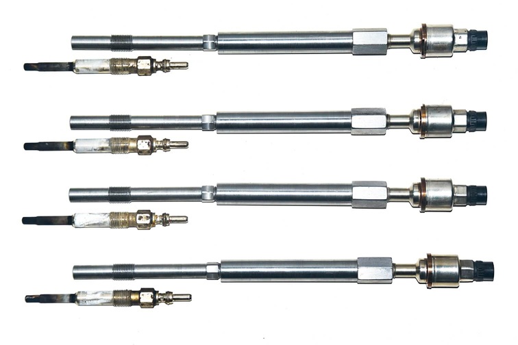

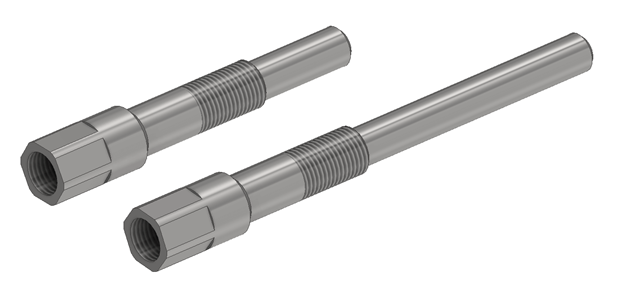

6. Adapters for the pressure sensor PSG200
To work with the pressure sensor, it is necessary to use special adapters:
Figure 19. Special adapters for PSG200 pressure sensor
These
adapters
must be installed in place of the glow plugs.
Figure 20. Adapters for diesel pressure sensor
For a high-quality analysis of the pressure graph, it is necessary to install the sensor as close as possible to the combustion chamber. Please Log in or Create an account to join the conversation.

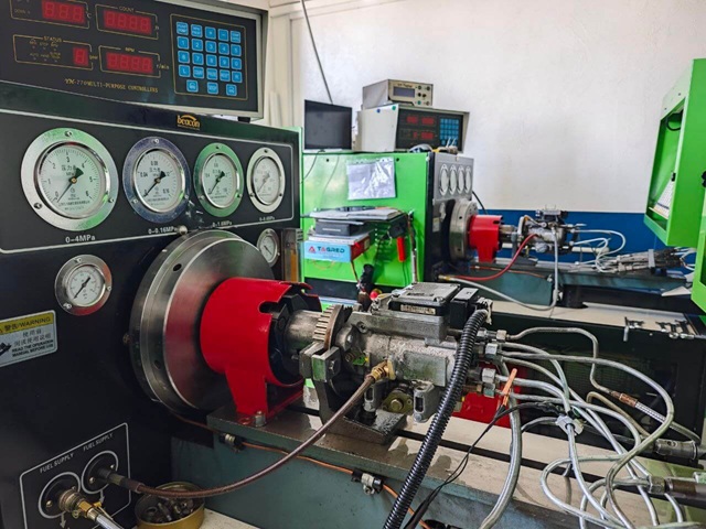

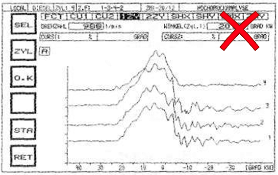

7. Diagnostics of diesel injection systems with a mechanical high-pressure fuel pump using clamp-on PD-6 piezo transducer
Figure 21. PD-6 piezo transducers
The
PD-6 sensor
is designed for installation on the high-pressure fuel line of diesel engines with a diameter of 6 mm, the injectors of which are not equipped with electronic control.

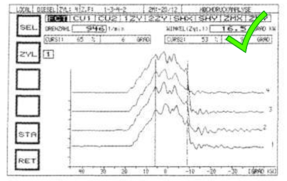

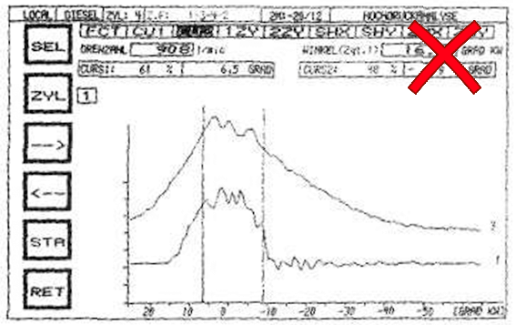

By the nature of the fuel injection pulse, it is possible to evaluate:

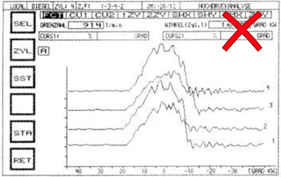

Figure 23. Injection pressure curves for a four-cylinder swirl-chamber engine with pintle-nozzle injectors (Volkswagen 1.9D): start of injection for all injectors — 6° of crankshaft rotation angle before TDC; end of injection — 9° of crankshaft rotation angle after TDC; injection duration — 15° of crankshaft rotation angle
Figure 24. Reducing the injector opening pressure from 130 to 100 bar in the third cylinder
Figure 25. Insufficient sealing of the injection sprayer in the fourth cylinder
Figure 26. The delivery valve in the fuel equipment of the third cylinder is leaking, the residual pressure is zero

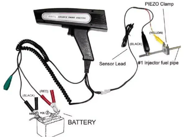

3. Using the PD-6 sensor for the operation of diesel stroboscopes.
This information is necessary for correct fuel injection timing using Diesel timing analyzer. 4. Using PD-6 piezoelectric transducers on diesel test benches during repairs and adjustments of high-pressure fuel pumps Conclusion
- condition of fuel injection sprayers
- condition of fuel injection pump delivery valve
- volume of fuel of the main injection and mechanical pre-injection
