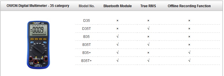

Is there a difference between the B35 and the B35 t?
I can get a B35 for under $50 online.
I was getting straight zeros on every fuse. I thought I found it early on on the cigar lighter fuse, but the fuse was blown. So I was just reading difference in potential.
  • Tyler's Avatar Topic Author
9 years 6 months ago #5385 by Tyler
Replied by Tyler on topic Looking for some multimeter suggestions
Noah wrote: Is there a difference between the B35 and the B35 t?
The T is for the True RMS function. I had the same confusion when shopping the first time! Luckly, the Owon website makes it clearer:

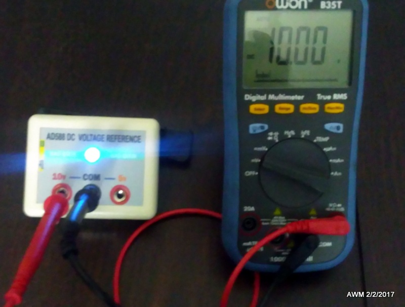

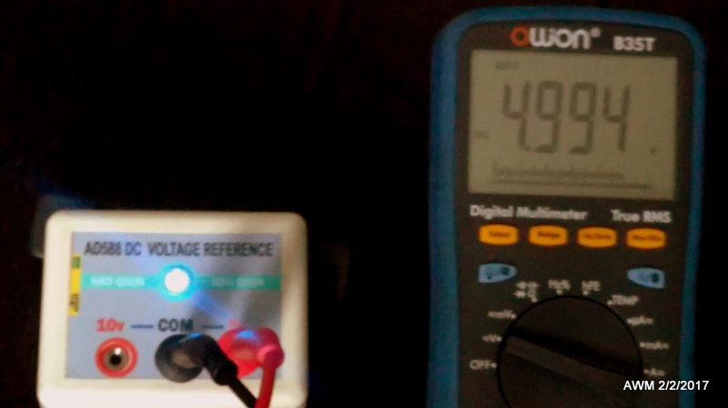

9 years 6 months ago #5390 by Andy.MacFadyen
Replied by Andy.MacFadyen on topic Looking for some multimeter suggestions
Accuarcy on Precision Voltage Source 5 volt and !0 volt

I'm impressed with the accuracy you recorded as well. The Bluetooth function is icing on the cake. I'm sold, got one coming in the mail.
