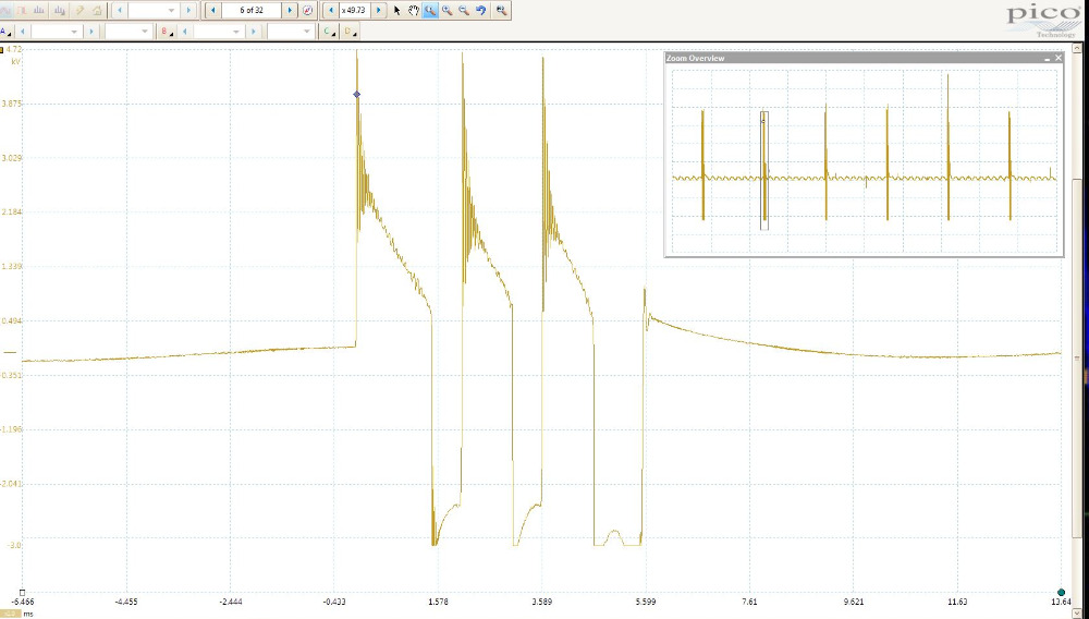

Here is a capture from a Mercury Mariner 3.0L.
On the Automotive Waveform Exchange, on Facebook, you can upload .psdata files. So, I tried to upload the .psdata file to the ScannerDanner Facebook page, but it wouldn't let me.
Does anyone have any suggestions for sharing .psdata files?

graywave wrote: Well when you get a chance Pole let me or us know. Trying to find a probe that is consistent is probably going to be the battle. I know some coils are to heavily shielded and we can hope that most coils will work just fine with certain probes.

Thanks Pole! I think inductive ignition testing is going to be an area I need to concentrate on. I'm so used to getting primary waveforms and understanding them. A capture like that, I start to wonder, what would a fuel misfire or a secondary misfire look like. Now I think it would be slightly different from vehicle to vehicle due to the type of coils and their shielding but I think we can still use the generic understanding of ignition waveforms. it just might be a bit more difficult to pull out the answer.
Thanks for telling me about "The Automotive Waveform Exchange" on FaceBook. I never knew it was there. I joined
If you ever see "Justin Gray" that would be me.
