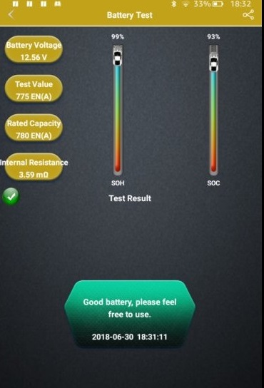

This Android screen capture is the test result on a fully charged Bosch Silver S5 Type 096 Battery (off car).

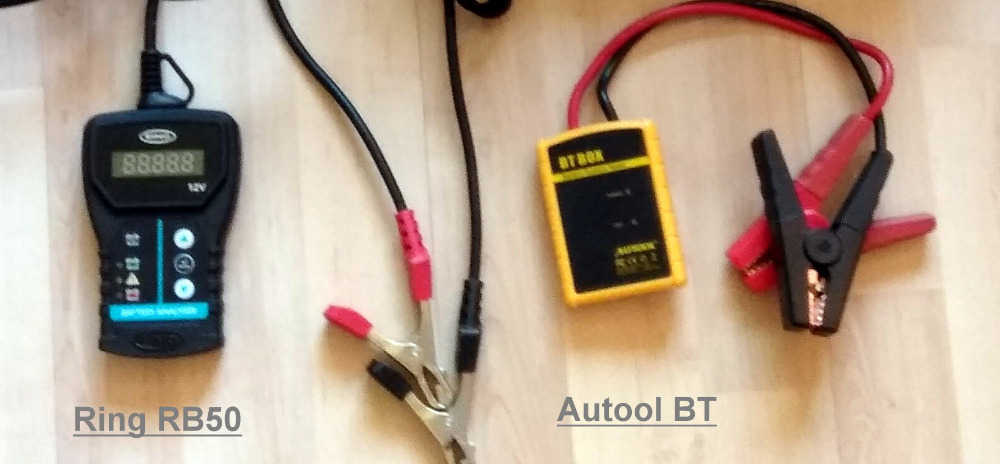

Here is a back to back test on two batteries comparing the results on the Autool BT with my Ring RBA50 ---
Ring RBA50 on Ring UK Website
Batteries used were a 3 year old Bosch Silver Calcium 096 and a Hankook MF56219 Heavy Duty 027 the results were broadly as expected --- the Hankook punches above its' weight
Good points the Autool BT gives fairly consistent battery test results on normal calcium batteries which roughly agree with those from the Ring RBA50, the test results are automatically saved and can be recalled viewed and shared.
With both these tester getting a good clean connection directly to the battery is required for consistent results.
Bad Points: The Autool has additional test, a starting test and charging test and also a remote battery monitor but these additional tests crashed on all my Android devices.The interfaced looked good but the blutooth connection kept dropping out.
Good value for the battery test alone but if buying again I buy a non Blutooth model (BT-360 or BT-460) from the same manufacturer.
