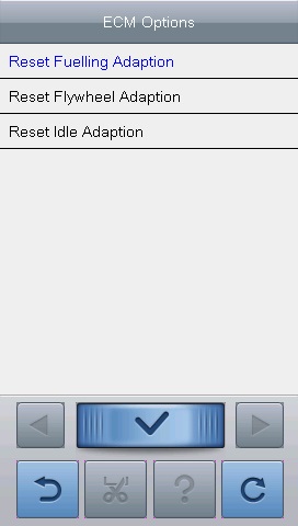

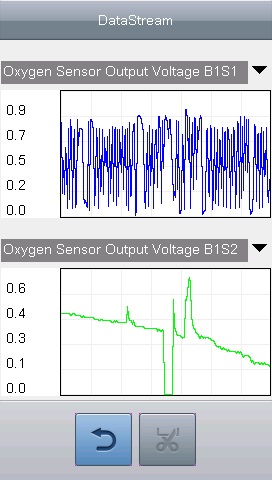

8 years 11 months ago - 8 years 11 months ago #14060
Replied by Andy.MacFadyen on topic Hi from GA
The AET CareCar scantool is ............... really not sure.
I have universal model which came pre-loaded with all the manufacturer modules.
The main reason I have it is I mainly work on MG-Rover which is an orphan brand and has non-existent coverage execpt on the most expensive scantools.
I have only used it on ODB2 ISO 9141-2 , MG-Rover, BMW, Land-Rover Nissan and FIAT modes.
The connecting plug is a very loose fit in the 16 pin socket
Software refuses to update --
OBD2 is a bit iffy connection is a bit hit or miss. OBD2 has two options auto detect protocol then select manufacturer or select manually protocol strangely these produce different data lists. As a result if I want OBD2 I use a cheap Bluetooth dongle.
Graphing works but is very small --- graphs and screens can be saved to SD card.
In manufacturer mode MG-Rover mode works up to a point for example ABS diagnostic usually won't connect and bi-directional control won't work curiously If I connect to an MG ZT telling the scanner the car is Land-Rover Freelander 1.8 bi-directional controls works.
BMW mode seems to work okay at least on the E39 and E46--- I can connect to most but not all modules and alter options.
Nissan Note some bi-directional tests seem to work
FIAT Panda wouldn't really play , it may be needs hardware adaptors as they use an odd pinn-out on the 16 pin plug. #
