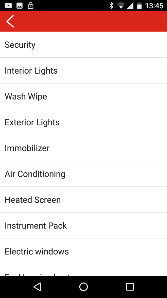

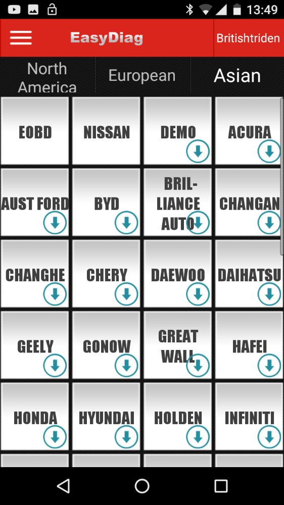

It arrived today software registration was pretty painless although Bluetooth pairing took a few attempts. As soon as the dongle is registered and paired you select the manufacturers modules you want to buy and download.
At this point there is a hidden charge plain as vanilla OBD2/EOBD is charged as a manufacturer I chose the option to choose a bundle of three manufacturers (Rover, Nissan and Renault + OBD2) . There are a huge range of manufacturers to choose from and if you work on cars from really obscure manufacturers such as GAZ or Zotye the Easy Diag 2 is probably the most useful scan tool you will find short of buying a full Launch X431.

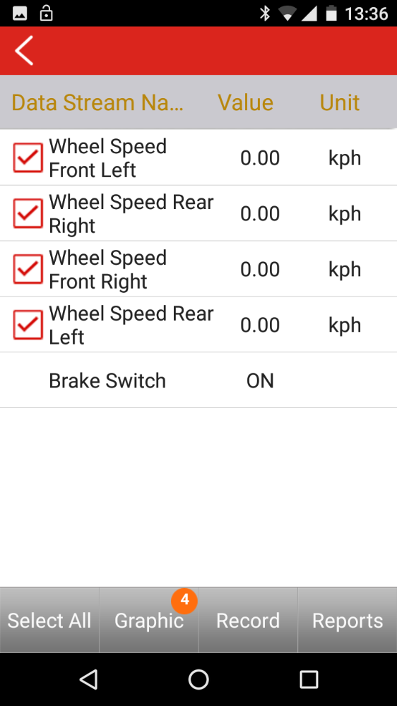

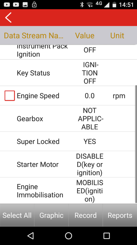

My reason for buying this dongle was do a lot of work on an orphan brand (MG-Rover) that has zero coverage from nearly all scantool manufacturers with the notable exception of Launch who cover it on their X431 but not on the Touch Pro or CRP ranges. In particularly I needed to be able to diagnose the Rover ABS system and to my surprise the module will talk to every module on the vehicle although there is no modules present check so on poverty spec cars modules that aren't fitted are listed.

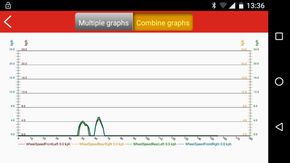

ABS live data works nicely however graphs can't be scaled.

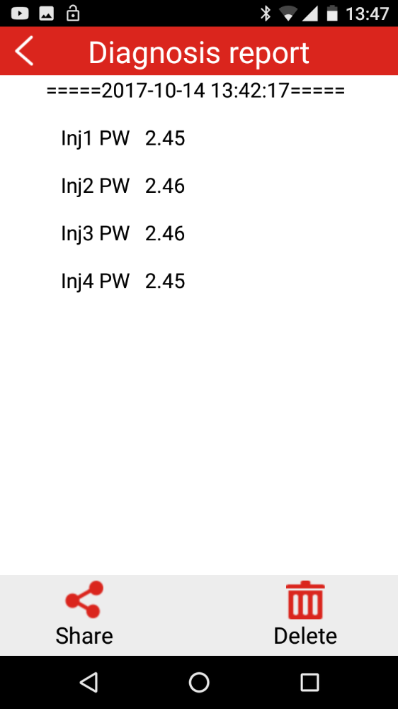

Update --- I have now used this tool on a wider range of vehicles --- I am now seriously impressed only real limitation is the lack of bi-directional control.
