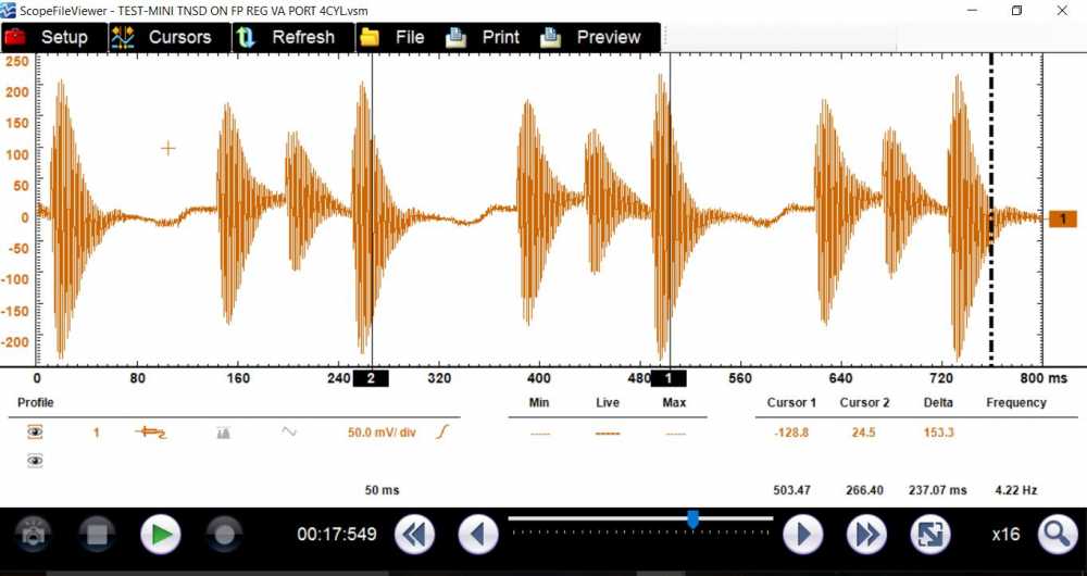

I had used a GM fuel tank pressure sensor to make a low pressure transducer. I have seen you do this in one of your videos a while ago where you tested a 4 cylinder Honda. I have yet to actually test this on a vehicle. I am wondering if this would work on a 6 or 8 cyl vehicle. I am also curious if you would share the scope settings you might use with this test.

A few things, that test that I showed is only valuable when you have a pressure regulator with a vacuum hose on top of it. As far as scope settings I don't remember but I believe that I used the scope set to AC couple. I think it's in the video but I don't have the link offhand and I don't remember which channel it's on sorry

Hey Paul , thanks for the response. I am aware that the regulator needs to have a vacuum supply to it for the test to work, but I am unsure if the test can be used on a v6 or 8 engine. I had attempted to use this test today on my 96 jeep 4.0. However I could not get a pattern on the scope. And this is an inline 6 obviously. I can apply pressure or vacuum to the tool and get a pattern to form on the scope that way. What am I doing wrong?ScannerDanner wrote: A few things, that test that I showed is only valuable when you have a pressure regulator with a vacuum hose on top of it. As far as scope settings I don't remember but I believe that I used the scope set to AC couple. I think it's in the video but I don't have the link offhand and I don't remember which channel it's on sorry

You might need to poke a small pin hole in your hose going to the sensor.
This is taken off my 4 cylinder Acura Integra at the fuel pressure regulator vacuum port and the fuel injector furthest away from the regulator unplugged. I have it set on ac coupling, 50 ms time base and looks like 500 mv scale. I haven't tried with a V type engine.
