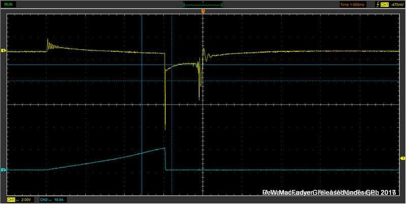

You might also want to consider getting a current clamp as this can give you a very quick and easy way of checking not only the coil but just about every other electrical item on any car.

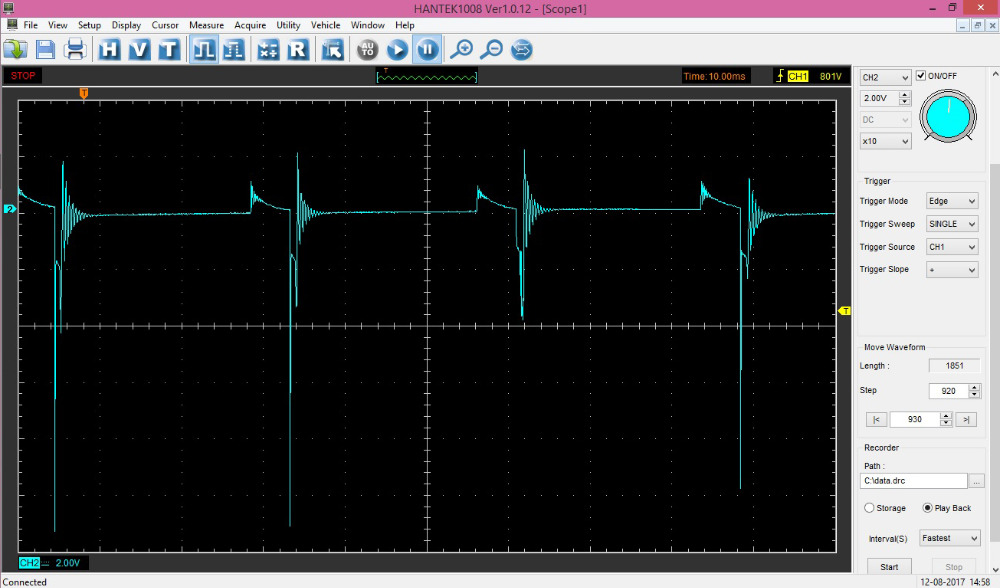

My scope has arrived and I've loaded the software. I now need to hook it up to my car and take some readings. I want to do as you say here: "To get the capture synched to the firing order without buying another DIS probe you would need to connect the DIS probe to #1 cylinder and set that as a trigger and another channel to the ignition primary through a 20:1 attenuator." I think I understand where to connect the DIS probe(#1 plug wire?)But I am not sure where to connect the second probe with the attenuator. Does the second probe get connected to the coil HT wire voltage?
  • pickle
  • pickle's Avatar Topic Author
8 years 10 months ago #11843 by pickle
Forgot to mention ... I have 2 DIS probes.
8 years 10 months ago - 8 years 10 months ago #11853 by Andy.MacFadyen
Replied by Andy.MacFadyen on topic Will the Hantek 1008C show 4 spark traces at once?
Fairly easy to do put a DIS probe on channel 1 and put it on No1 HT plug lead, put the other DIS probe on the HT coil lead. Use No1 as the trigger that way you will get a parade of all for plug wire secondary HT voltages in the firing order on Channel 2.
Setting the trigger voltage is just a matter of dragging the trigger indicator at the edge of the display up or down untill you get a steady waveform displayed after that just alter the Time Base and voltage untill you get a nice parade of secondaryHT voltages.
The voltage waveform for No1 cylinder will look slightly different between Channel 1 and Channel 2 --- that is beause you have a distributer ignition and the spark has to jump from the rotor arm to the segment on the cap.

8 years 10 months ago - 8 years 10 months ago #11873 by Andy.MacFadyen
Okay decent capture --- it is upside down because of the coil primary (12v) polarity I don't know your ignition system but this may or may not be correct for your ignition system modern coils terminnals are marked + and - normally the control (what used to be the contact breaker ) connection is - .
On most oscilloscope scopes you can flip the display over to make inverted patterns easier to under stand -- but not the Hantek 1008
With a ignition parade pattern you look for a cylinder that dosen't fit in with the rest ---- look at the forrest not the trees, in this case one of the cylinders has lower voltage than the other three. This sugest a spark leaking to ground or a bad or fouled plug or the the spark plug gap closed up or low compression there isn't enough detail in the capture to make an informed guess as to which.
What you need to do now is look at the cylinder on it own ---- first capture a good cylinder in closer detail then capture the suspect cylinder with the same the settings.

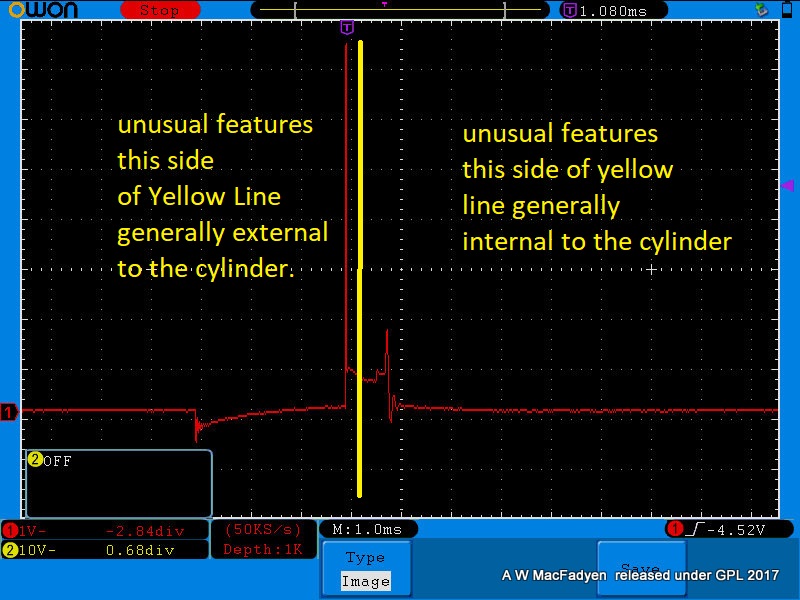

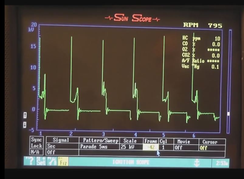

You have got a really useful caputre ---- I download the image and looked at it zoomed in --- it really looks like a spark jump to ground -- distributor cap, plug lead or plug I could only guess at. One other thing I noticed is on the good cylinders the secondary (HT) has a lot of energy left over at the end of the spark --- what spark plug gap are you running ? standard 0.025" (0.625mm) it could be you could open the gap up more.
This picture is the classic "good" spark at normal idle
This is explains some of the features

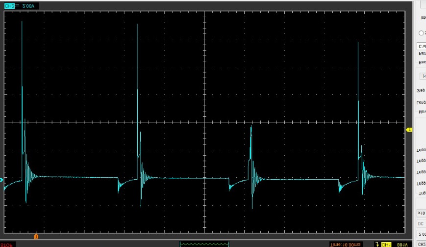

8 years 10 months ago #11880 by Andy.MacFadyen
This is your capture flipped using good old MS Paint

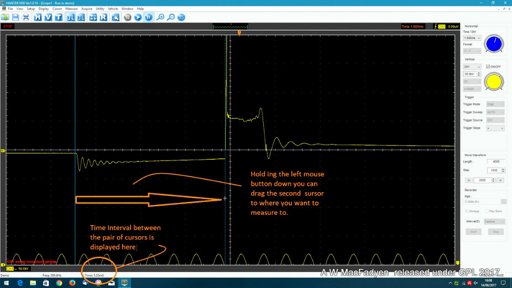

8 years 10 months ago #11949 by Andy.MacFadyen
It should work Okay on windows 8 Hantek software version 1.0.8 works okay on 8 and 10 but won't flip the display.

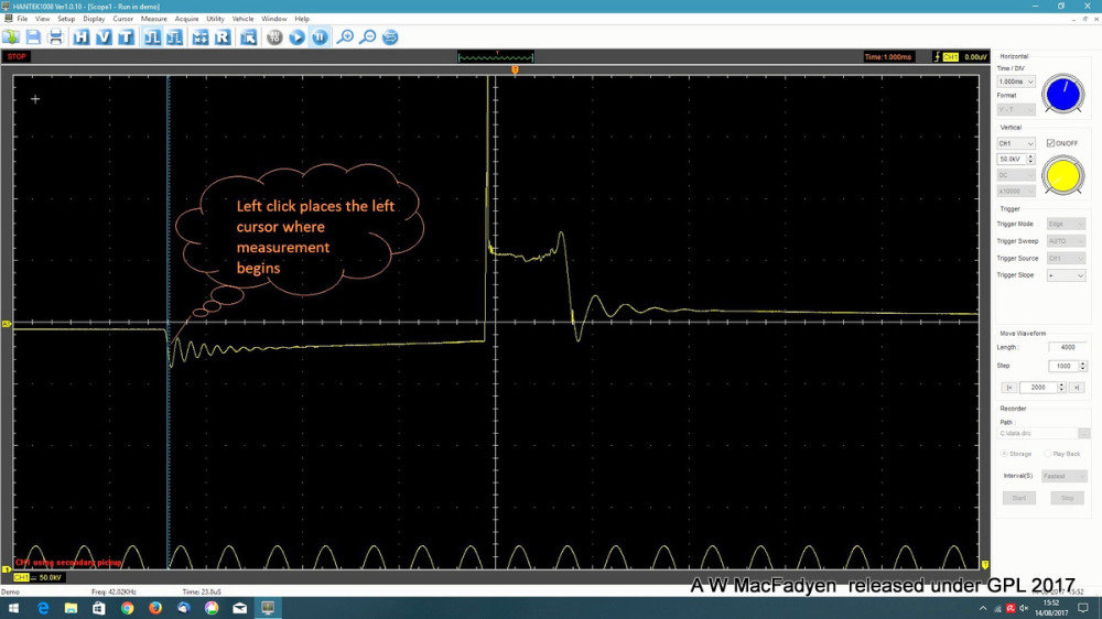

The way to measure Time periods and Voltage differences is to use the cursors This shows how to measure the dwell time, most oscilloscope cursors work in a similar way so if you learn it o the Hantek it will be the same if you ever decide to upgrade.
