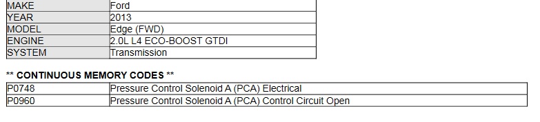

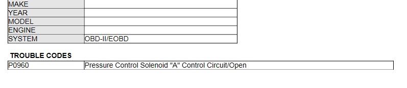

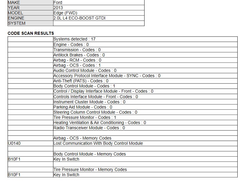

Wanted to survey the Snap-On users around here, see if anyone has had similar issues. The short story is that this 2013 Edge came in with the check engine light on and no running complaints. A Code Scan is run and spits out this:
Hmmmmm, nothing here to explain the CEL.
The PCM doesn't turn that light on arbitrarily... I try Global next.
Ah hah! That'd explain the light. Now I try going into the Trans module directly on the OE side.
The Code Scan completely missed these hard faults.
Anyone else been here?

Wow haven't had that problem yet what software version are you running?
- Thank you received: 1552
9 years 5 months ago #9987
Replied by Tyler on topic Re:Snap-On Code Scan issues
Ah yeah, shoulda included that. 16.4.
