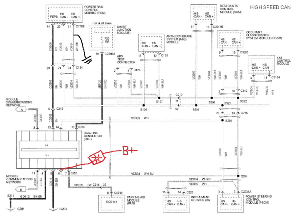

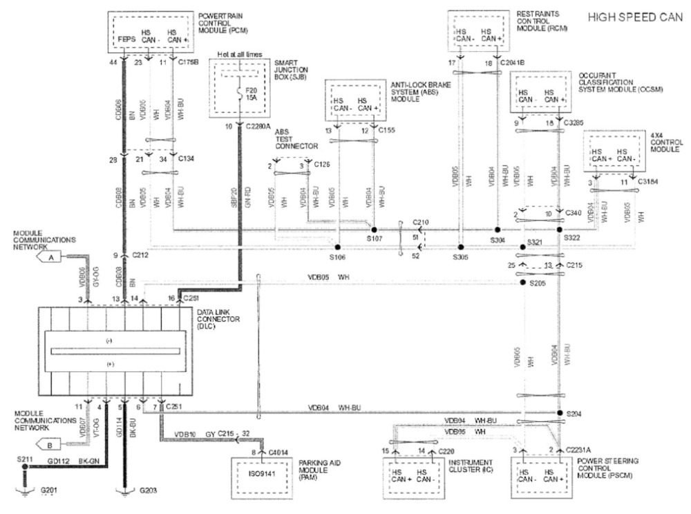

So, I finally got around to testing this out on one of my own vehicles. :cheer: The results were... surprising? For reference, this is the network diagram for this particular '08 Escape:

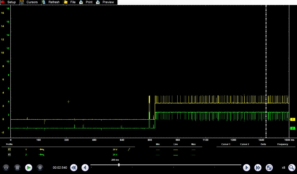

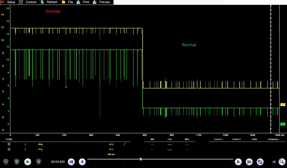

First up, using an incandescent test light at the DLC. This test supposes that you're poking at the connector, looking for power/ground, and touch one of the CAN pins on accident. Will the network survive? :ohmy: These captures were taken at the DLC, with yellow showing CAN+ and green showing CAN-.
Test light to B-:
Test light to B+:
You can tell that the network nodes are still trying to create signals in both cases, but the test light definitely pulls the voltage high and low. Both result in a no crank and no communication with anything, but goes back to normal after disconnecting the test light. U0100 sets in every module afterwards. No magic smoke yet! :cheer:

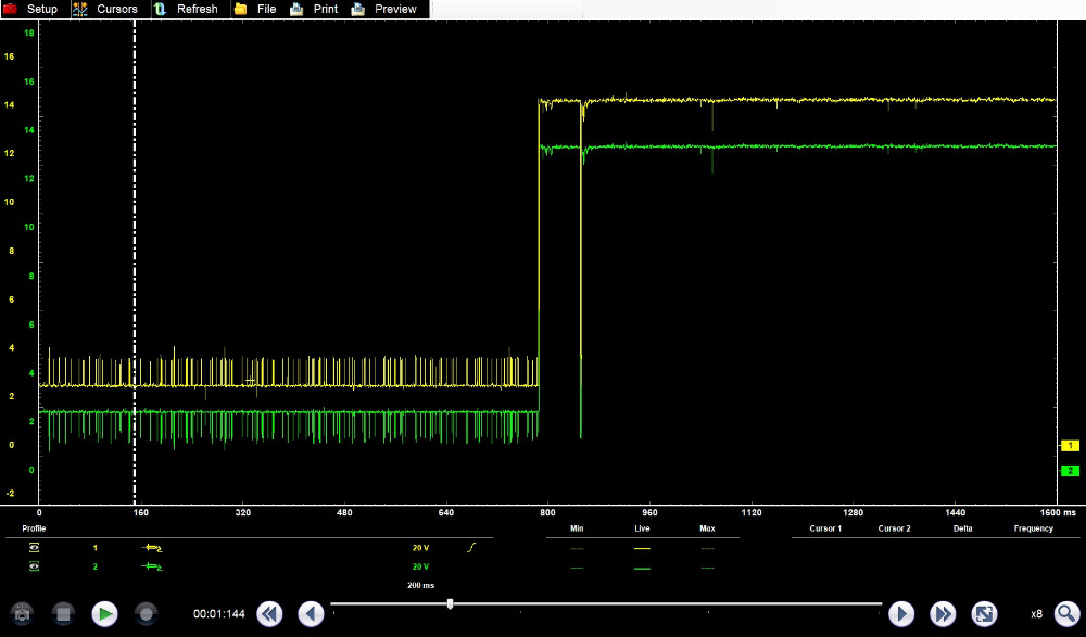

Next step, direct short to power and ground at the DLC. This is the kind of thing that might happen if someone gets too trigger happy with a Power Probe, OR wiring harness damage results in wires shorted to each other.
Jumper wire to B-:
Jumper wire to B+:
Yep, that sure as hell shorted them! Same symptoms, same no crank as before. Remove the short, and everything goes back to it's regularly scheduled programming. For giggles, I also tried applying the short with the engine running; the dashboard lit every light available but kept running. :woohoo:

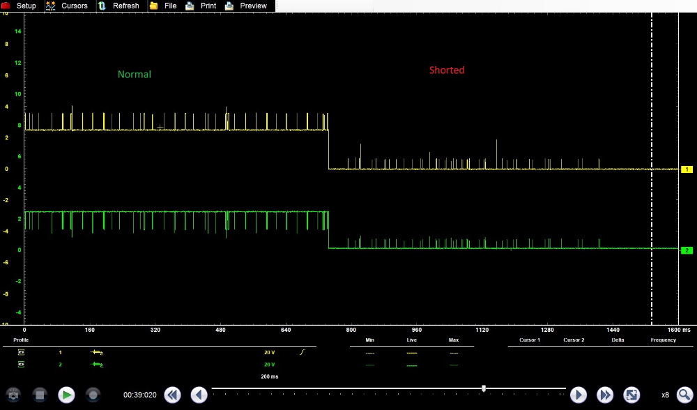

Now we get to what I've been wanting to try - using a test light on a shorted network. :silly: To be honest, I had my doubts about this one. Making the network carry current it's not designed for... If any modules are getting fried, it's with this test.
To be clear about how I'm set up, I added to sketches to the network diagram,

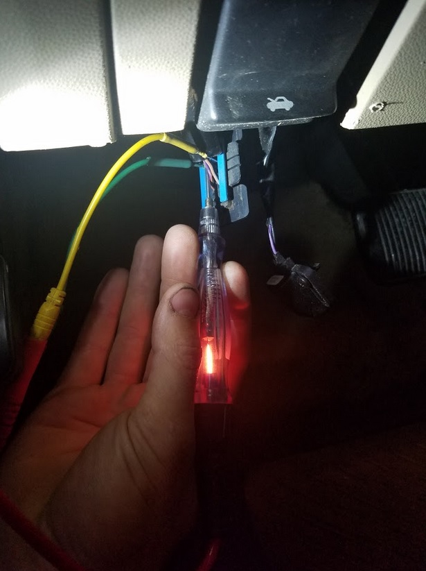

Make sense? I take a deep breath and apply the test light...

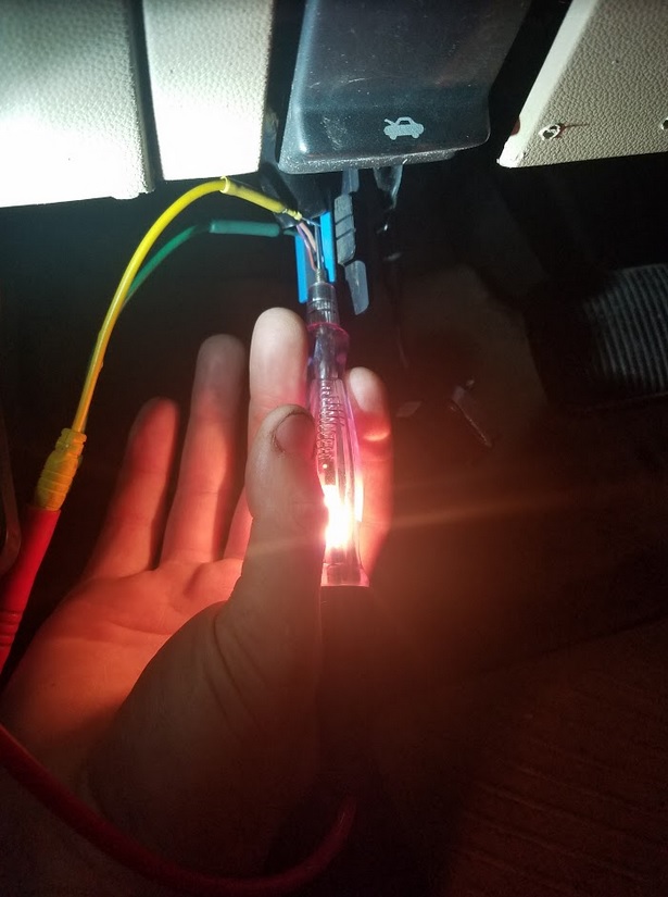

Shining bright. Take the light off, and all is well with the network. All modules communicate, waveform looks textbook. It's like it never happened. B) The really interesting part is what happened when I decided to leave the short on CAN+ and touch the test light on the CAN- pin at the DLC:
About half brightness. :huh: If I'm thinking about this right, then the only way this could happen is if current went through the CAN- wiring, through the PCM node, and found the short to ground on the CAN+ wire. :ohmy: That bulb draws 150mA at full brightness, so we can figure 75-100mA is going through that node.
CONCLUSION: Can you use a test light on a CAN network safely? Maybe! My Escape is no worse for it, anyway. :cheer:
