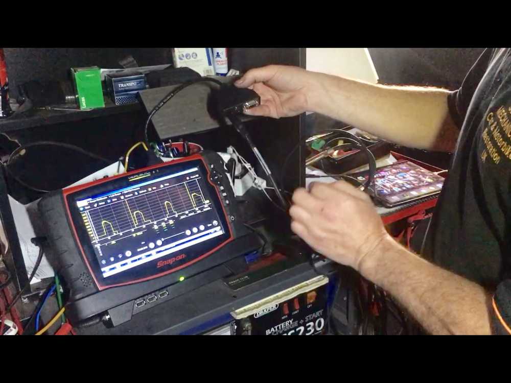

Having watched a number of the ScannerDanner videos on Youtube where Paul gets out the Fluke PV350, I’ve grown increasingly envious of him being able to see cylinder pressures in real time and comparing them to spark plug firing times.
I’ve looked around at the prices for the Fluke (£200) or the Snap-On (couldn’t find it on their website, but I probably couldn’t afford it anyway).
Attached below is a .PDF with instructions, pictures and links to parts. If you can solder up three wires and buy a few bits from Ebay you can build this in ten minutes.

Well done paul nice set up and very cheep
Good PDF file keep sharing
Picture of snap on cable at 5 times the price

I just finished making mine from 450psi transducers we use on our ac systems on the busses. I decided to have mine powered off of the USB port. And I put a 500ma fuse inline on the 5v ref wire to protect the Verus. I just got done testing it by connecting it to the high side of the ac system and then monitoring pressure on the Verus. Seems to work great
