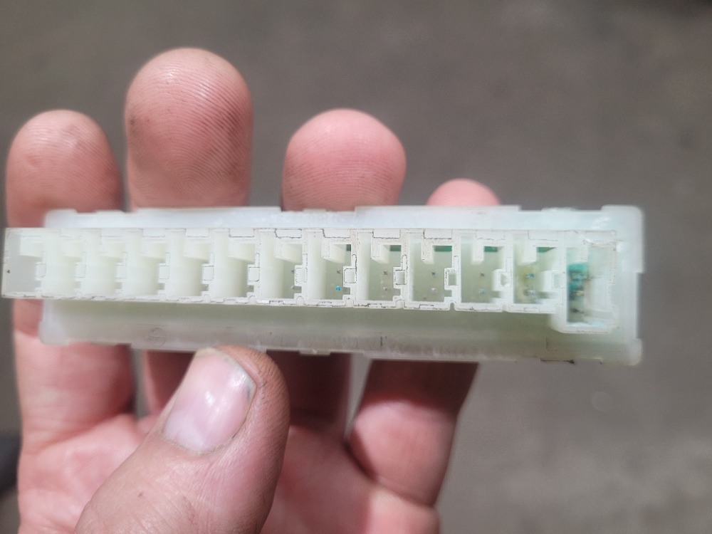

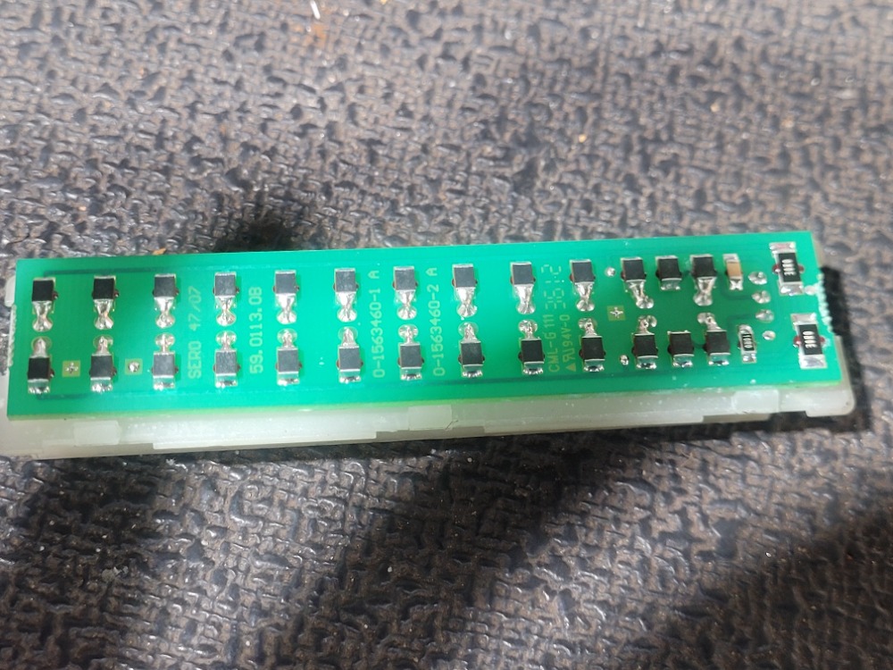

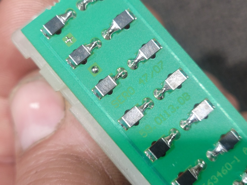

So this is just to tickle my curiosity. This is a pic of a can high splice, or bus bar out of a mercedes glk. So after taking it apart I see some resisters(I think?). I'm not the best with internal circuitry but I had always thought these were essentially a simple bus bar to splice the network up.
Anyone have any idea what those are/what their purpose is?

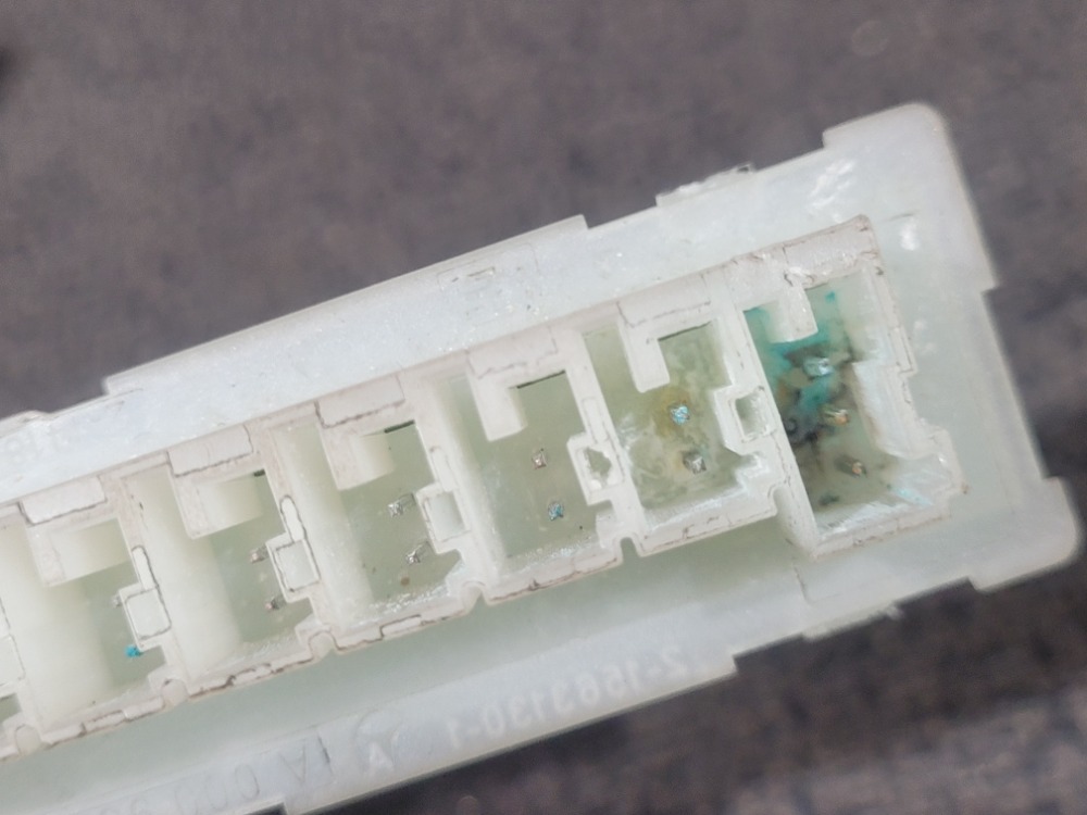

Obviously the corrosion was the issue with this one(no crank, no start, no comm with steering lock module and tcm)
Have a great day!
Tim
Anyone know the purpose of these guys?
Have a great day!
Tim

Out of curiosity, how many ohms of resistance?
