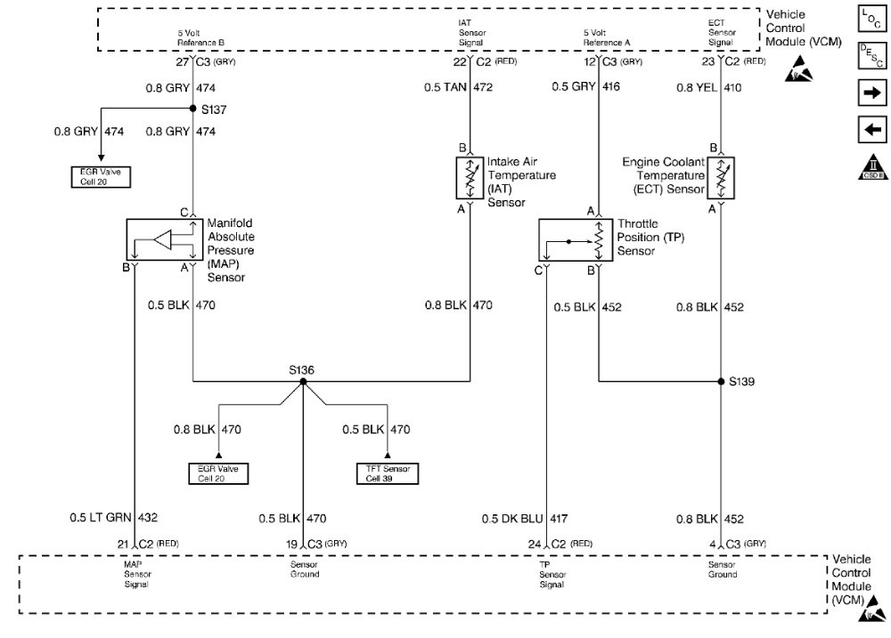

White connector at ECM #27 Grey wire = 5V Ref. back pin actual = 12V

Your reading of 12 volts at the VCM Connector 3 terminal #27 does not jive with the 5 volts you said you got at the MAP and EGR. Are you sure you were on the gray wire at the VCM?
i.imgur.com/bRniQ3O.png

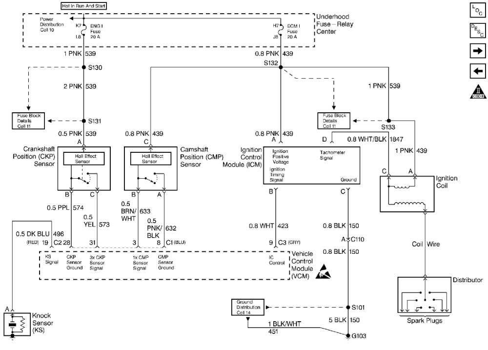

Noticed Ignition voltage 1 low when cranking on MATCO Determinator Scan Tool.
Do a voltage drop test on this Pink wire referenced to B+, while cranking at connector 1 of the VCM pin 4.
5 years 1 month ago #51419 by jreardon
Can see test light flicker at Ign Control Mod and at Coil signal wire.
I have noticed spark out of coil wire come and go on two different occasions. No spark now.
Do you still have signal to ICM on the white wire, while it's a no spark? If you do, how's power and ground?

jreardon has you pointed in the right direction. To state the obvious, you have to have constant spark to get the engine running.
Start at the easiest point. The coil and work your way back along the signal path. No spark on the coil wire, move to the coil. Re check the pink wire for 12v then check the white black wire for a pulse signal. You need a scope but a test light will make due. Your test light should pulse, if not move to the ICM. Again check the pink wire at the ICM for 12v and a pulse signal on the W/B wire. If no pulse move to the White wire and check for pulse. Then to the VCM and again check the white wire for a pulse.
If no pulse from the VCM move to the crank, cam and knock sensor. The pink wire is again the power source for the cam and crank. The yellow is crank sig and the BR/WT is the cam sig.
You may know all this but assuming makes diagnosing harder. If you follow a path from your testing you're more likely to find the problem without throwing parts at it.
Let us know your progress. We all want your van running.
5 years 1 month ago #51465 by Mitch
With a volt meter at C1 pin 4, (pink wire), and another volt meter at pink wire at coil connector. With key on there is 12 volts at each meter. While cranking, voltage drops to 5 at both meters. Butt connected a new 14 ga. wire at C1 pin 4 wire and at coil connector. Same result. Why is the ECM going from 12 volts to 5 volts while cranking?

5 years 1 month ago #51469 by jreardon
What's battery voltage while cranking? It should be about 9-10v on a healthy battery.
5 years 1 month ago #51470 by Mitch
Battery voltage is good. I have kept charger on. Battery voltage also good at fuse block.
5 years 1 month ago - 5 years 1 month ago #51471 by jreardon
THe meter reads difference in potential. So if you place one lead (doesn't matter which end) on B+ and another lead on the pink wire (yes, another B+), crank it over, and you have something low (zero being perfect which doesn't exist), like 100 mV or .1V, that's a good wire (ignore the negative sign).
What do you get?
Last edit: 5 years 1 month ago by jreardon.
5 years 1 month ago #51474 by Mitch
Meter on mV, one lead at battery positive post, the other lead at Blue C1 connector at ECM pin 4 wire. With key off meter reads OL. While cranking meter reads OL
5 years 1 month ago #51475 by jreardon
Put meter on highest scale.
5 years 1 month ago #51476 by Mitch
Meter on mV, one lead at battery positive post, the other lead at Blue C1 connector at ECM pin 4 wire. With key off meter reads 11.4. With key on meter reads .85. While cranking meter reads flashes between OL and 3.4 ish.
5 years 1 month ago #51477 by jreardon
Put meter in volts DC, not mV. Your meter's saying OL because the value it's reporting is probably much higher.
5 years 1 month ago #51478 by Mitch
Meter on Volts DC, one lead at battery positive post, the other lead at Blue C1 connector at ECM pin 4 wire. With key off meter reads 11.4. With key on meter reads .85. While cranking meter flashes between OL and 3.4 ish.
I apologize, I copied and pasted and did not edit accurately. I need to improve my electrical knowledge. Thank you very much for working with me.
5 years 1 month ago #51479 by jreardon
Okay, somewhere along this wire, or at a splice or connector there may be some corrosion or unwanted resistance. The test you did tells you you're losing 3.4 volts which is bad. Time to split the diagram in half and retest at a location you can easily get to, which is... I don't know where, lol.
5 years 1 month ago #51480 by jreardon
Are your battery cables on tight? Put your meter on battery post, and other meter on the clamp that's on that post and redo test.

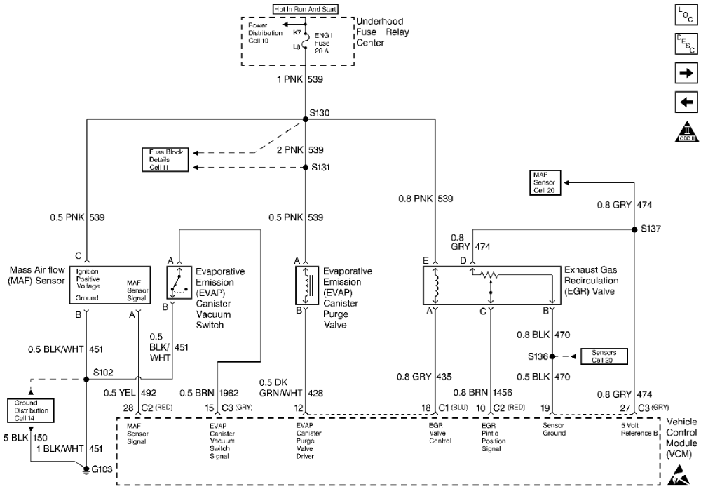

5 years 1 month ago #51481 by VegasJAK
Those pink wires power all the sensors. Could he just unplug one at a time and when voltage jumps to 11.4 he found the resistance?

5 years 1 month ago - 5 years 1 month ago #51483 by jreardon
Mitch said Ignition voltage 1 low. That's pin 4 of C1. Mitch says he's getting 5 volts there. He compared this voltage to the voltage at B+ and he's reporting 3.4 volts of voltage difference during cranking. Mitch, just to be clear, the meter said 3.4 VOLTS right?
