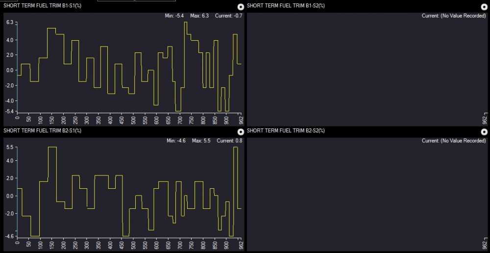

Thread bump! I'm glad you started this thread, scarney, 'cause this question comes up frequently. I was looking at Global data on my Escape for another thread, and caught this:
It seems that the Snap-On scanner is programmed to disregard the downstream O2 fuel trim PIDs. When actually looking at the PIDs on the scanner, it just shows a big fat 'NOT USED' next to those PIDs.
Just posting for anyone else searching in the future.
