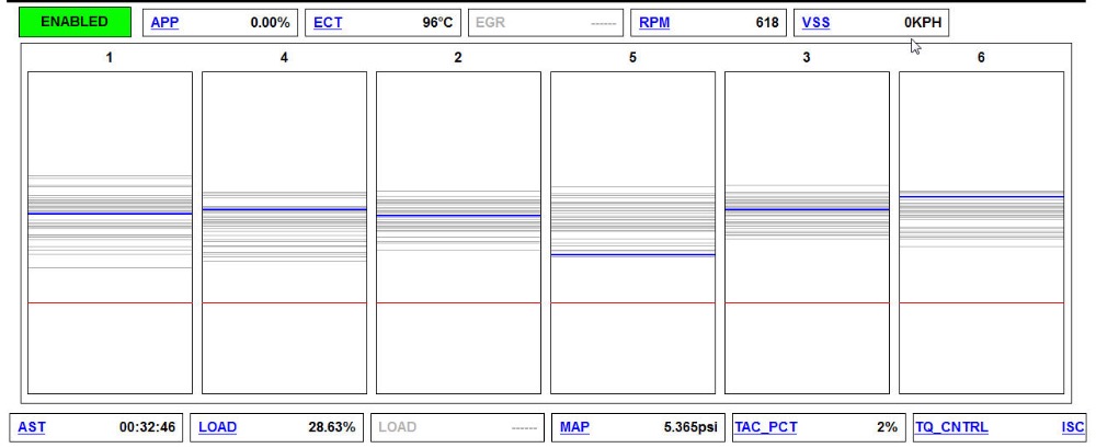

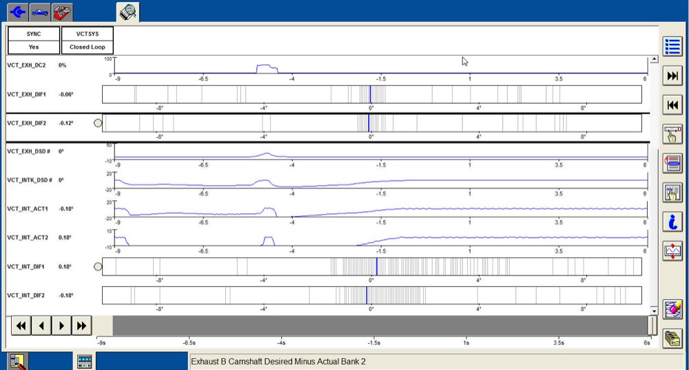

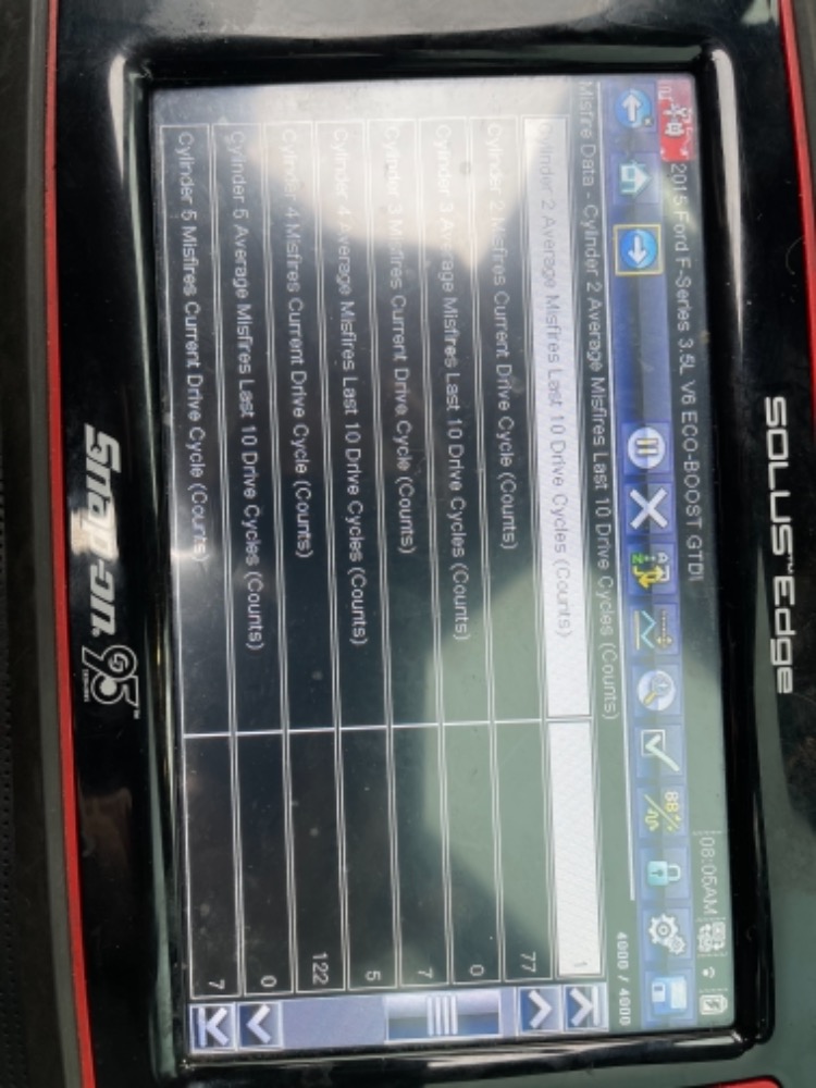

5 years 8 months ago #46912 by Gorgis
Hi everyone thank you for all the reply I just wanted to go over this again
This is a have 2015 ecoboost 110,000kms
It has a rough idle I bought it 3 months ago and it’s driving me nuts it has data misfires on cylinder 4 the most and the others have a few too but only on Data no codes
ive done a lot of things on it injectors , ignition coils , spark plugs , intake with new maps sensors and gaskets cleaned the back of intake valves with walnut blasting and used crc cleaning for the back of the intake valves and as well oxygen sensors .
so far nothing still idles and stumbles while it’s idling I’ve sat in some that are not close to this but mine seems to have a stumble every few seconds
I’ll attach some data picture here .
Thank you so much for everyone for helping
5 years 8 months ago #46915 by Cheryl
Can you do relative compression test and injector flow test since you have ford ids?

5 years 8 months ago #46921 by Tyler
Like Cheryl said, perform the relative compression and injector flow test on the scan tool. That'll narrow down your list of suspects very quickly.
Who changed the spark plugs? What brand was installed?

5 years 8 months ago #46926 by Gorgis
So here are a couple of images of scanner connected to the ignition coil number four and they all seem to do the same where it keeps dropping is this normal?? I’ll included a video

Sorry guys I can’t seem to upload a video so what I did was I took a few screenshots and this is happening every few seconds is this normal
