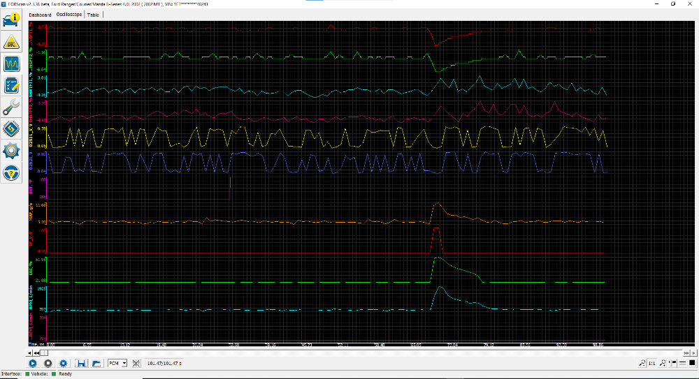

Back to the idle; still feels like it misfires, particularly when in gear at a stoplight. The truck with often stumble quickly, pick up the throttle, then go back to normal. So I feel the whole truck jump a touch. Took the plugs out, inspected, made sure I seating them all correctly. Verified wires were good. Tested coil pack. Found ScannerDanner videos, started watching those. Watched my fuel trims, O2 sensor readings, TPS, IAC, etc. During this process, I noticed the knock sensor wires were exposed, and the only way to replace the knock sensor is to remove the intake manifold (plastic, with O rings to seal). Ordered a new knock sensor, replaced O rings on manifold. The misfire count doesn't jump up anymore like it was doing (when I noticed the wires, they were actually touching each other). But it still stumbles/misfires at idle. As soon as I get off idle, it feels great.
Watched another video today, then went out and got some readings. I watched the IAC position, TPS voltage, RPM, desired RPM. The computer wasn't able to get the RPM to match the desired RPM. It commanded around 700, but the idle was sitting up around 800-900, with the IAC down around 21-22%. TPS voltage was at 0.95V. LTFT at idle is typically -9 to -12, both banks.
From what I've read, and watched, it seems like it could be a vacuum leak. But I cannot find the culprit. Very open to suggestions. (inspecting the throttle plate screw, it doesn't appear that it's been adjusted before)

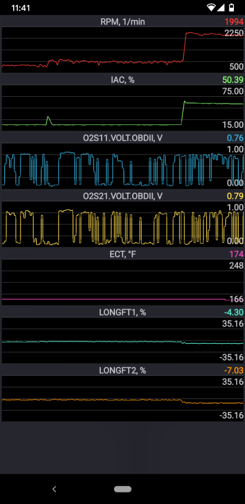

5 years 1 month ago - 5 years 1 month ago #46585 by Speedwagon
Replied by Speedwagon on topic 2002 Ranger 4.0 idle
DougS wrote: Speedwagon,
Did you note your fuel trims at idle and again at 2000 RPM or so? What were they and were they reading Positive or Negative?
Thanks,
DougS
At idle, I recall them being around -9 to -12. At higher RPMs, they go down closer to 0. If memory serves, -2 to -5. But the below screenshot shows different numbers. Possibly I am remembering numbers from the vehicle at different conditions.
Edited: It seems the IAC is fully closed when the vehicle is fully warmed up, since it did not change the RPM when I disconnected it. The following post shows that it is functioning when cold.
2 screenshots: plugged in, then unplugged IAC.

The long term fuel trims you are seeing in your scan data do not indicate any type of a vacuum leak where the PCM is commanding the system to be richer. When you have negative fuel trims, that indicates the PCM is commanding the system to be leaner as it is already rich. (Please note your HO2S readings are hanging high in the 0.6 - 0.9 volt range) When the PCM is commanding the fuel trims to be leaner, you will see the HO2S's fluctuating / switching above and below 0.5 volts as they should be doing. Could you please show short term fuel trims along with the long term trims to get a better picture of what is happening? Also, is the PCV valve an oem valve or aftermarket? The reason I ask is I have seen some aftermarket PCV's have higher flow rates than the OEM's and can cause IAC issues. Has the oil been changed recently? Fuel dilution of the oil can also cause fuel trim issues as the vapors are brought into the intake manifold through the PCV valve. As a test of the PCV valve, plug it or disconnect the vacuum elbow from the intake plenum and plug the nipple. Does it now idle better? Also, does your scan tool measure MAF in grams / second? If so, your Ranger should be about 4 gms/sec. If it is less (ex.. 2.5 gms. /sec), your MAF is now underestimating air flow. Just something to think about.
