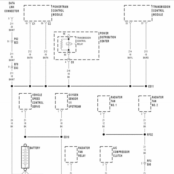

However, the wiring diagram seems to indicate that there is a direct ground from the PCM to battery negative, which has me a bit confused since the two connectors connecting directly to battery negative appear fine at first glance (The negative battery terminal has the main clamp, and also a little wire that connects to it, both are clean and have a solid connection to negative).
Try watching voltage at DLC pin #5 with your DMM connected to the B- *POST* while wiggling the negative cable end and the cable near the end crimp. KOEO, no scan tool connected. Turn the headlights on for some extra load. If the voltage starts fluctuating, you're in the right area.

There is a mention of engine splice 11 (ES11) grounding the PCM, but I can't find that splice connecting to the body of the car; from the diagram I just see it splicing to other components and grounding directly to the negative of the battery.
5 years 7 months ago #47266 by Matt T
bachi wrote: There is a mention of engine splice 11 (ES11) grounding the PCM, but I can't find that splice connecting to the body of the car; from the diagram I just see it splicing to other components and grounding directly to the negative of the battery.
It may connect to the engine rather than the body. And based on those voltage readings you just posted it sounds like you've got a bad engine ground. Repeat your voltage checks with the red lead on the engine and black on B- terminal.

I believe that's because you're increasing the electrical load, and thus the voltage drop. Here's the wiring diagram for anyone following along:

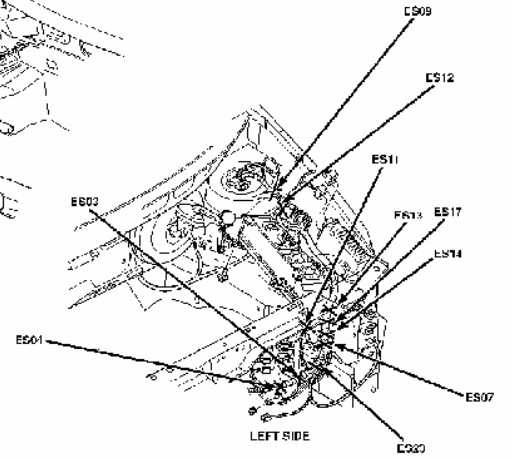

And this is what we get when trying to track down ES11:
'Bout as clear as mud. :silly: In my experience, splice packs rarely fail unless there's been a collision. I'd say you're voltage drop is most likely between ES11 and the battery.
That small cable at the B- cable end that you mentioned earlier? I bet that's the wire you're chasing. I know it's tight and looks clean, but that doesn't mean there can't be voltage drop taking place.

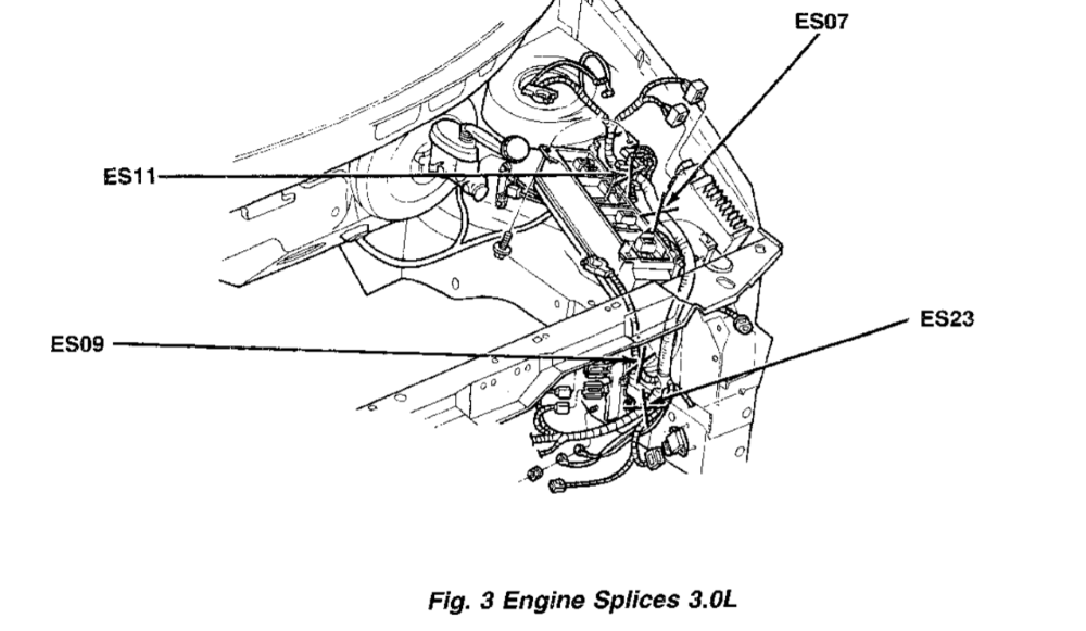

5 years 7 months ago #47271 by bachi
The wiring diagram is exactly the one I was using. The splice diagram in the same manual I'm looking at is oddly somewhat different:
Is there any way to tell which one is correct?

If it were my van, I'd be very tempted to run a new wire from as close to ES11 as I can reasonably get. :lol: But correctly, yes, you should track down ES11 and voltage drop further to track down the exact failure.
I love having the failure in my hand as much as the next tech. But it's Saturday and tracking down splice packs really sucks. :silly:
