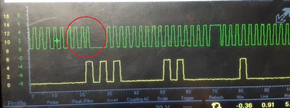

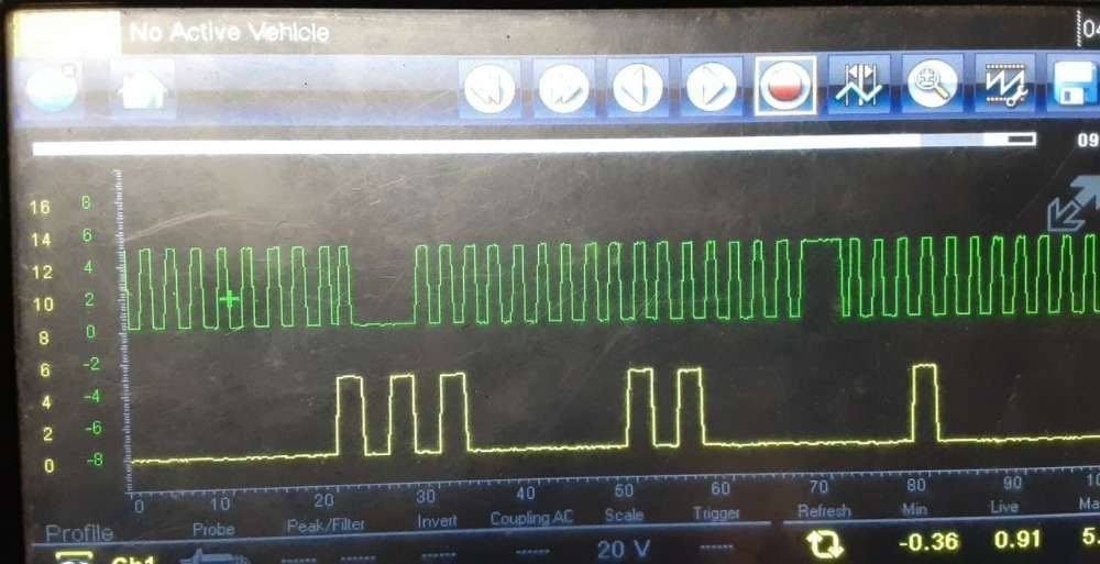

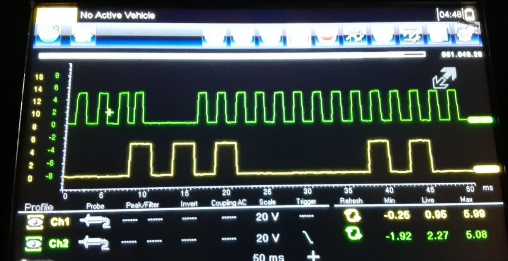

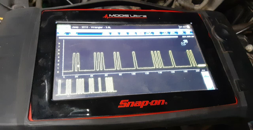

other shop installed reman engine, I dont know what company built it. . vehicle keeps throwing p0339 . here is what i have done so far, replaced after market sensor with mopar , CKP. tested wires from pcm to ckp. my 5 volt ref is good . my sensor ground is good ( and they are shared by other sensors) . wires to sensor ohm good, load test good , no short to ground or each other . also scoped crank and cam signals , look ok. I really an leaning towards wrong flexplate ? anyone, have any ideas what am I missing ? Thanks for reading

Does it set the P0339 immediately upon startup, or only after driving?
Any other codes along with the P0339?
Any chance you could scope the crank and cam together? So we can check the relationship.

no other codes, soon as you crank you get code . i will attach cam and crank scoping. i have to look pattern up, thanks

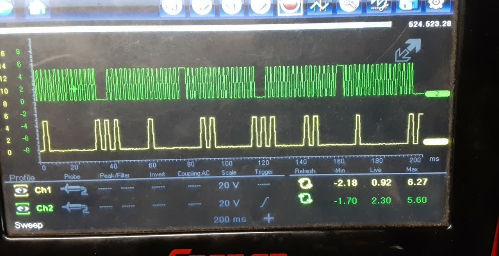

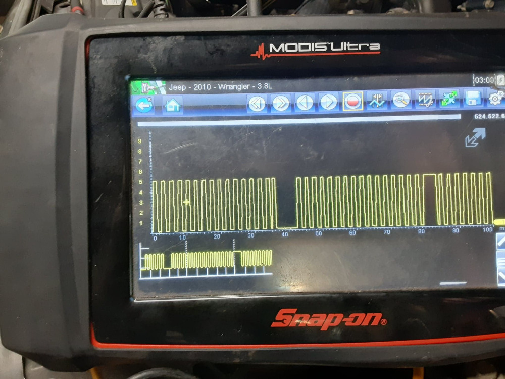

does anyone have a good waveform to compare to?

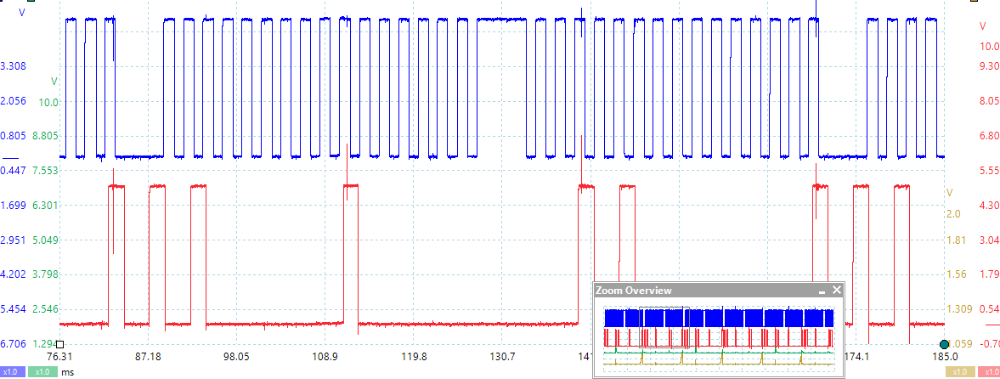

6 years 3 months ago #41497 by Tyler
Could you turn the time base down? So we can get more detail in the capture. 50ms or 100ms instead of 200ms.
I'm trying to see if the three-pulse in the CMP is lining up with the low part of the CKP correctly. Here's what I'm looking for:

6 years 3 months ago #41499 by ed2

is that the correct waveform for a 2010 jeep 3.8 ?
6 years 3 months ago #41501 by Tyler
It does. B) It sure looks like the CKP/CMP relationship is good to me. The sequence of the CMP seems correct, too.
I dunno if I'm nitpicking here? But something about this section bothers me:
In every capture, the low section of the tooth right before the sync notch is noticeably shorter than all others.

Tyler wrote: I dunno if I'm nitpicking here? But something about this section bothers me
That missing tooth part looks OK to me. It falls during the first CMP pulse and rises at about the time the 2nd CMP pulse falls.
What does look wrong is the wide CKP tooth. On the known good it's 3 regular teeth but on the OPs trace it's only two. And the known good has 16 regular teeth left of the big tooth and 15 to the right of it. The OPs has 16 to the right.

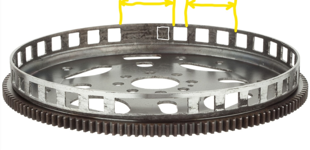

Holy crap Matt, you're right! :woohoo:
So the toothed section after the high sync pulse has an extra tooth. Now it should be easy to find the damage.
The one I posted was from a 2011 Heep Wrangler. I went and looked at a couple more for giggles, and found the same pattern.

6 years 3 months ago #41518 by Matt T
I suspect the flex plate has had an extra notch punched in it. This pic I found shows the high sync being 3 regular teeth wide just like the known good.
