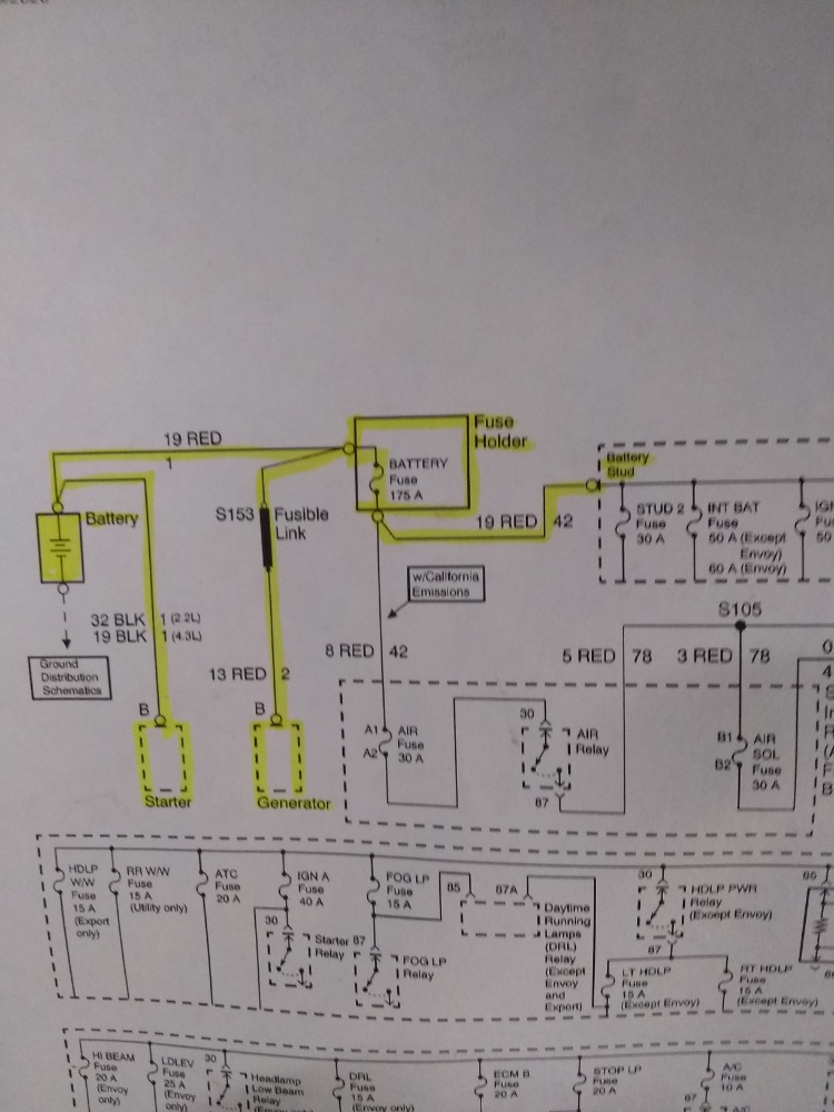

but I did cut out the battery cable, ( I had ran 0 gauge wire, I was going to run the battery in the truck bed but didn't, cause I ended up having enough room in the stock location).
SO I cut the wire out I had ran for the positive side of the battery, and hooked it back up to the battery, and everything cut back on.
so either one end of the cable was bad, or where I had ran the positive cable under the radiator core support, it was touching the metal.
I need to hook up the fusible link back up to the battery, so this wont happen again.
any advice on that. I have a spare fusible link box, and the stock one that was for the s10.
and btw, on a 4.8 liter gmc, for some reason they have a fusible link between the alternator and the battery. its in its own box, I'll post photos if the forum will allow it from my phone.
until I get a new cable, and the fusible link hooked up like its suppose to be, Im not going to try to start it. but with the key on everything is coming back on , like it was before.

So I can get the truck to run. But the battery light and dash lights will stay on. Even with the key out. I tried connecting the fusible link like the diagram. And the dash lights come on even with the key out. The battery light on the dash is on too. I just wonder since the positive cable was messed up. if the negative battery cable I had in there is messed up. and causing it not to be grounded. making the lights and battery light stay on. I can start the truck, turning the key over. but the lights stay on even with the key out. like I said.
Last edit: 6 years 4 months ago by NinetyNineChevy.
  • NinetyNineChevy
  • NinetyNineChevy's Avatar Topic Author
6 years 4 months ago #40774 by NinetyNineChevy
Replied by NinetyNineChevy on topic S10 LS V8 Swap
This is the diagram
