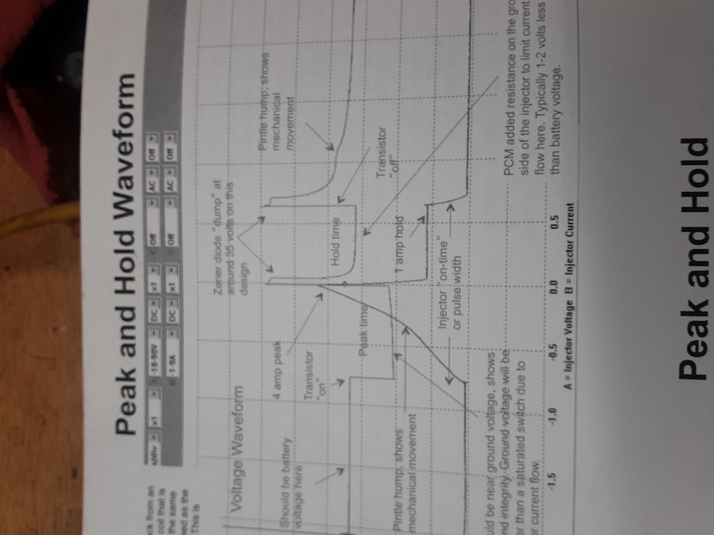

That looks kind of like a peak and hold injector waveform.
I don't remember how to access the e-book, so a picture of the hard copy will have to do:
Did you repeat that test on a cylinder that is not reporting misfires?
Yours looks like it's being pulled fully to ground for the second half of the pattern while the examine does not.

No I haven't run it on another cylinder yet. I will today and I'll post it. If it was this peak and hold type wouldn't it always do that rather than show up momentarily? Thanks for the pic.

All Data doesn't specify, but if the Snap On troubleshooter is to be believed, then it doesn't look like it would be a peak and hold type. It's not always correct though. I am curious to see how a non misfiring cylinder's injector behaves under the same conditions. It would be cool to see them both at the same time if you've got more than one channel
