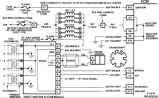

1993 Pontiac Grand Prix 3.1L. Will not start. Will run momentarily with starting fluid. Injectors ohm testing eventually drop to 12.3 ohms each. One had a possible shorted power wire to block. I'm getting 12V on control lead when injectors are pluged in. With all injectors disconnected no voltage or resistance on injector control connector leads, Just 12V on power lead.. As soon as I plug any injector in, I have 12 volts on power and control wires on injector connector leads.

In desperation I bought a new ECM. Still getting same results.

Your fine, I appreciate the help. I'm guessing at no pulse as it has 40 PSI on the fuel rail, it runs with starting fluid, so I figured it's not getting fuel from the injectors. I'm not 100% certain it is the version that does not have a cam sensor. I will have to check tomorrow. I do not have a noid light to verify no pulse on the injectors, A week ago I replaced the plugs and plug wires, and it started running again. Seemed fine other than a very slight rough idle. If it is the version that does not have the cam sensor, I'm wandering if the crank sensor controls both spark and fuel injector pulse.

It looks like the two versions of this engine are Federal Emissions, which has Multi port fuel injection (i think this is the bank fired system)
and California emissions, which has the Sequential injection.
It will say which version on a sticker affixed under the hood, on the radiator support, or possibly even on a strut tower.
It should say something to the effect of "this vehicle conforms to { U.S. EPA regulations} or {California emission standards} in effect for model year production.

9 years 11 months ago - 9 years 11 months ago #3830 by Noah
The US EPA Federal model does not have a Cam Position Sensor, and is the bank fired system.
Ok, so I've been checking out what the ESC function is. It seems like it is only part of the knock sensor circuit. The ESC, (which only seems to be designated as such on the California emissions model), is integrated into the PROM portion of the PCM. Those must be the screws you're having a hard time with.
The PCM supplies 5v, which is pulled down by the knock sensor circuitry to around 2.5v.
The knock sensor creates an AC voltage which rides over that 2.5v, which is interpreted by the PCM to retard ignition timing in increments of 10 degrees depending on the severity of the knock.
It's doubtful that the ESC would would have any effect on injector pulse. I don't think that even if this 5v supply was shorted to ground it would cause anything more than a CEL, since the circuit is designed to be pulled (partially) to ground. Almost like a thermistor circuit.
I noticed that you have checked for injector pulse with a noid light, which is a valid test, and in fact how the service information would have you check it. The only issue I have with a noid light is that in only proves the injector isn't being controlled. It doesn't let you know where the problem is, on the power side or the control side.
You mentioned that you bypassed the fuse to the injector power supply because either the fuse was melted or the female pins were melted? I agree that that is most likely due to the short to ground you discovered. Thankfully, a short to ground on the power supply to the injectors most likely wouldn't have harmed the PCM. It also appears that, at least depending on where you have the wire bypassed, it should be only the power lead to the injectors and nothing else.
A voltage drop in this leg of the circuit would mean that the injectors aren't getting power under load, which would result in no activity from the noid light. Ideally you would want to check voltage here (at the positive lead to any injector), with a voltmeter and the injector connected while cranking the engine.
You could also load the circuit with a light bulb if that's easier. Key on engine off, connect one lead of the bulb to the injector power wire and the other lead of the bulb to ground, (injector disconnected). A good bright light would prove the power feed to the injectors is not dropping out under the demand of the injectors.
As far as inputs, the PCM checks the Engine Coolant Temperature (ECT) sensor, the Throttle Position Sensor (TPS) and the Crank Position Sensor (CKP), to determine injector pulse width.
If the pcm sees the TPS at >65%, it will cut injector pulse. This is clear flood mode. Paul has mentioned this in many videos.
This sensor and related circuitry (including possibly the PCM) could potentially cause the symptoms you describe.
It would be worth it to check for at minimum a 5v supply to the TPS. One of the 3 wires should be 5v, key on engine off. One should be ground, and the last wire (the signal wire) should be low with the throttle closed (probably less than 0.5v) and high with the throttle wide open (4v or more) if you've got higher than normal voltage on the signal wire with the throttle closed (say 3volts or more guesstimate) the PCM will interpret this as Clear Flood Mode and cut the injector pulse.
Also, if you don't have the 5v supply to the TPS, it could be shorted to ground pulling the whole 5v ref down causing your no start.
While an erroneous input from the ECT could cause a no start, it would most likely not entirely cut injector pulse. You'd probably end up with excessive fuel and fouled plugs
A faulty CKP sensor (and circuitry) would result in a no spark scenario.
Another fault I could imagine based on this system diagram could be the external PCM grounds dedicated to the injector drivers, or a PCM connector fault at D4 and D10. It looks like that would be ground G104. G104 is bolted to the transmission bellhousing directly opposite the starter solenoid.
So, there's some stuff to digest. If I think of anything or find anything else out, I'll post it up for you.
There may be some stuff I didn't think of.

9 years 10 months ago #3884 by Chriscoy
Replied by Chriscoy on topic 1993 3.1L Injector shorts or shorted ECM?
I'd go check out Pauls video on GM bypass ignition systems. I think you're on the right track looking at the ignition module.
Paul does a great job covering this topic that can be very daunting for a little bit but once you understand it, it's easy.
Hope this link works.
Changing parts is easy, Troubleshooting is an art
The following user(s) said Thank You: ScannerDanner, Noah
9 years 10 months ago - 9 years 10 months ago #3888 by Noah
Thanks for posting that video Chris!
I wasn't recognizing the ignition control module as being in control of the injectors too. I hadn't even considered the ICM. It sure jumped to the top of the suspects list for me.
I was looking at it as the ECM in control of the injectors based on CKP input. Very glad you came in on this one.

A wealth of information here gentlemen. Thank you. I had the rusted screws removed and have all coil packs of the ICM/ESC, after I removed the whole assembly from the engine. As soon as I can get the chance I will take it to the parts guys and get it tested. I'm having to get rides, so my access going places is limited. I'll post my findings when I get them. Thank you again for all of the crucial information I was needing.

9 years 10 months ago #3893 by ScannerDanner
Replied by ScannerDanner on topic 1993 3.1L Injector shorts or shorted ECM?
Jumping in late here. Thanks guys! Great job.
You don't need to have the module tested. With the key on, take a test light to battery positive and touch on and off the purple white wire coming from the module. This the the rpm signal to the ecm. The ecm should react by running the fuel pump and firing the injectors each time.
An alternative test. During cranking there should be a 0/5v on off signal on this same purple white wire. Using a voltmeter will give you an average voltage. Can you give us a voltage reading on this wire?

I had already pulled the Ignition Control Module. Took it to the parts store and it failed remarkably. I had been going on the notion if I had spark it was good. Now to find the input that the Knock sensor ties into so that I can get it back in the circuit. I am also having troublr finding the torque specs on the plenum bolts. Been seeing 18 ftlbs., but that seems a lil much. I can't thank your team enough for all the input. It helped me not waste money throwing it at the wrong parts. While I have your attention, I have a 2003 PT Cruiser GT Turbo that I couldn't stop where I was and over heated the engine so bad (no water) it shut down. I tested for compression and there isn't much, and when I crank it she sounds a lil tight. Do you think the engine is worth putting new rings and bearings, or is it toast? Thank you again for all the help.

Norman, reading the last comment you posted it sounds like the ICM was the culprit. Is this a fix? Just curious. As far as intake bolt torque, that sounds about right.

Yes, the ICM was the culprit. Running fine now. Thank you all for the input. I will recheck my torque on those when I have a better torque wrench. I have a new one I bought from a discount tool supplier that I am cautious about. It never clicked at 18 ft lbs, so I stopped when it felt they were getting very snug. Thank you again for all the input. I'm sure I will be back to this site often. You guys are awesome!
