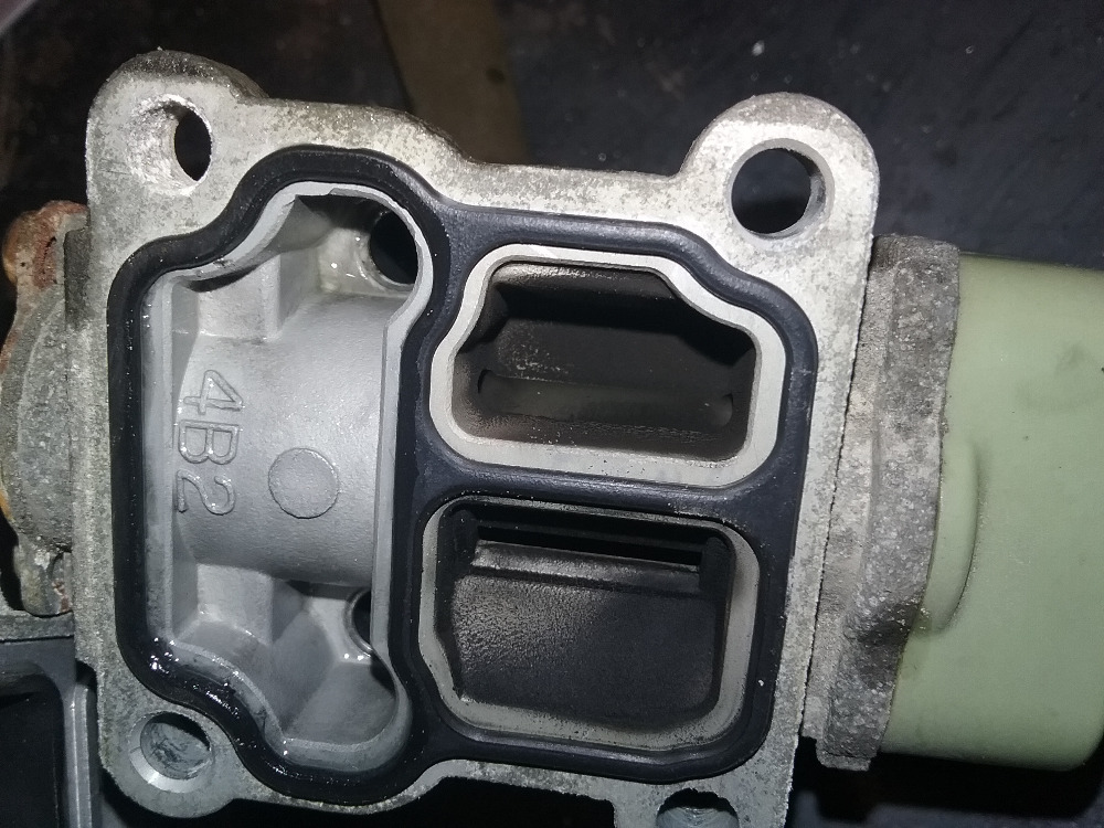

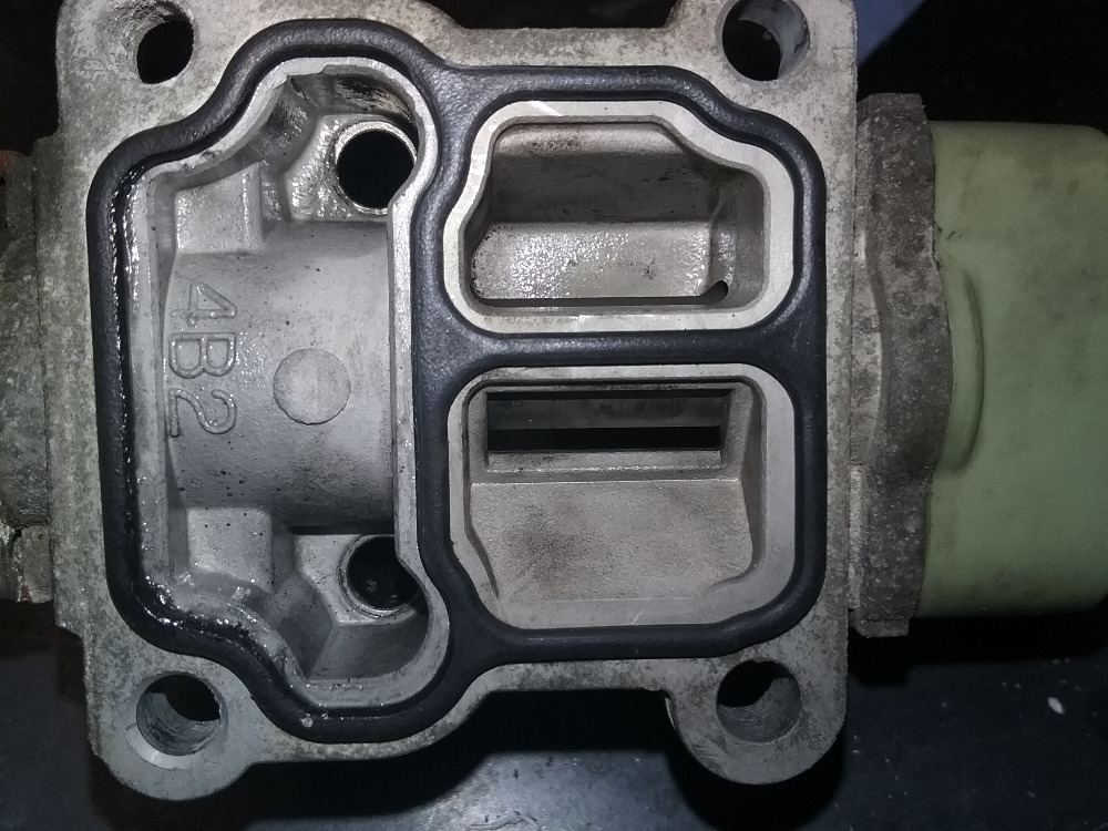

7 years 2 months ago #26530 by samsepi0l
I pulled the IAC off and it didn't look that bad....
I cleaned it out anyway.
